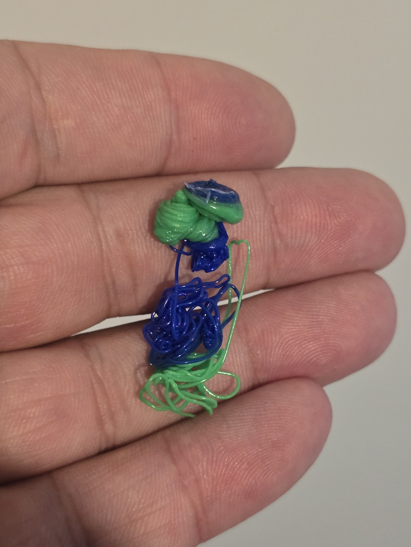

Previously my poops have been long and curly and kind of spiral up into a tube but now there coming out all squiggly and erratic and causing my chute to get clogged.
I’ve been trying to do a long 4 colour print (2 days and 5 hours) and my chute just keeps backing up, until the print head hits it causing it to become misaligned and ruining my print. This has happened several times now and I can’t work out how to fix it.
As I say, previously my poops coiled up in a nice looking tube which slid down the chute without incident however now things have got a lot more erratic:

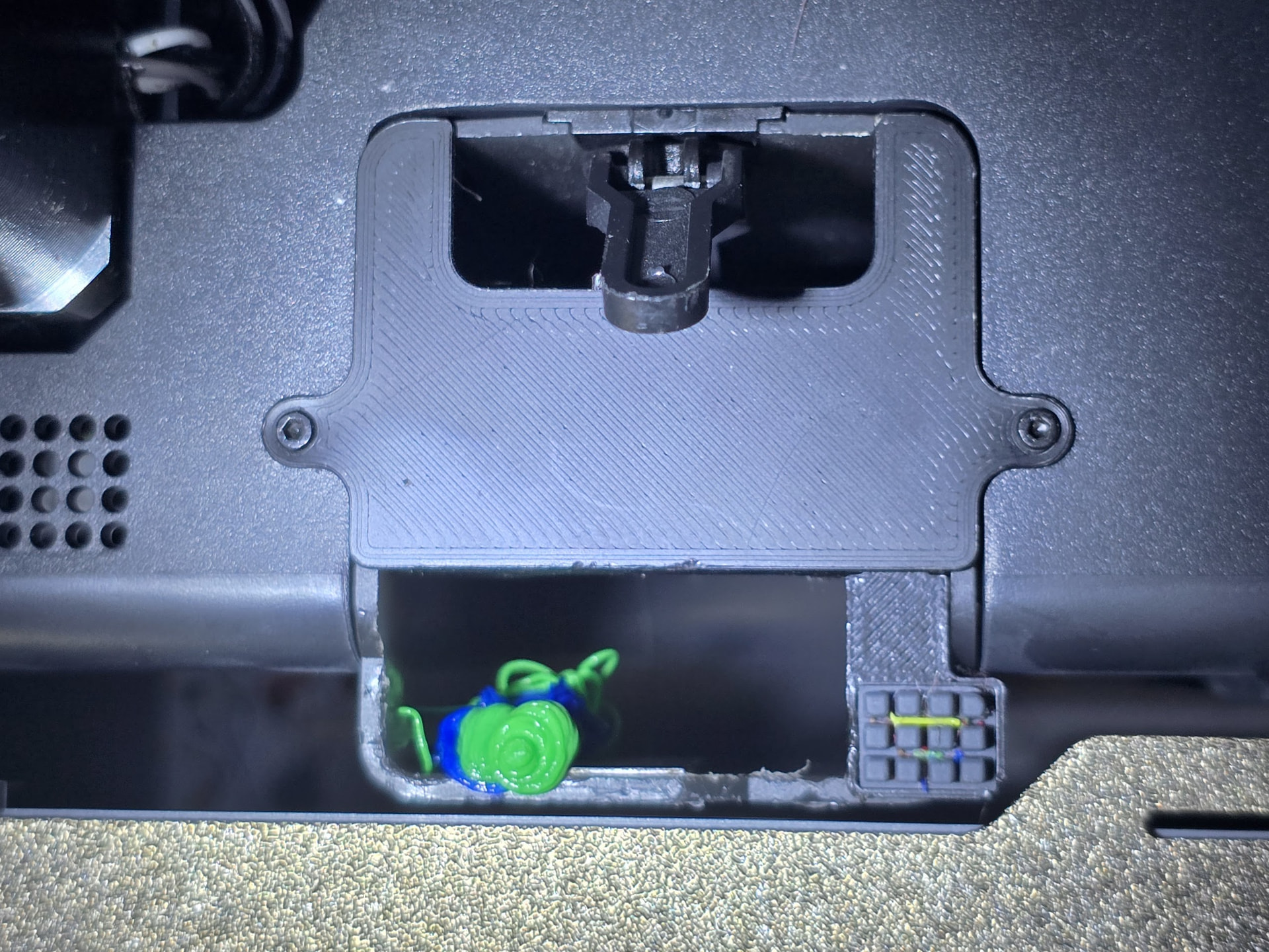

The issue is that these “erratic poops” have a tendency to cling to the side of the chute causing the build up:

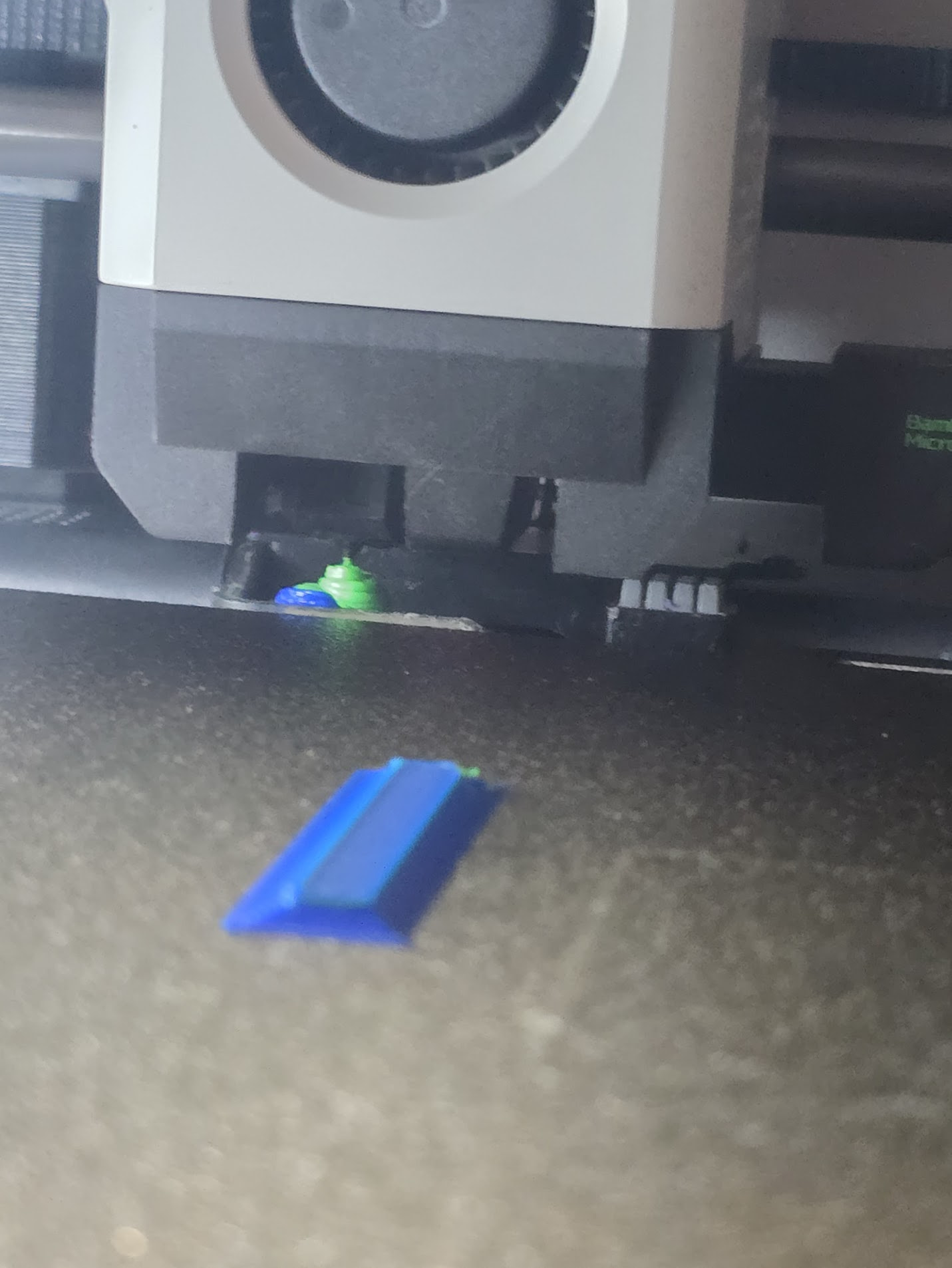

This then builds up which eventually causes the failure:
Often, even these larger blockages eventually work their way free, but not always:
Note the flap in the chute works fine, and generally speaking the wiper I have installed does it’s job. This issue is simply with the poops just not dropping down as they should.

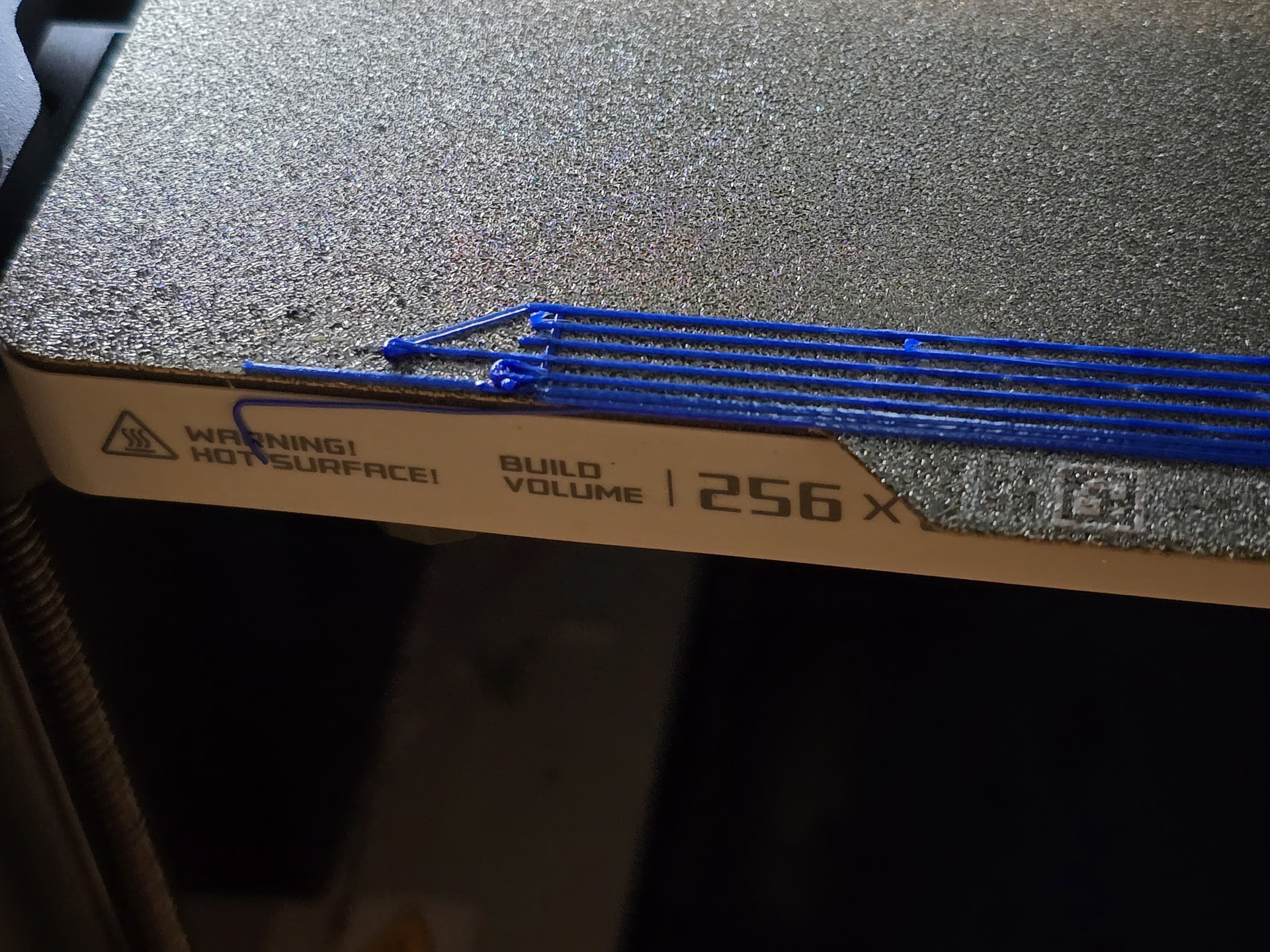

One thing I am noticing though is that the flow/calibration lines do seem very close to the front edge of the build plate:
And that part of the first line has actually fallen off the front:
And it seems that when the poop gets caught in the chute it actually gets hung up on the front edge of that chute. Is it possible that my print head has somehow moved forwards a little? I can’t imagine how that would happen but it might explain it: :man_shrugging:
Just out of curiosity, When the nozzle excretes down the chute is it meant to be positioned “over the middle of the bowl” as it were, because you can see in my photos posted above my printer is basically “sitting on the rim”: :sweat_smile:

The location of the calibration lines seems to indicate the hot end is slightly bent. I am assuming the buld plate is located correctly on the print bed. Try a different one

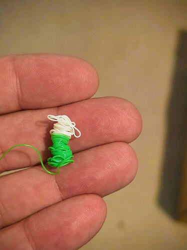

Well, I pulled the hotend out and sure enough there was a slight but noticeable kink in the shaft. Fortunately I was able to bend it back to straight just using my hands and after putting it back together check out this ripper of a nugget:
