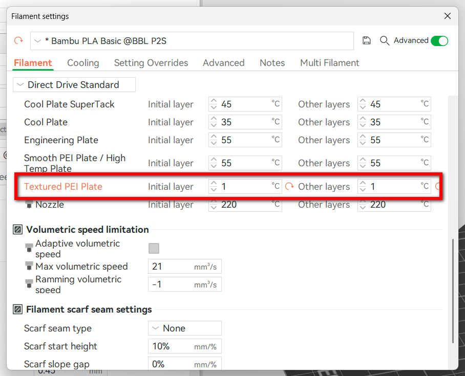

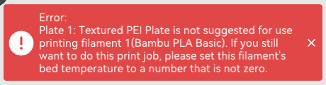

First of all it says to set the temperature to 0°C, while that is not even possible because if you try to that the slicer will show the following error:
Secondly the slicer takes in two values for the plate temperature, one for the first layer and one for the rest of the print. The instructions don’t specify which one to set.
Thirdly it doesn’t say anything about how to set up the slicer profile for the plate, you need to find that out on your own after some trial and error or by asking around in forums.

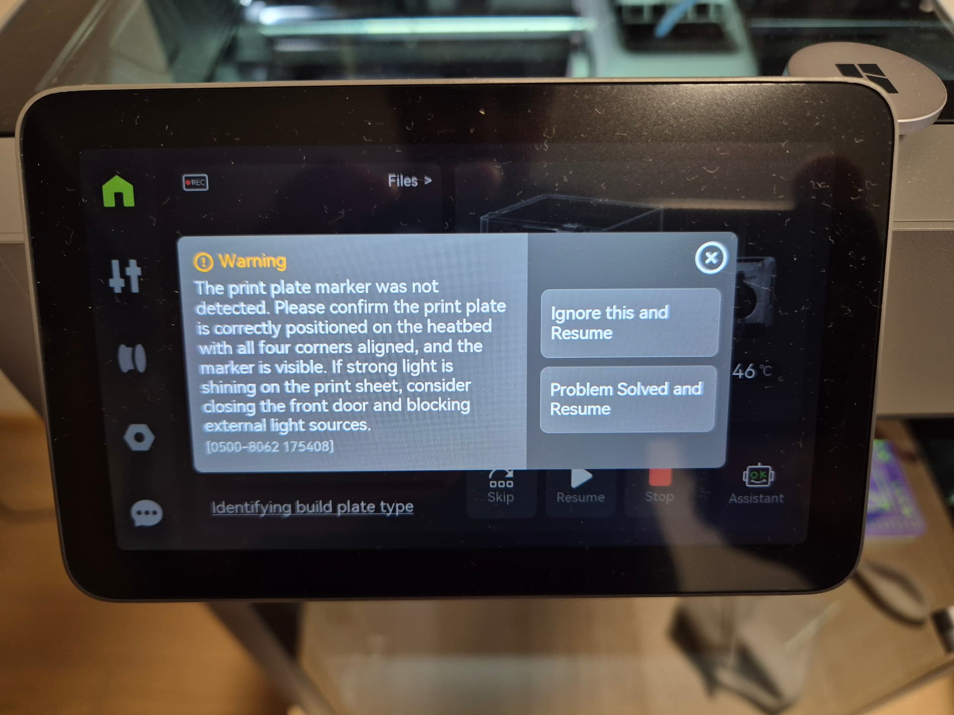

After you figure all that out you can finally start printing, but then you get the following warning from the printer:

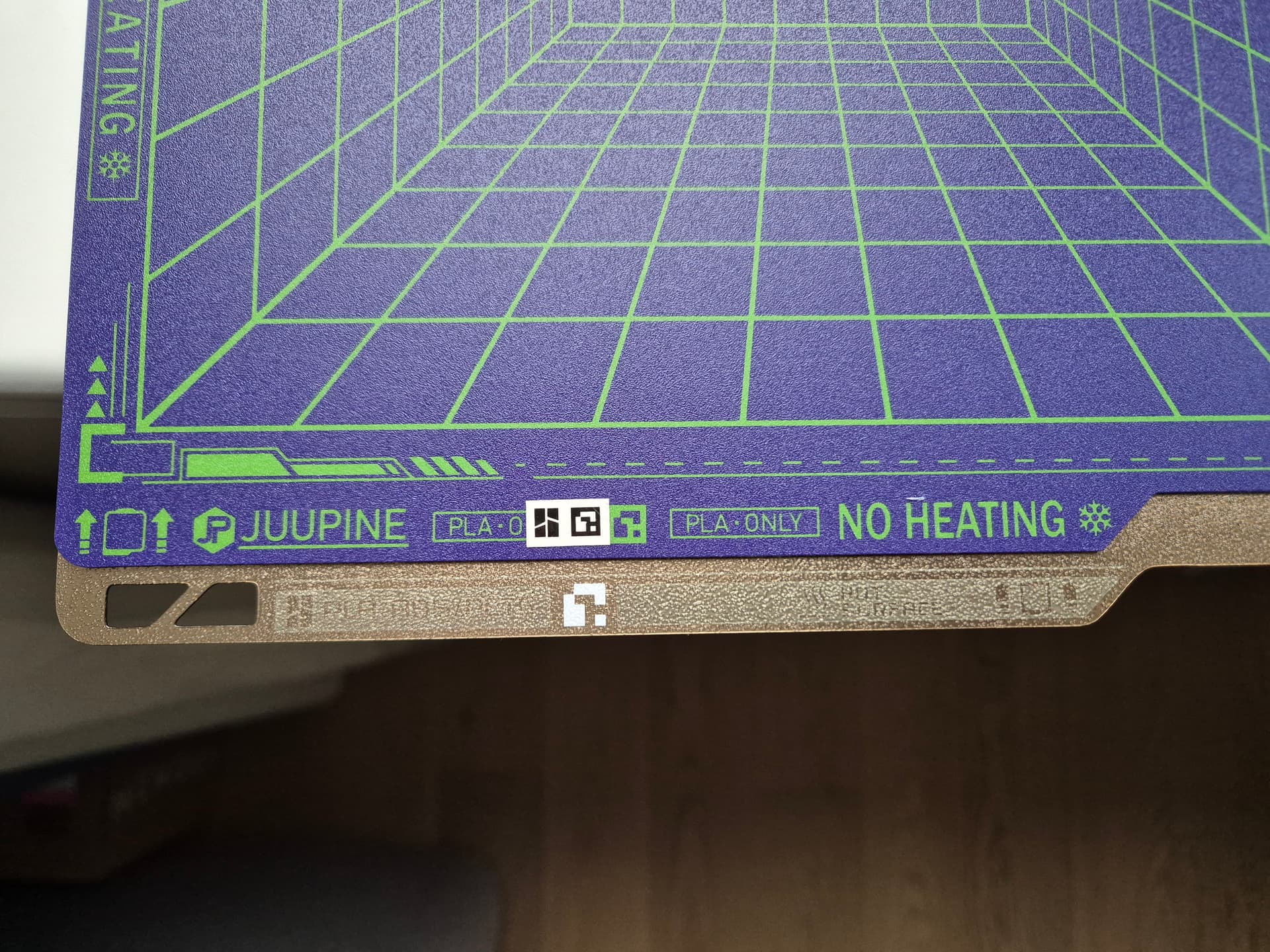

At this point you understand what maybe the stickers that come with the plate are for, even though that is not mentioned anywhere in the instructions. So you put the sticker on the plate and try to print again, but then you still get the same warning. Then you notice that the position of the sticker is not exactly where the QR code is on Bambu Lab Textured PEI plate:
so you move the sticker to match the QR code position and try again, but still get the same warning. At this point you just give up and accept that the printer will keep showing that warning for every print and you will have to manually dismiss it each time. I don’t want to disable the plate detection completely because that has proven to be useful in the past to avoid printing on wrong plates.

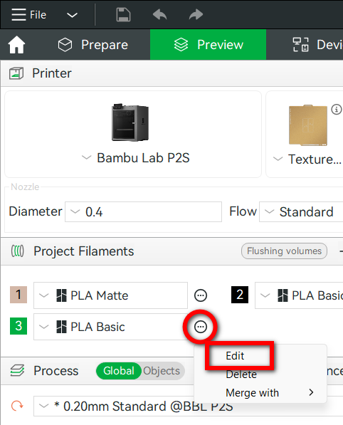

So these are my instructions (based on my understanding, any feedback is more than welcome) to use the JUUPINE GECO plate in Bambu Studio:

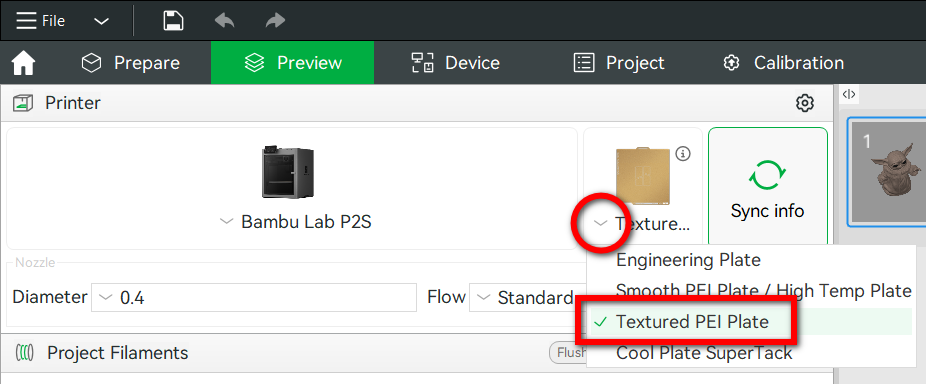

  1. Printer: select Textured PEI Plate as the global build plate from the dropdown menu.
  1. Project filaments: click on the triple dot menu next to the filament you are using and select Edit.
  1. Filament settings dialog: set the Initial layer and the Other layers temperature to 1°C
  1. Filament settings dialog: click on the saving icon and prefix the profile name with GECO to remember that this profile is for GECO plate.
  1. Repeat steps 2 to 4 for all the other PLA filaments (e.g. Matte) you plan to use with the GECO plate.

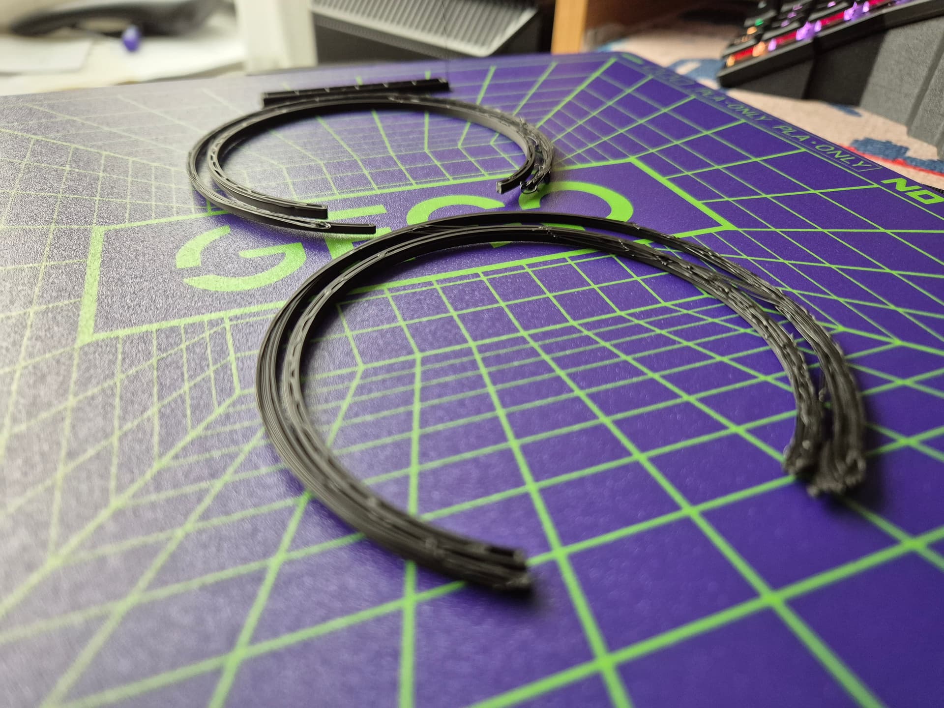

Depending on the shape and position of the parts you can get failed prints from time to time, for example the following rings did not adhere well to the plate (I had previously cleaned the surface with isopropyl alcohol):
Another part I printed had defects because it was located near one of the corners of the plate.
