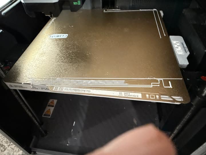

My X1E is slamming in to the corners and the calibration layer is off
I’m having a problem all of the sudden with my X1E printer. As you can see in the picture below the flow calibration is crooked. Before it gets to that it seems to to be crash into the corners while doing the bed leveling. I’ve tried the following, calibration, belt tightening, cleaned carbon rods, calibration again, changed object to print, turned the printer on and off a few times. Did a factory reset. Nothing has helped. Yes, I do have the correct printer in the settings. Hopefully someone has the knowledge to help me. TIA.
That looks as if the frame is twisted.
What happens if you remove the lid and look at how the X & Y runners appear?
Take a photo and share.
