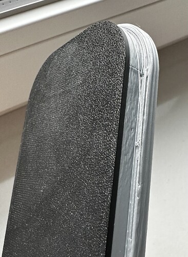

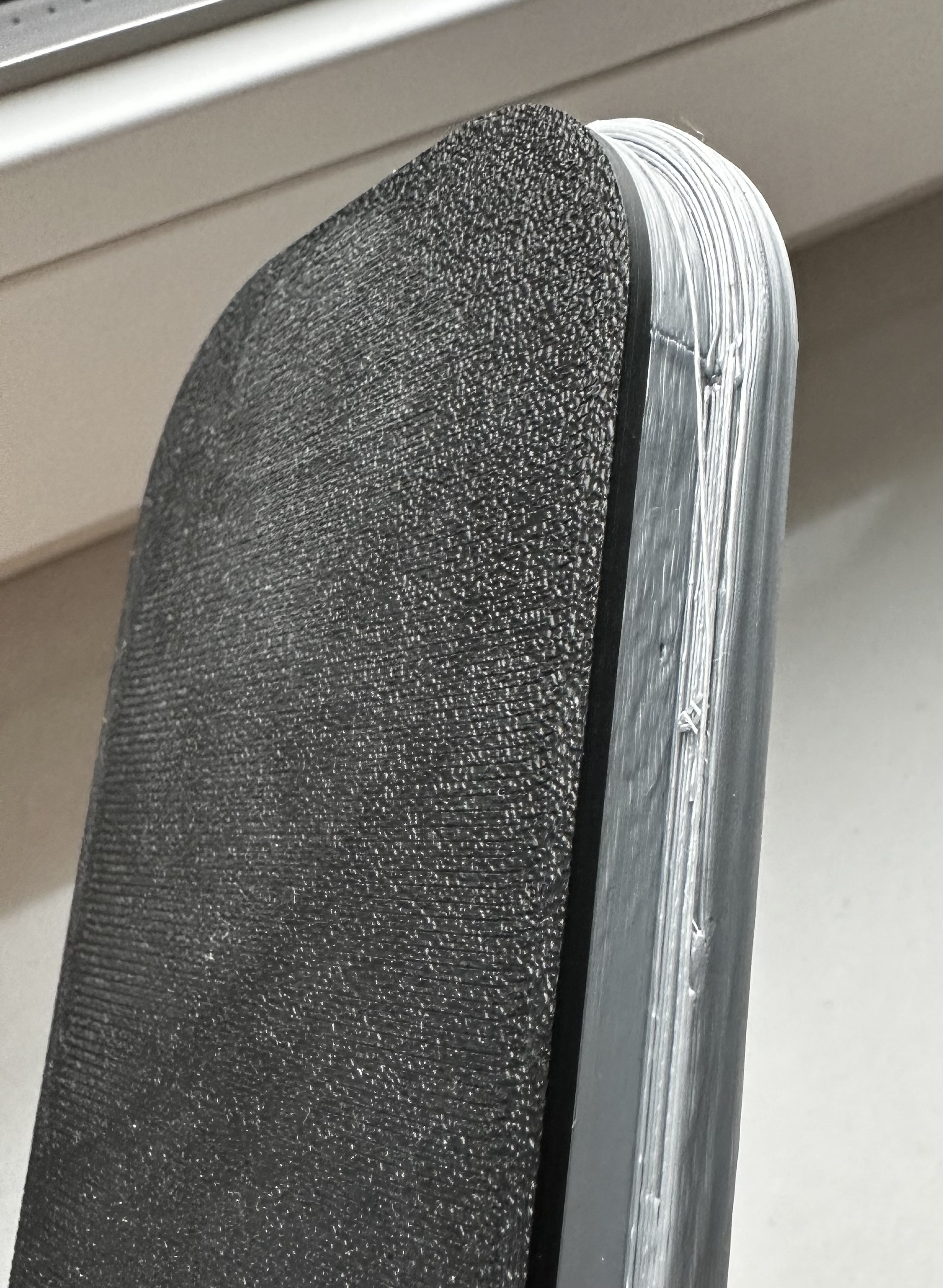

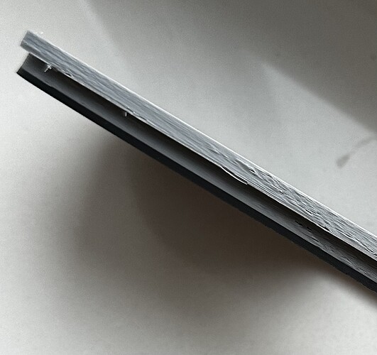

Then I wanted to print plate 3 and midway through, one of the edges started warping and lifting off the build plate with spaghettis. This was on the upper left corner of the build plate. I thought it was due to finger prints on the edge of the plate. So I washed the plate with hot water and soap and tried again… same problem. This was with the Bambu smooth pei plate. Third time with structured pei plate same problem.

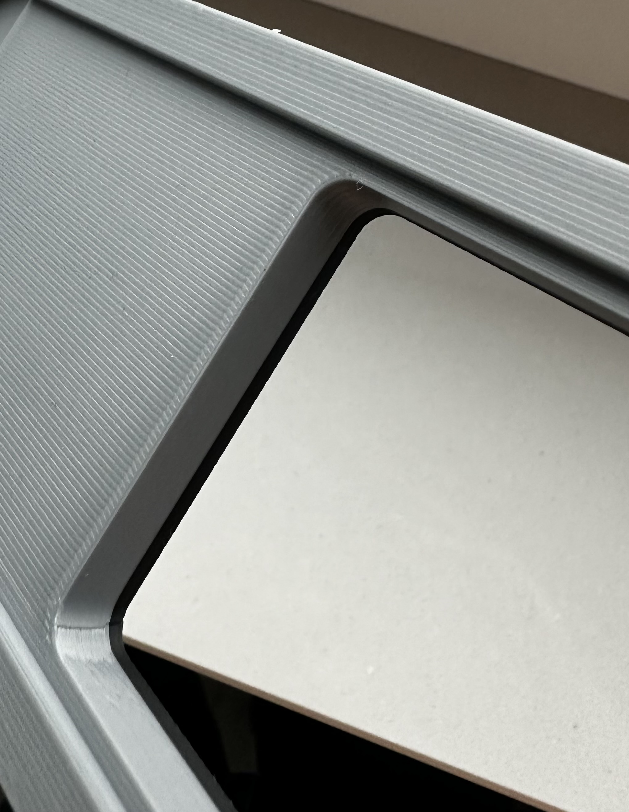

I then moved on and tried plate 4, which has a bigger contact area with the plate, again using the structured pei plate. The print stuck to the bed but the outer walls are not very nice.

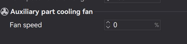

Try disabling the Aux fan that is on in nearly every filament default. It blows from the left and sucks in air from the lower part of chamber that may be too cold. Its enough to cool down the print too much on the left side causing early release from the plate. if that doesn’t work wash your plate, if that still doesn’t work and your printer is new you could have a cold spot in the corner of your plate like mine and you may need to think about ordering a new hot plate from a support ticket.

Thanks for the reply! I will be also trying this once I get home.
In the pictures I provided the bigger part didn’t lift but the print quality was very bad. Could this also come from the aux fan?
It is indeed very possible that the aux fan on the left side was blowing hard enough to cool the PLA too much before proper interlayer adhesion could happen especially if you see the problem more on the overhang area which is going to be more sensitive to both overcooling and overheating as well, so it could be a couple different things regarding print quality itself.
