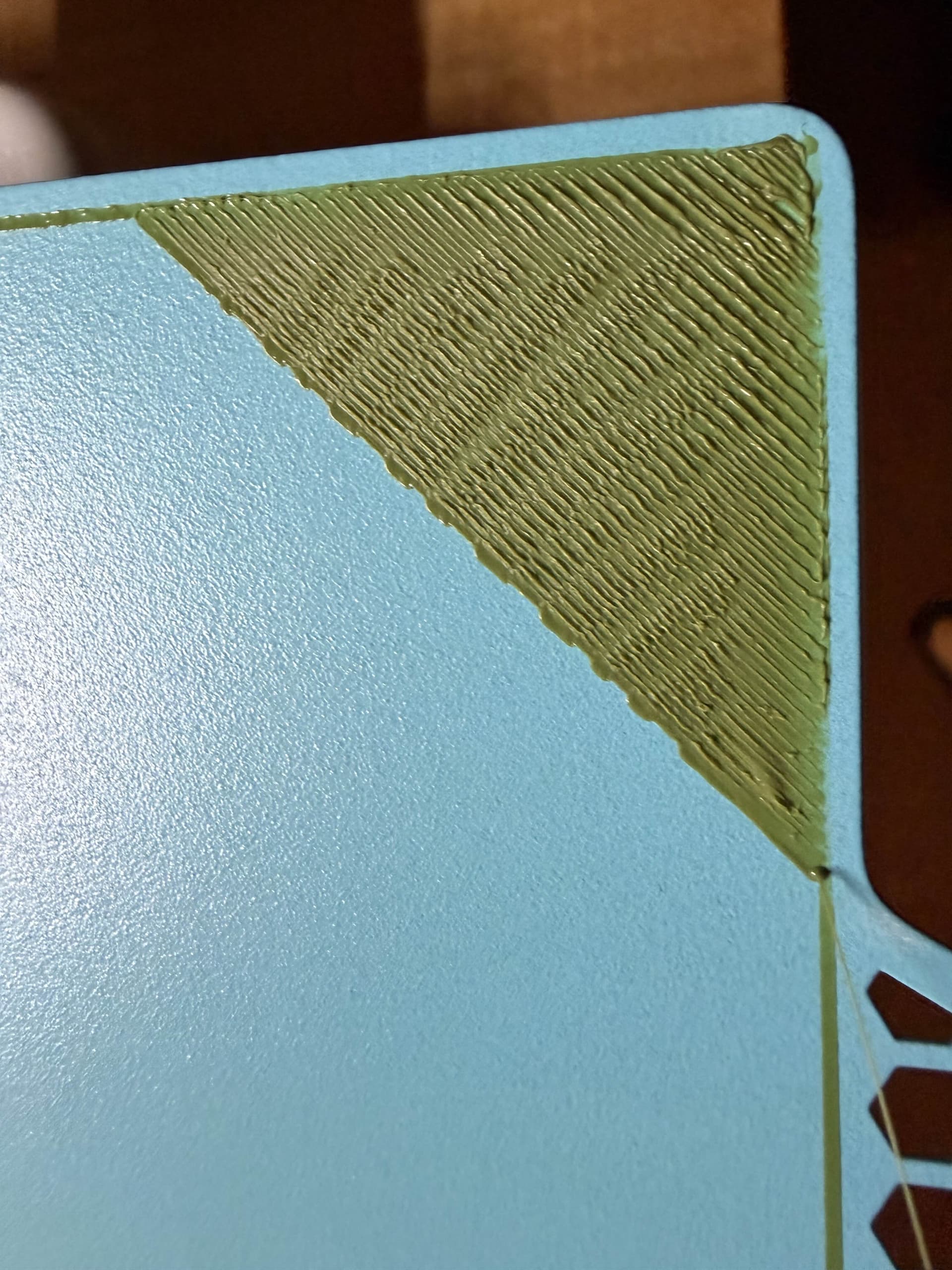

Need help with first layer, been trying for a month
I have been trying to trouble shoot this issue for over a month, I have read other posts, watched youtube tuts, facebook groups, chatgpt…

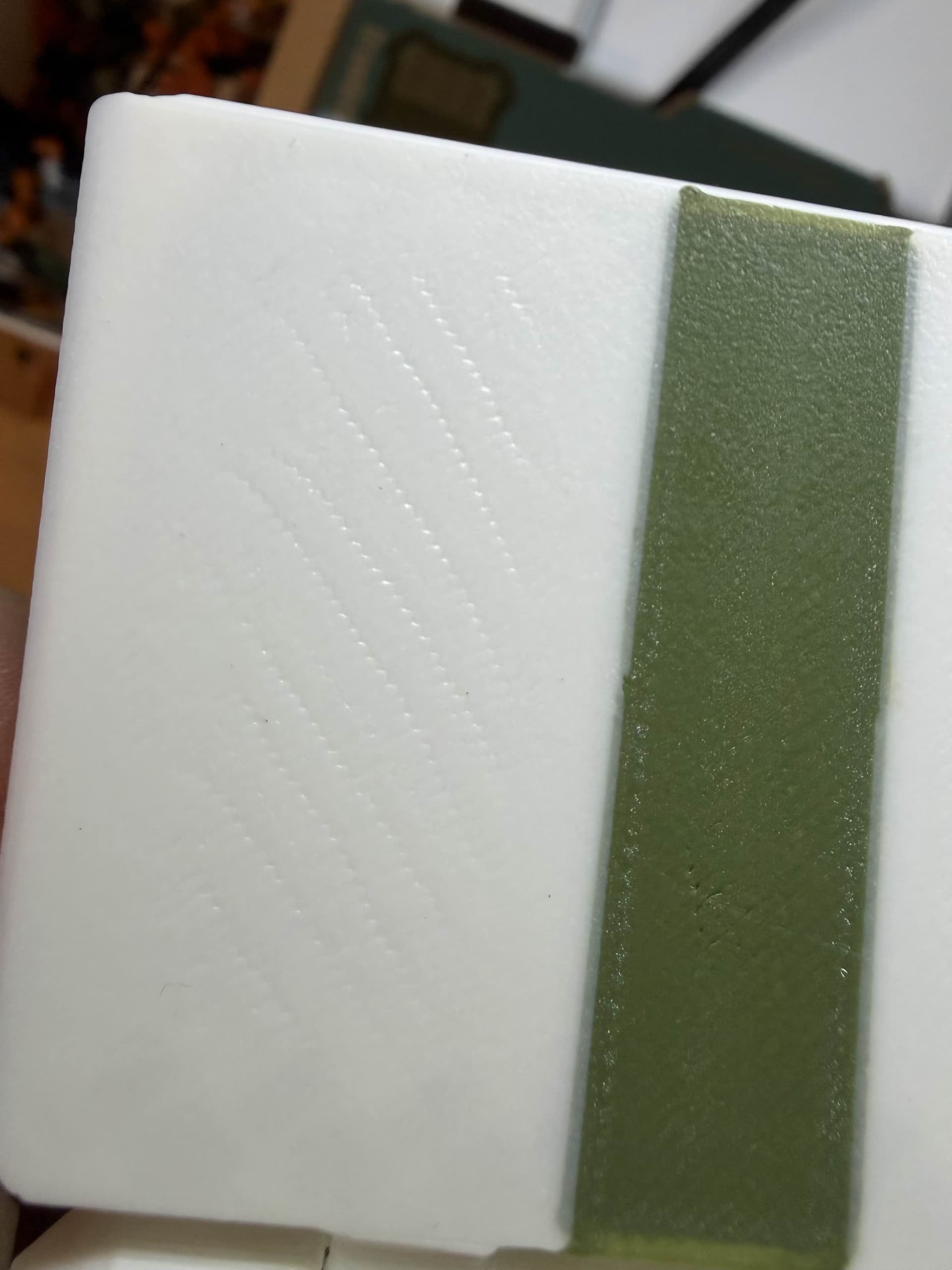

My first layer is horrible. The first layer leaves lines on the bottom surface the rest of the print is generally fine. I have raised z axis by 0.01, i have changed flow rates, infill, temp, dried my filament, retightened the screws on the hotend and i cannot figure this out.
This was not a problem up until a month ago, I am using PLA filament
I am just looking to be pointed in a direction of the possible fix

you probably messed with filament’s settings and that seems over extrusion…
everything was default until this happened, flow rate is default ‘1’ and ive gone down to .90 and still get this. the flow rate in these pics is .95

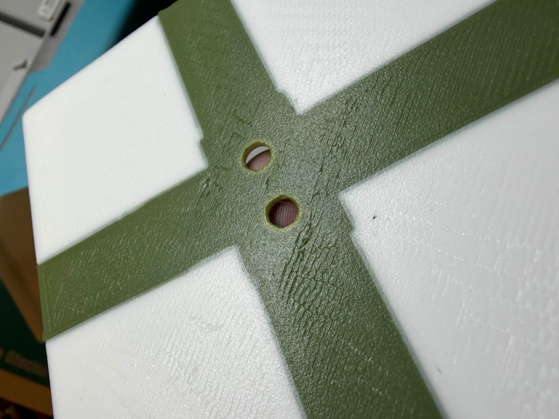

This is something I have been dealing with for a long time. But since I print on textured plates you really have to examine the part to see the problem. I am following in hopes that there will be a solution that I can use.
For info, I really don’t have any. Prints straight out of sealed bags or dried in one my dryers doesn’t matter. I will say I notice the issue a bit more on PLA CF vs PLA.
Generally speaking I use default settings and let the machine do its thing. I have tried doing flow calibrations, but it didn’t help.
This does seem to affect 2 of my machines more than others.

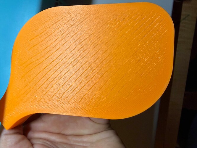

I have been trying to do this large ISH flat print, but the first layer has not been printing well and I don’t know if it is an issue with the filament or maybe it’s not sticking
