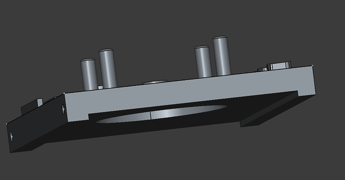

I need some help. I’ve designed the above model in FreeCad and am having issues printing it using PLA on a P1S. I’ve made a 2 mm recess into the bottom of the base as this is going to sit over a circuit board in a computer. I need some advise for supporting the overhang while its printing. I’ve tried tree and normal support types but the result is a very rough surface. Is there another way to do this? I’ve also tried using another filament (PETG-HF) as a support filament but that turned out worse of the three attempts I’ve tried. I’m not sure what to try next, would the support for PLA filament be of any use in this scenario I still have the sample that came with the printer.

I am assuming it is printed in the same orientation shown - left and right “feet” contacting the bed with the square raised, and a hole thru it
This is a good candidate for dedicated support material and a 0 gap if you have an AMS. If not…
I would use “Normal” aka not tree support. It’s best for wide flat ranges. With only 2mm you may need to verify there is enough room for it to generate this support structure but I would use this:
a) slight reduction of top gap means less drooping but a little more bonding to support, itll be ok on this shape, you can pry it off easy
b) More interface layers makes the interface more solid - so when you are ripping it off, it all STAYS together because it is a big chunk and is very well bonded, lets you pry and lever it off easily.
c) interface spacing of 0 makes it so the top surface of your interface looks like a top surface of a print - fully flat. It also helps solidify that interface.

that is totally doable and with a decent bottom. I strongly suggest to use PLA support filament. yes PET works but final result is superior with PLA support, comes away like nothing.
Support settings are prompted automatically as soon you set “PLA support” as you default interface filament.
