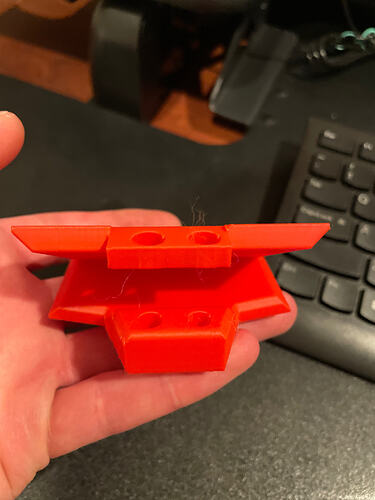

Teacher Appreciation Week in America starts soon… I have an idea for it, but I want your input. It is a sticky note holder that will have a customizable name/ logo plate on the front. Near the logo holder, there will be a slot for two writing utensils. They will drop down into a receiving tray below. Any thoughts on this… or other items teachers might like? I have a little over a week to print over 100 of them.
I’ve also been thinking about adding a TPU base. Do you think that would help it stay stationary while I am writing?

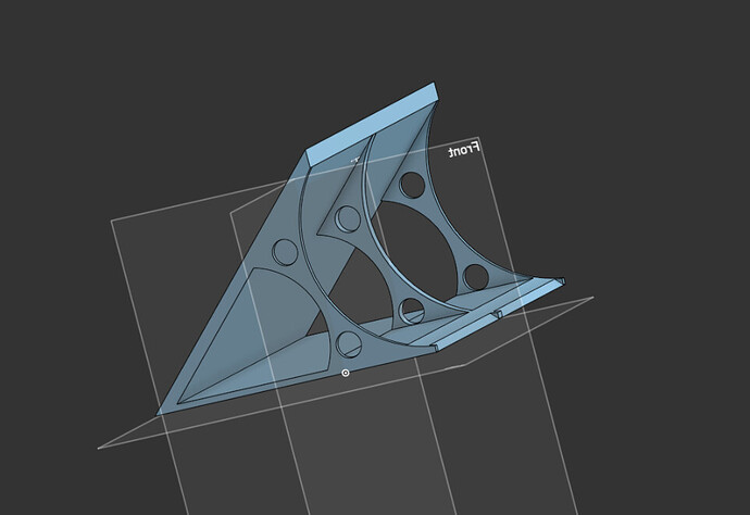

Also, the middle of that deep V cut in the middle is a natural break point regardless of how you print it. You’ll want to build supports inside it to give it strength. The supports can be decretive, but they’ll need to be at least 1.2 mm to 2 mm thick. Give me a minute and I’ll show you a quick image of what I’m talking about.
TPU is good, but this sort of non slip furniture pad that has tape on one end is also pretty awesome
I dont have a good one to recommend but the tape/glue quality should be assumed to be bad, and it helps to model a valley for it to sit in.
Here you go. something like that.
That looks pretty cool! I will say that I was going to add a circle where the triangle comes together, but after printing, the structure is plenty solid enough to endure someone writing on it.

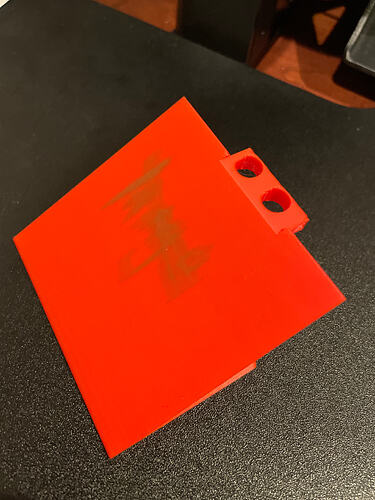

I’ve found TPU needs a certain amount of weight/gravity into it before it really holds well as a nonskid pad, and you might want to design a test to make sure the ~1oz of a stickynote pad gets you there. It’s probably ok writing on it, force transmit down, but plucking from it might be skiddy
I think you guys are right. I have made a few modifications to it based on the feedback I have received here. First, I am making it into a wedge shape, which will make the structure stronger. I am lowering the writing angle to be easier on the wrist… this also brings the center of gravity down to help the TPU grip better.
