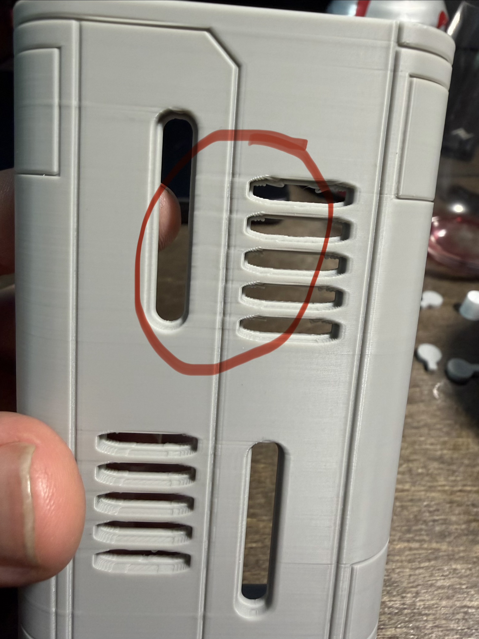

Hi friends. I’m very new to printing and I’ve been chasing an issue I’m wondering if anyone can offer me some insight on. I recently got a Bambu X2D and I’m having consistent issues with surface quality on a part I’m trying to print. It’s been hard for me to chase down what exactly is happening here, but from the research I’ve done I think it’s a shrinking problem?
It seems to only really happen on layers with those hole features or where there’s a support interface on the rear of the object.

Very unlikely this is a shrinking problem.
It looks to me like the rapid start stop to do those narrow sections aren’t getting enough time to build proper nozzle pressure, so it’s getting under-extruded.
Have you done a pressure advance calibration?
Could be cooling. Set the view to show layer time, and see if you can see where it matches up with the horizontal lines on the print. In that case, adjust the minimum layer time so that the ffilament is heated and cooled more evenly.

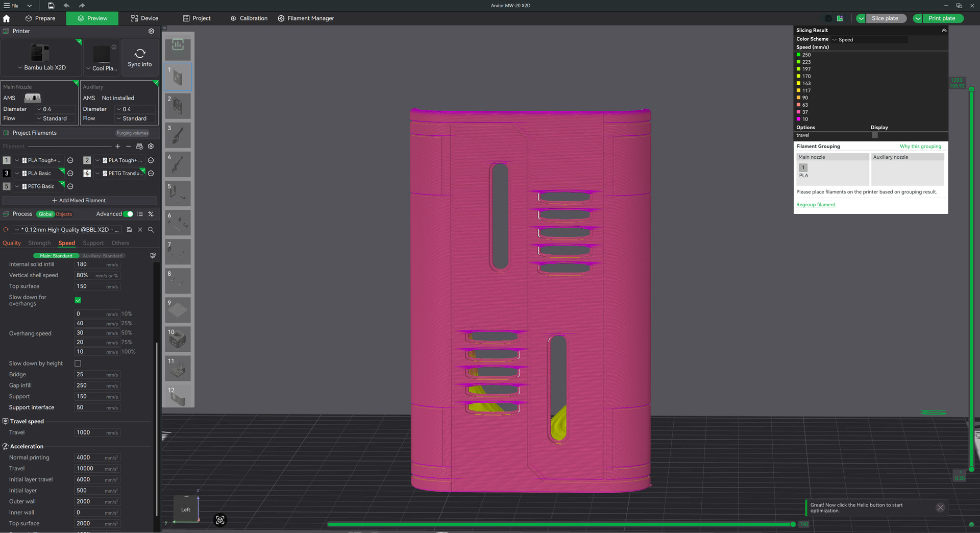

I would suggest going to the slicer and looking at the previews (layer time, fan, line width, etc.) and see if there are any previews that show an identical artifact area. Odds are if one does, it is likely the best place to start looking for a problem.
For example if the layer time preview shows color changes in the same place as the issues on the print, I would try to even out the layer times with the cooling max layer thresholds section in the filament profile.
So, just scroll though the previews and see if something stands out or looks related to the problem areas.
Yeah I think you guys are on to something with the preview showing the issue. Especially in Layer Time, there’s a change in color that almost exactly mirrors the artifacts on the print. I’m currently now just picking my way through articles trying to learn what to do about it.
Actually, this may be the culprit.
The area where those holes are is cranking all the way down to 10 mm/s, and the parts where it shows that almost exactly match the artifacts on the print. I’m not really sure how I can counteract that, though, as that’s a 100% overhang. I assume it needs that extra time to cool down and not fail.

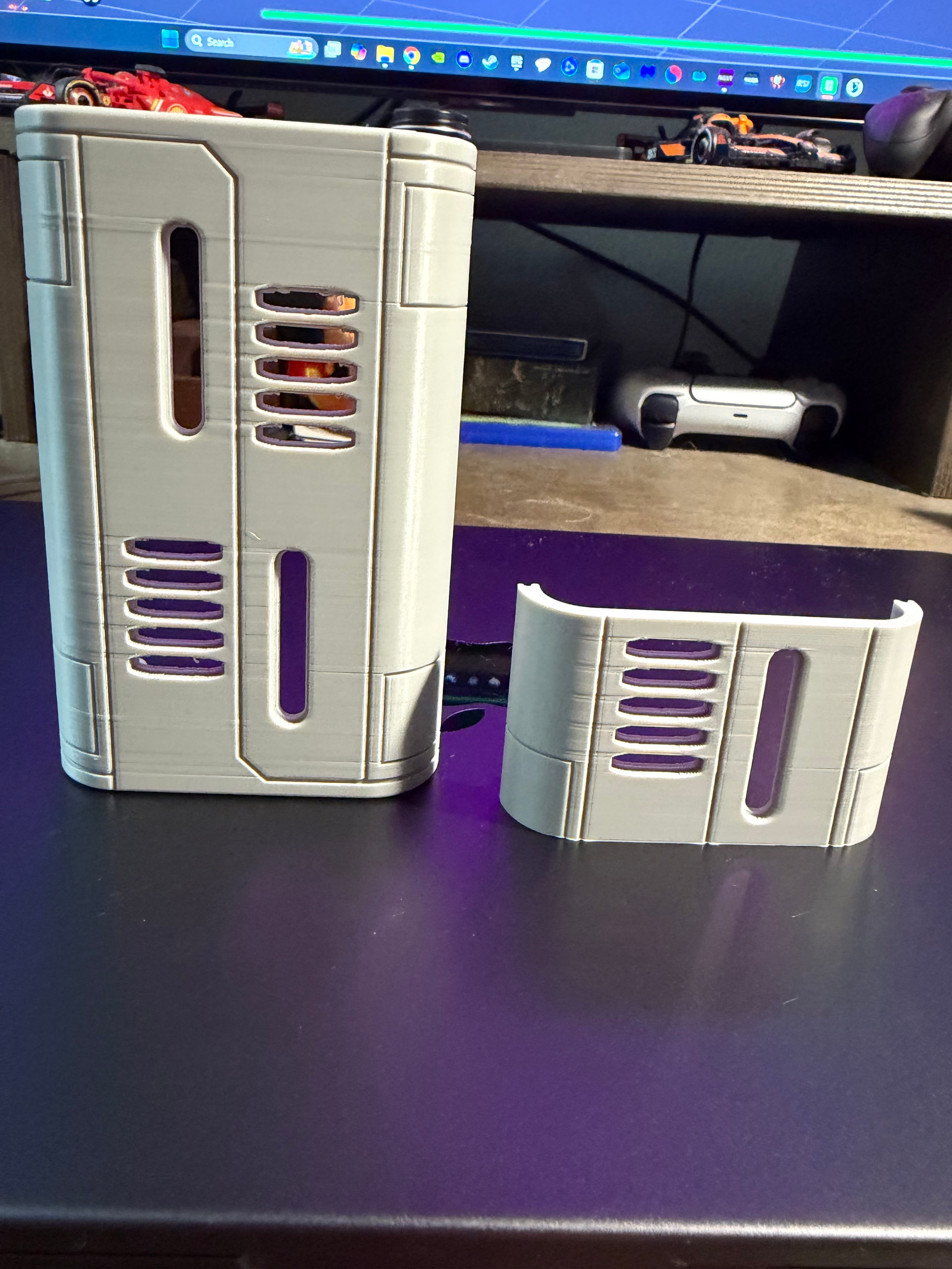

Here’s the results of the first test chunk of that problem area. This one only had the smooth coefficient and Arachne walls applied. To my eye it seems a bit better for sure, but still evident. So I’m going to keep poking at it. I’m about to start another test with Variable Layer Height applied, and if it’s still not there I’ll do another with supports.
If anybody wants a closer look at what’s going on with settings, or has an abundance of time to fiddle, I’m going to attach the .3mf of the chunk I’ve made to troubleshoot this.
