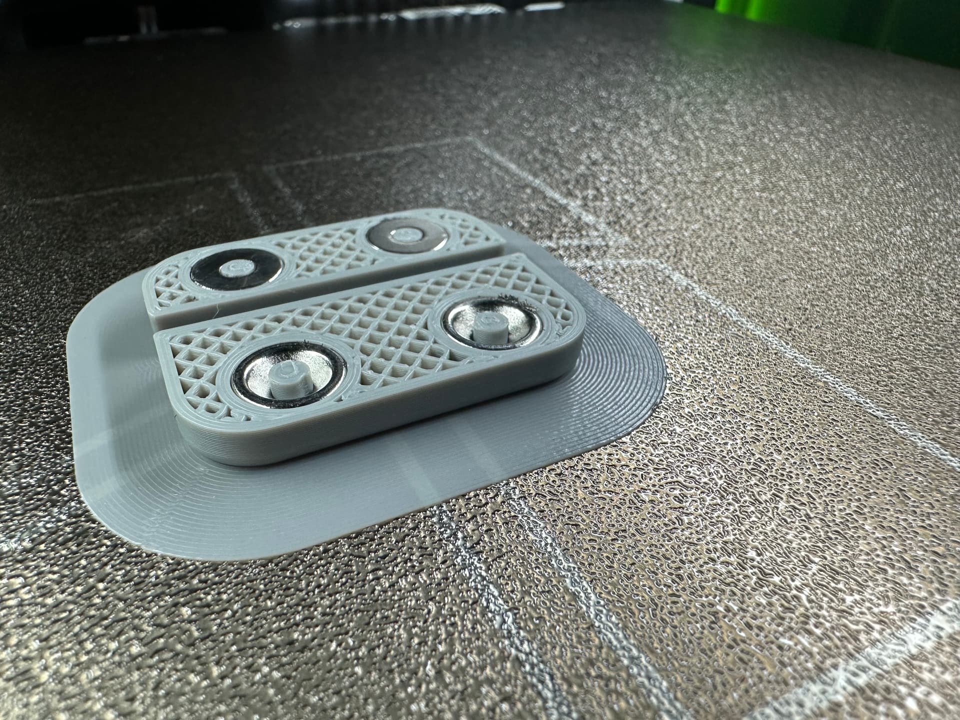

Hi, after a 1000 hours of succesful printing Pla / ASA I am exploring new trics.
During printing with pause on H2D the polarity of the small magnets reverse, so not physically but due to the temp and strong work bed magnetism combo they flip polarity, anyone else that has this experience? Am I to close to the bed?
Thanks!

What nozzle are you using? The hardened steel ones will attract a magnet and can then pull them out, use the normal one.
  1. I am not making this up! Also scientifically it is possible…!
  2. No mistaken orientation. Thought I made a mistake but tried it 3 times & 3 times it flipped the magnetic polarity…
  3. Magnets are pressed in and can’t move
  4. Just normal printing head.
Magnets can and have been known to have their polarity flip. My guess is something with the heating coils in the bed would be the culprit.
Maybe highly improbable is the better way to put it.
Neodymium magnets can reverse their polarity, but that is one ■■■■ of a process that includes it needing to be exposed to other very powerful magnets.
I have noticed that the only picture you are using is on the print bed. My guess is that the magnetic field of the print bed and the inserted magnets are combining and tricking you to think that the polarity is reversed. Though this will not be permanent, all you have to do is take them off the print bed.
Have you tested them after taking them off?
More importantly, how are you determining that the polarity if flipped?

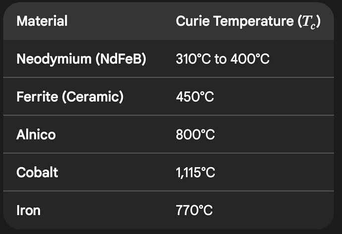

Neither heatbed nor nozzle are getting them to their curie temperature

This is what it would take to hit the Curie temp.

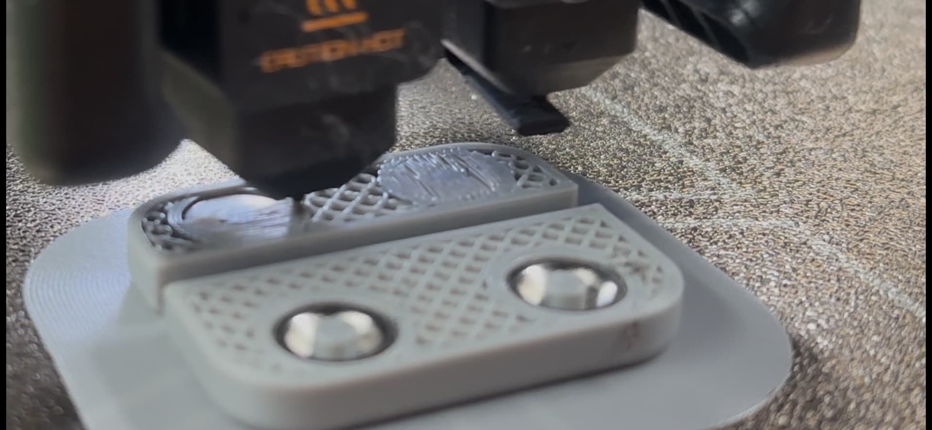

I have watched a magnet flip, as the nozzle went over it, during a travel
It is important to point out that the Curie temp refers to the temp in which a magnets looses magnetism, not reverse polarity.
Also, Tc is the point in which magnetism is lost completely. The loss starts at lower temp, ie, 80c for NdFeB.
Thanks for adding that.
