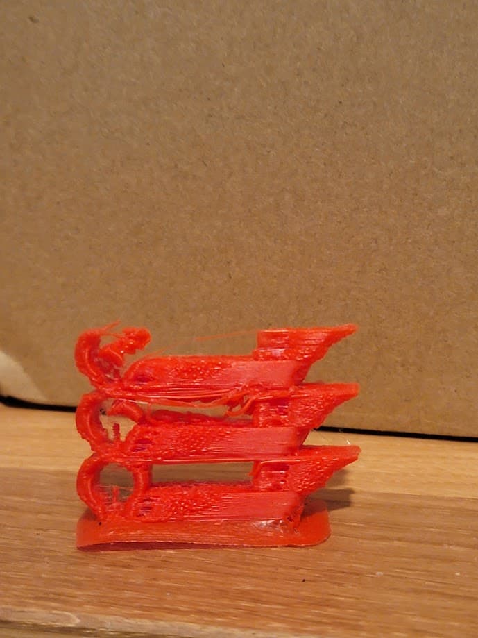

Well, there seems to be more than an offset issue. Here is my attempt at a temp tower. The flow and pressure test printed ok.
thats definitely underextruding and looking like a partial clog. Did you try a different nozzle? perhaps a different size?
Been doing this for quite awhile now and seen a lot when it comes to troubleshooting. This gave me some nostalgic vibes of partial clogging, under-extrusion, low nozzle temp or wet filament.
Try some of those 1 by 1 and see if it helps
Try to just heat up the nozzle also and manually extrude the filament and examine the nozzle. See what it does and looks like when extruding out. If you dont happen to have another nozzle then I’d use your clogging needle to clear the nozzle out
It turns out that the bad temp tower was because I miscalculated on the pressure tower test. I removed that setting and the tower is printing much better.
