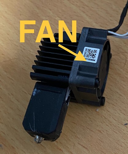

Just replaced everything in the extruder head and now it will not print, keeps getting clogged or just stops print.
Double check that your nozzle fan is plugged in fully and working.
You’re going to need a bit more detail. Pics of the current state of the print head and connections and possibly video of whats happening (clog/stop). If the printer is in warranty, have you sent a support ticket?
If it’s getting clogged a minute or two after first heating up and especially if it then becomes nearly impossible to unclog or get new filament to feed in at all, then it’s almost certainly the case that the little fan on the side of the hot-end heatsink either isn’t working or isn’t present at all (people have done that!) This allows the “cold zone” (heatsink) to warm up too much, causing a phenomenon we call “heat creep.” Double-check the fan’s wire connections and use a light to confirm the fan is spinning when the nozzle temp is above 50ºC. (It turn off below that.).
