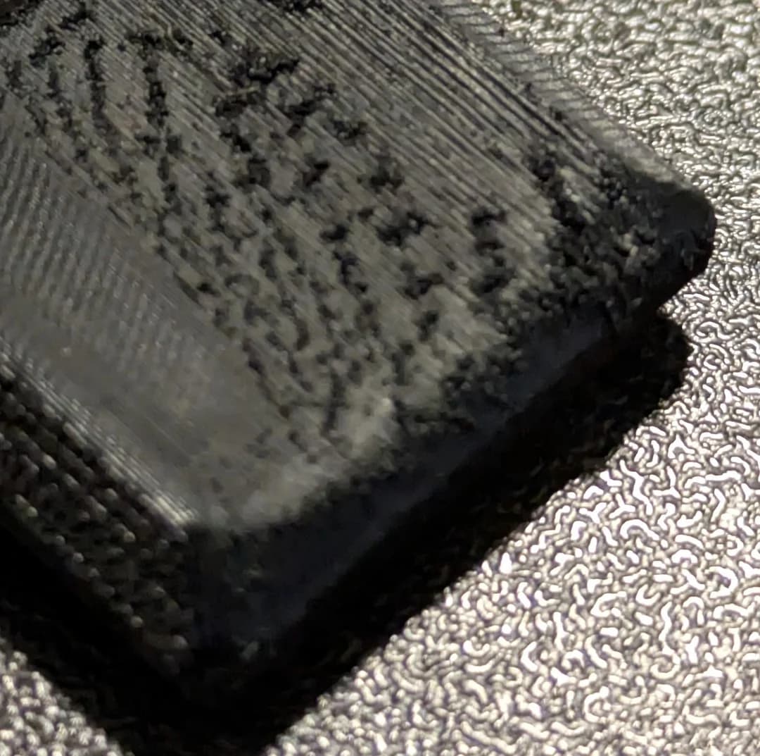

meanwhile, question:

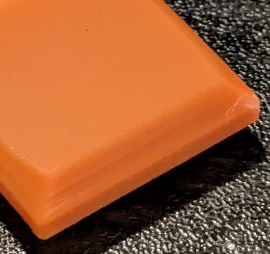

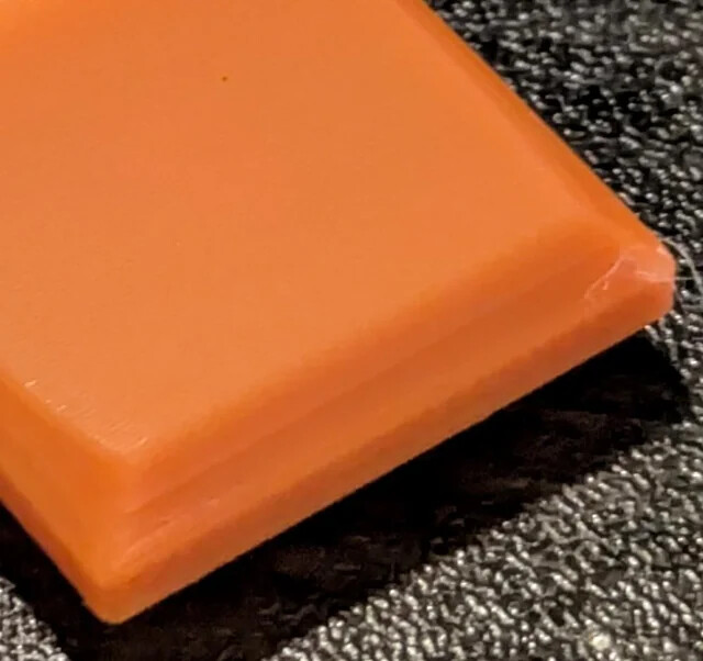

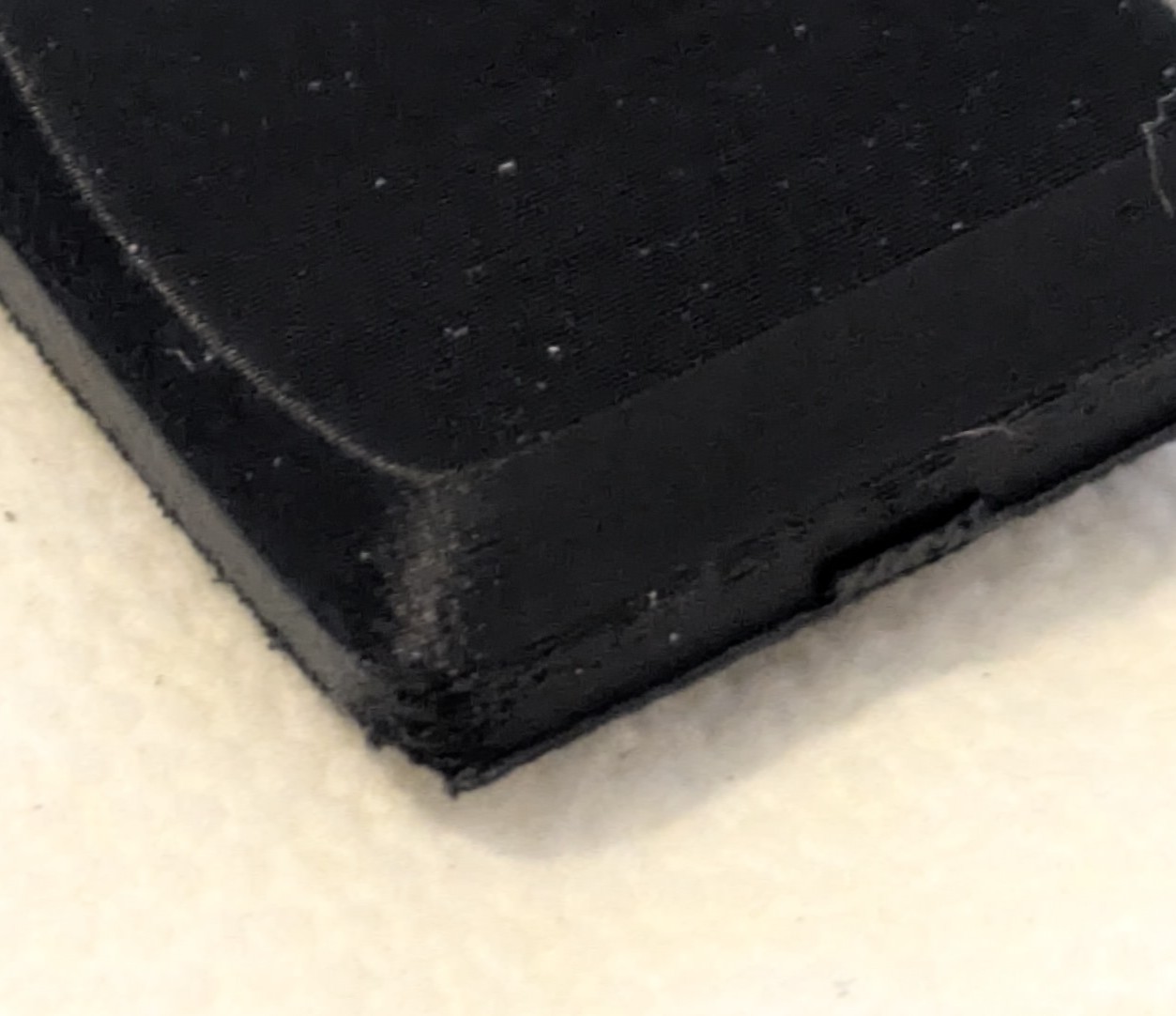

I did a print with Bambu PLA Basic, .08 layers, looks amazing on both sides
impeccable surface was at ~-45*C (overhung)
however when I tried different filaments (esun pla or sunlu petg, i tried their profiles), top surface looks pretty good, but bottom (at negative angle 30 or 45 from vertical) looks pretty bad (esun pla):
but if it’s top facing surface (object reoriented),then it look pretty good:
however the back (which was slightly overhung 30 or 45* from vertical) still doesn;t look so good as orange bambu pla.
What’s causing such difference ?

Regarding the difference between PLA and PETG, well, they behave very, very differently in fast printing.
Most importantly, while both have similar moisture uptake rates (by Bambu Datasheets), PETG reacts much stronger. So I myself can not get away from drying PETG when new while PLA usually (but not always) allows me to get acceptable prints with moisture.
From my trials, I expect that this PETG sensitivity to moisture is related to its thermal and rheological sensitivity.
My experience is, that it appears to react much more strongly to forced cooling (=> curling and warping) while also taking longer to give up heat (curling, sagging, oozing, stringing). This shows in particular in its overhang performance.
While I have found the “Generic PETG” default cooling settings to be quite good, I usually slow down my PETG prints quite a bit and use adaptive layer height to avoid running into the curling overhang death trap. Literally. I did loose me a couple of nozzles to PETG curling.
So expect very different printing, in particular overhang, behavior between PLA and PETG.

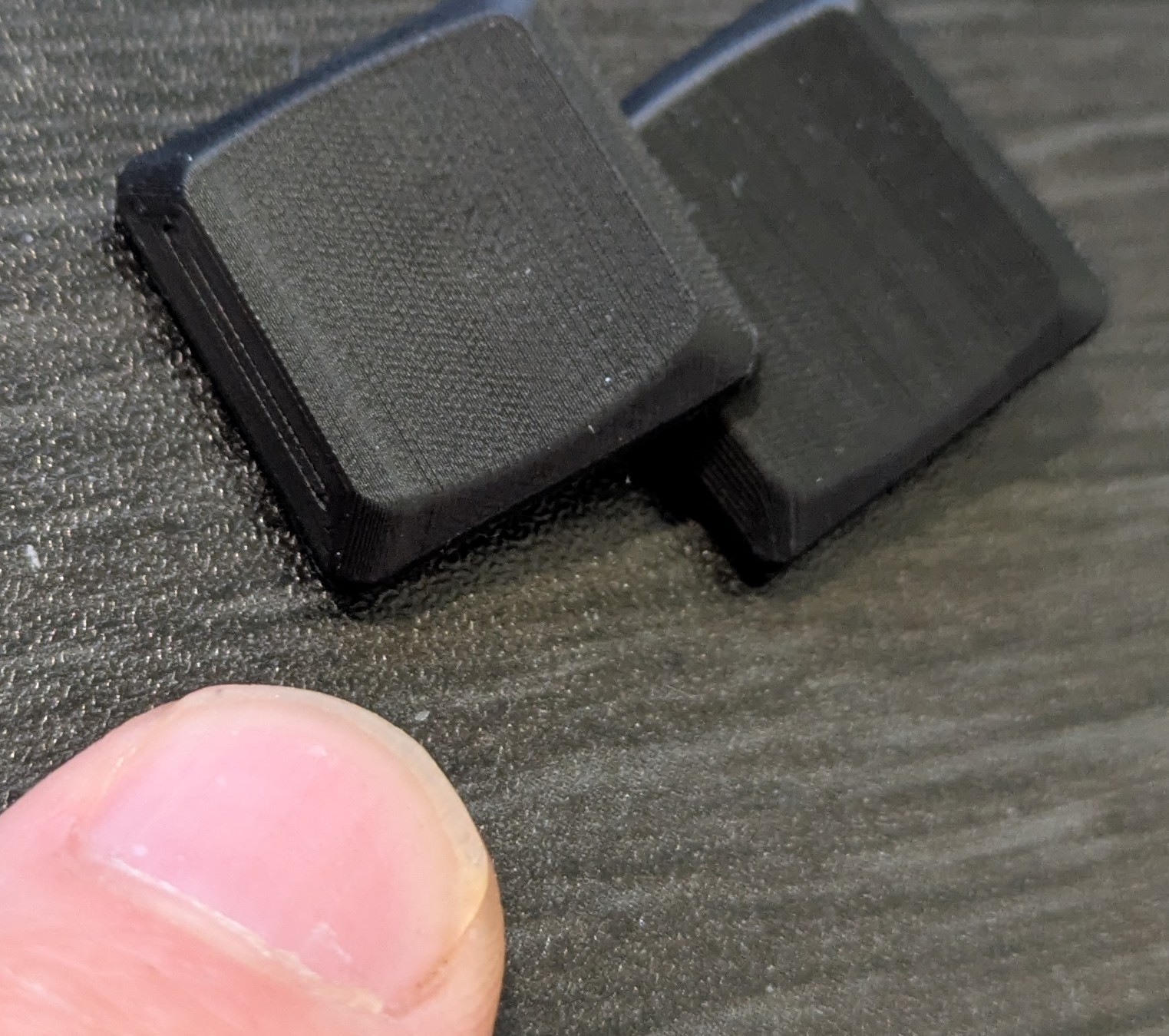

But it also happened with eSun PLA, surfaces on negative side were pretty bad (that above black print)
if I put that surface on positive side, it’s super nice
but I still need some details at the back :frowning:
everything was printed on .08 High Quality preset (.4mm nozzle), so I guess one of the slowest setting ?
PLA on the left - more matte, 4in1 print scaled down to 50%
ok, I see PETG is more problematic, i’ll leave for bigger objects, I’ll try to improve my black eSun PLA then. as you can see, on positive surfaces it looks amazing, just negative ones are not so good as Bambu Pla Basic (orange). Should I dry it more? or calibrate?
also that eSun black PLA doesn’t stick to the bed the same way, I can’t do my prints on the same surface and position like Bambu PLA Basic, eSun disconnects from the bed mid print :confused:

i printed with .08mm layers just to see how much quality I can get. (not because overhangs). as I said, Bambu PLA Basic (orange) looked perfect from the beginning. Does it mean uSun PLA needs more cooling? I can try to print 2 objects at a time.
Orange Bambu PLA was out of a box. first black print (eSun PLA) was out of a box too, but now I’m finishing drying it in eSun S2.

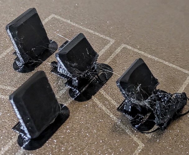

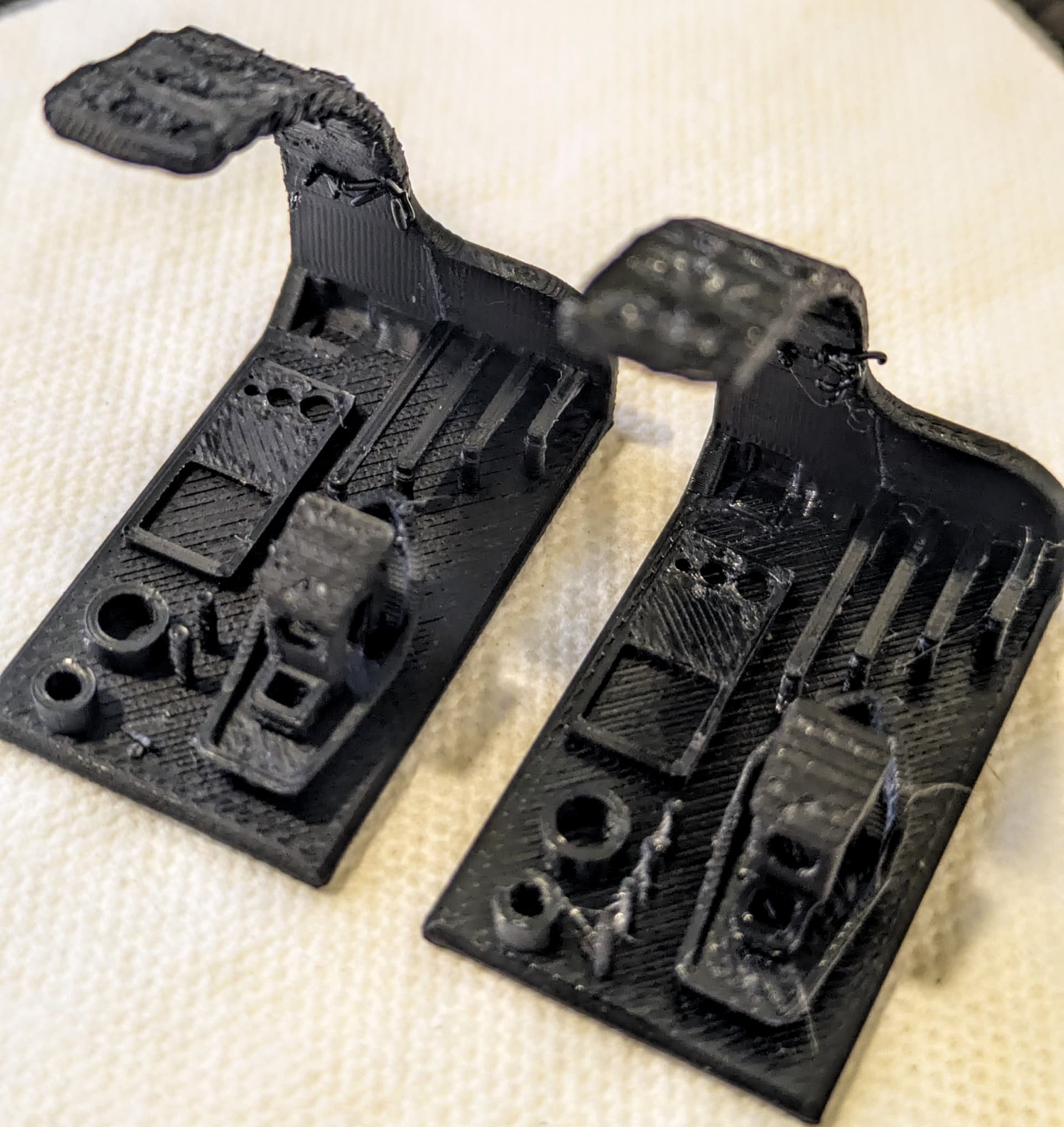

I’m still trying to push PETG to its limits (last try before changing filament and calibrating PLA)

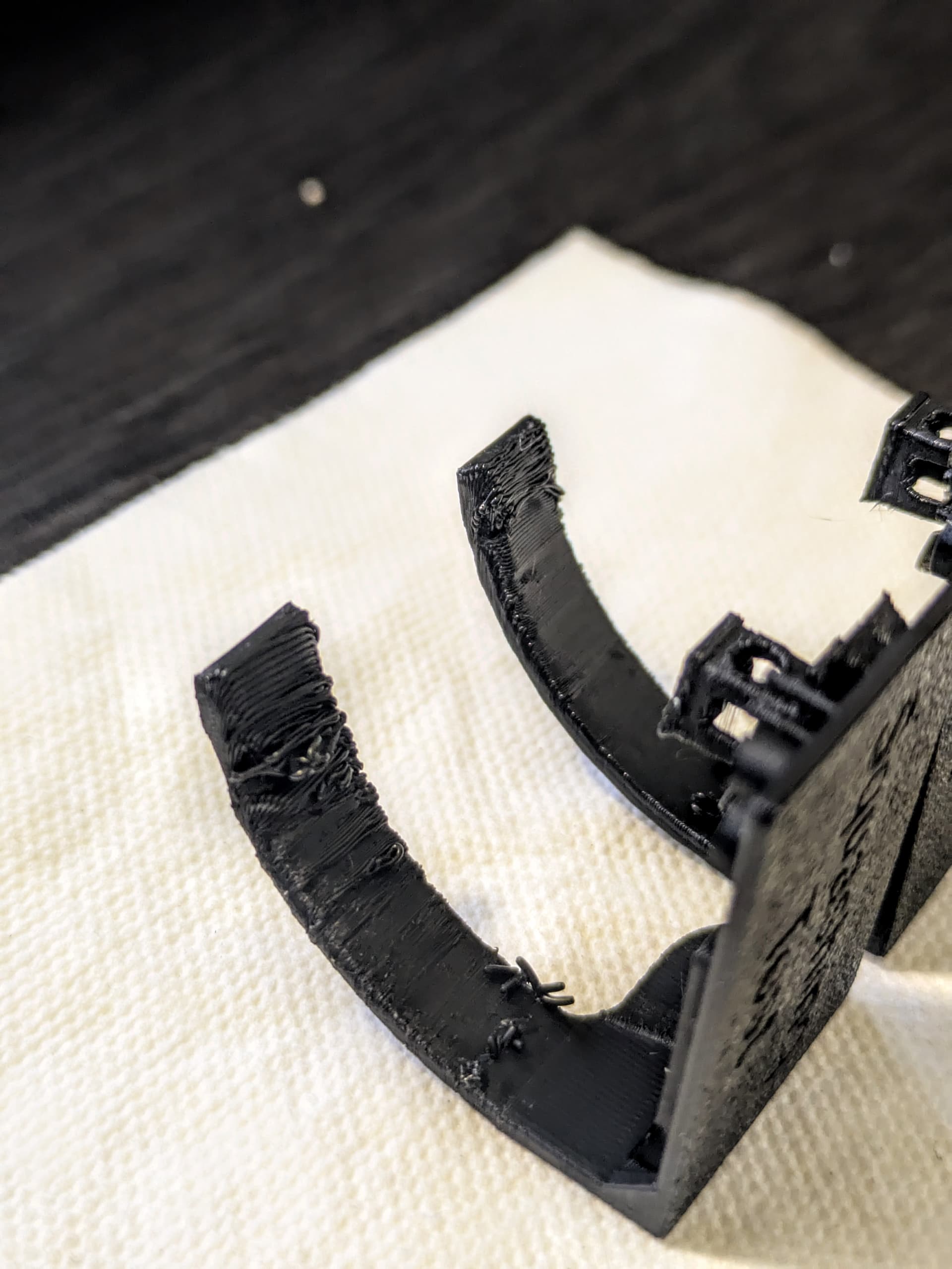

what happened here? those 2 that failed were printed at 45* with support and brim (like the other to that successed at 30*)
Why did that fail mid print? now I realised i made a mistake, i disconnected everything from the plate without looking closer.
It looks like the bottom didn’t stick to a brim ? (before support could support the structure) ?
I set everything very slow, layers .08mm, first layer 30, max speed 50 for everything, even acceleration max 2000. bed temp 70.
I am afraid that a little more info would be needed.
How long have you dried the roll at which temp?
How does the actal layer time relate to the time set for the max fan speed in the filaments cooling settings?
What were the slicer preview speeds?
What was the the slicer preview flow?

I am afraid that I am at a loss as to what it is that you are (currently) trying to learn and/or achieve.
  • What Filament are you printing now? PLA Basic, Silk, Matte, Wood, Glow,… or something else?
  • And on what printer? Couldn’t see that information anywhere.
  • How long have you dried the filament and at what temp?
  • Flow Rate calibration? (Since you are inquiring about the subsequent Flow Dynamics).
  • Why did you choose the tower rather than the much easier to interpretate Pattern calibration?
Hey. P1S. I’m trying to achieve the same quality I got from ORANGE Bambu PLA Basic.
BLACK non shining is eSun PLA Basic, GLOSSY is Sunlu PETG.
I print it on .08mm layer High Quality preset (so the speed is already decreased).
Filaments were dryed overnight in Sunlu S2 dryer, at least one cycle 6h (50* for PLA and 65* for PETG), and now I kept in AMS with desiccant, hygrometer says 35*C, 12% humidity
When I printed my object first with orange PLA, even negative 45* surfaces were perfect, whereas black PLA were bad (first picture) - also that black PLA didn’t stick well to textured PEI. (contact surface is quite small)
I achieve quite good surface with black PLA putting that surface at 30-45* positive - however then the back lacks some details, which are needed as well. - and also it’s printed on it’s edge, so it needs some support.
So I’m just wondering is it just Bambu PLA basic way better filament ? or is it just settings ?
That does indeed help. With the P1 not having an auto flow calibration, you should indeed calibrate each filament for flow and, subsequently, flow dynamics. I find flow dynamics using the Pattern easier to interpretate than the tower.
Key influences on these two are the filament and the nozzle, in particular its condition (wear).
In the past, I have found that even color can influence a materials rheology. In particular black tended to ooze, string and sag a bit more. I attributed it to the pigmentation having a strong effect. I do have to say though, that with the Bambu PLA, I am getting consistently goid prints. But.my X1 does use auto calibration.
While there are several avenues to explore to improve overhang performance, I myself have found the easiest parameter to control to be speed.
Nozzle temperature also adversely affects layer bonding while cooling settings are highly interconnected and as such a bit of a box of Pandora.
Speeds on the other hand are easy to set in the slicer and can be used to give more time for cooling while maintaining layer bonding.
Finally, you need to be careful not to run into other effects outsides of your investigation. So take a careful look at all the slicer previews (flow, speed, fan, layer time) while keeping a look out for the print determining factors. Is the print flow controlled, speed setting controlled or layer time controlled is very important when determining root causes for suboptimal prints and quite likely an overriding issue for small samples.
So it could very well be that the filament is not very good. But usually, every filament has its sweet spots. Finding these should not be too difficult though when starting from manufacturers recommendations. As long as they are in the realm of physical possibility that is…
