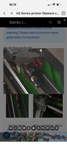

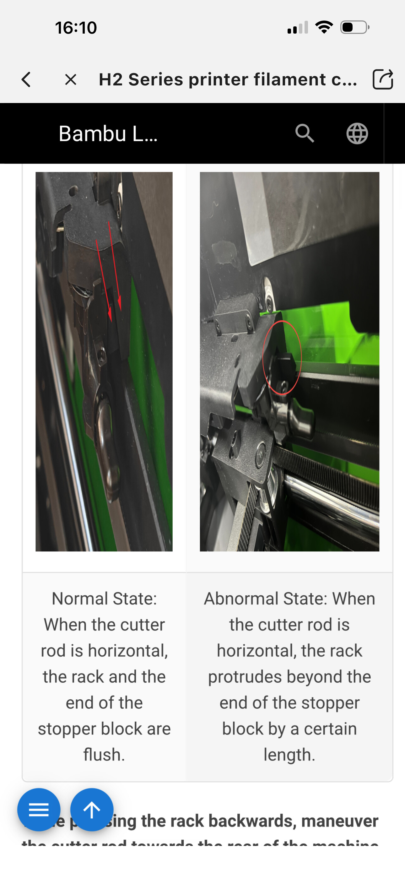

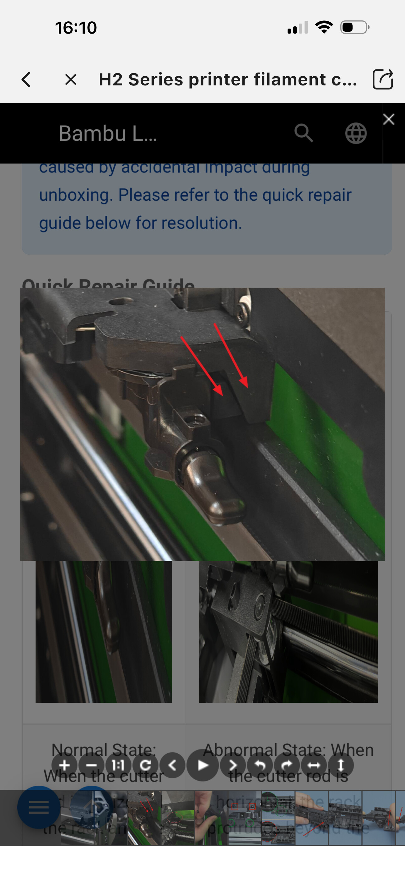

Ok. Go follow the help topic which takes me to a guide that indicates such issues may arise from shipping/unboxing. My guess shipping given the hole in outer box I saw. In any case , “rack” , according to the guide , should be fully flush inside when the pin is pointing toward the front of the printer.
If not one should push back on the rack while moving the pin toward the back to allow the rack to skip and be repositioned.

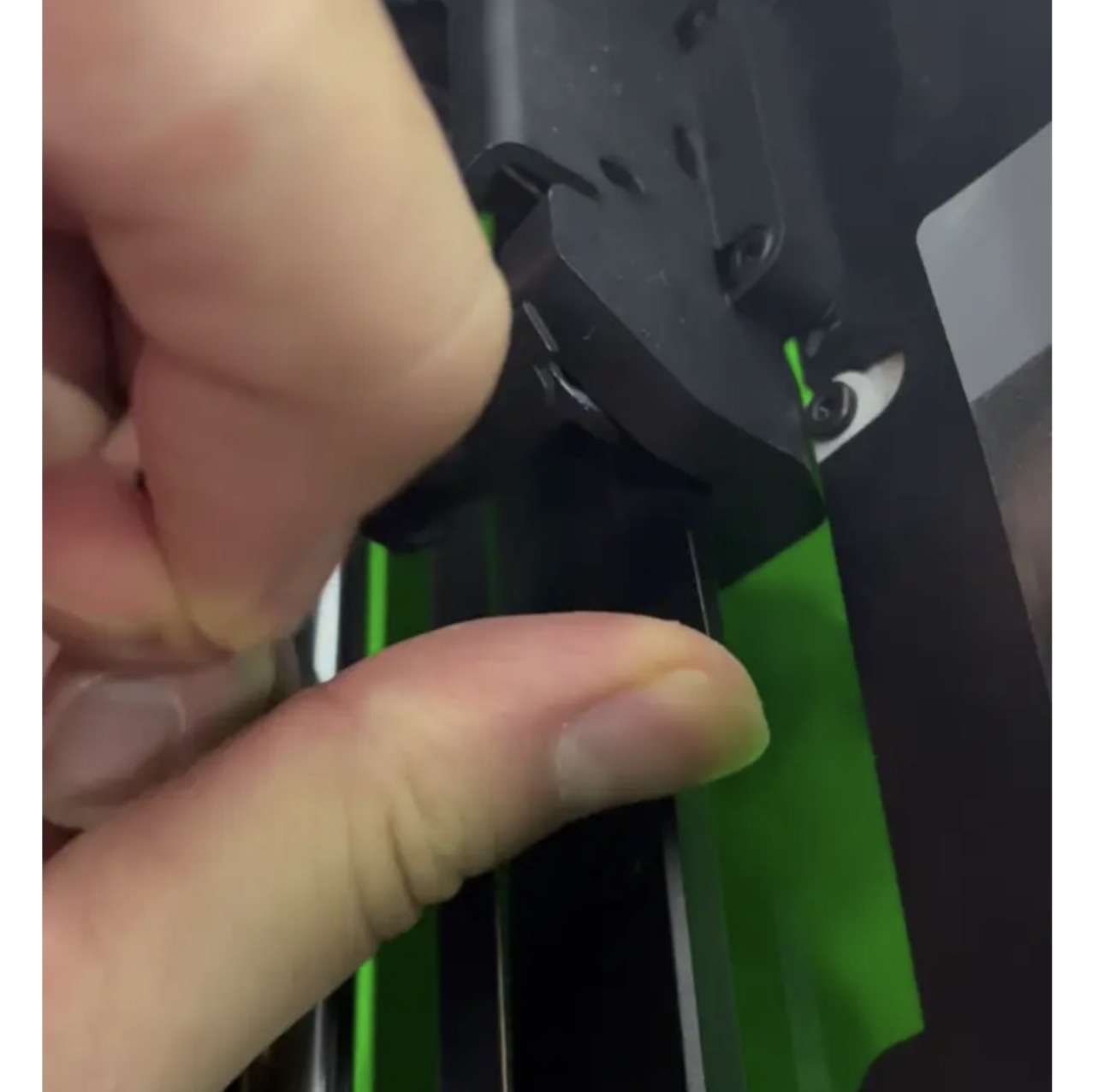

Give it a try. I can get the rack a bit back but no way fully back. Neither the left nor the right rack will to fully back. Hrmm.
So now the racks are not moving the pin back at all via the print head. Crap.

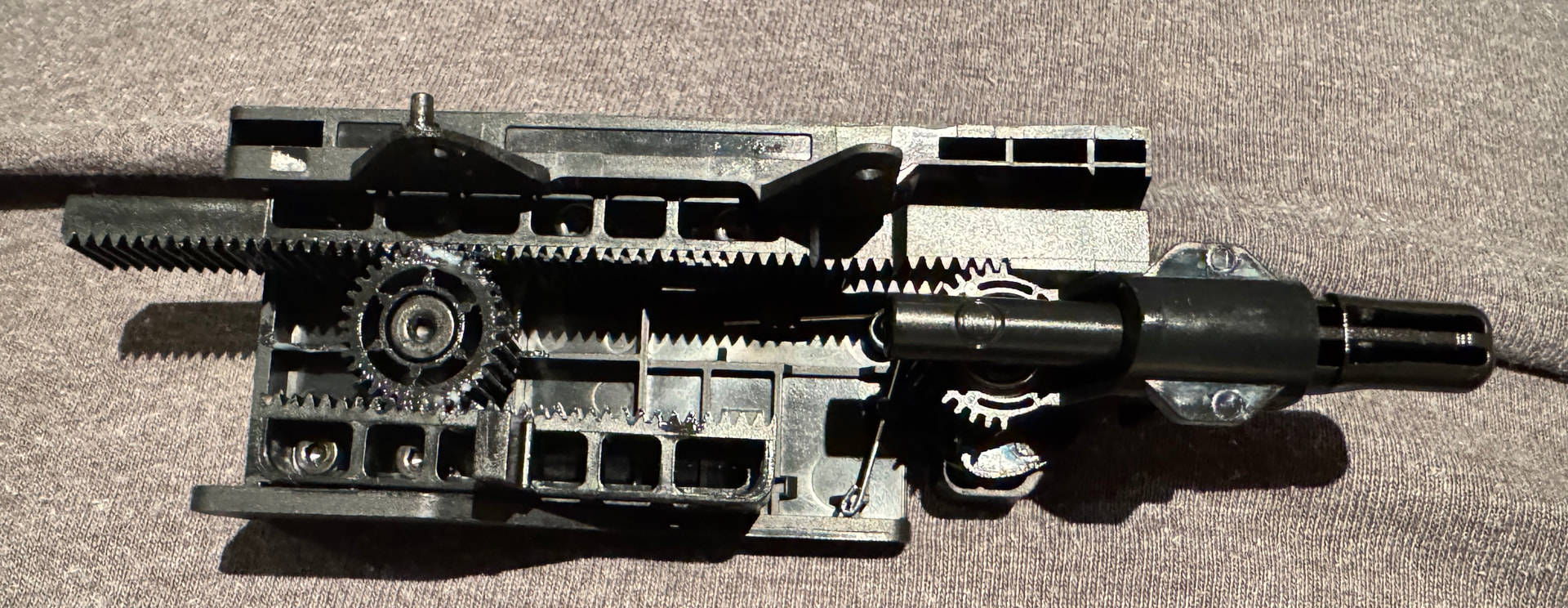

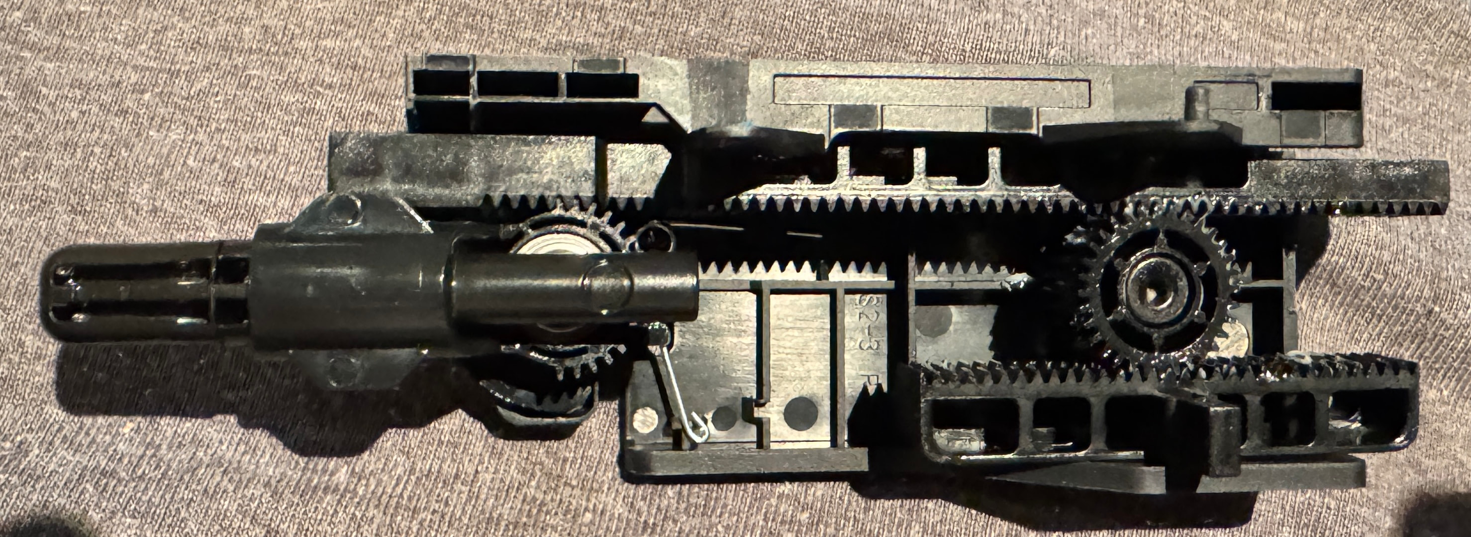

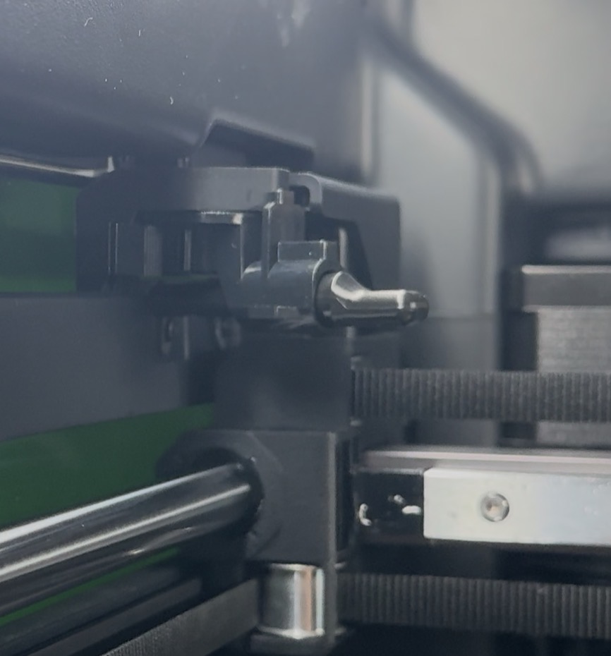

For others that may end up here, this is what the rack looked like after having done the Bambu recommended in-printer adjustment , which for me ended up setting the racks more out of alignment. I’m not sure if I just didn’t do the in place adjustment correct or if the adjustment instructions are wrong.
Then this is what I aligned them to , which is the goal of the alignment process given with the racks removed, an it is the other sides rack. Key is the teeth in the tip of the gear at the pin end being engaged with the very first tooth in the upper rack.

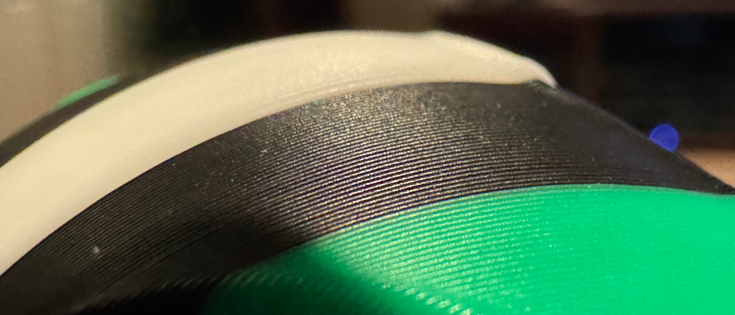

That got me able to print the 3 color benchy successfully. However I noticed the left print head is slightly out of alignment based on where that singular color (white) in the finished 3 color benchy. Assuming it’s from me moving and laying on its side of the printer, to work the pin racks for the cutter.
So now I’ve reseated the nozzles, cleaned the alignment sensor, and its back to a full calibration and optical alignment and doing another test 3 color benchy to verify the dual nozzle and filament changing work correctly.
Glad you got it fixed. I couldn’t remember the exact number of screws. I have bad news for you though… if you thought that was a pain to fix, wait until you have to do surgery on the print head. Serviceability is not in Bambu’s dictionary.

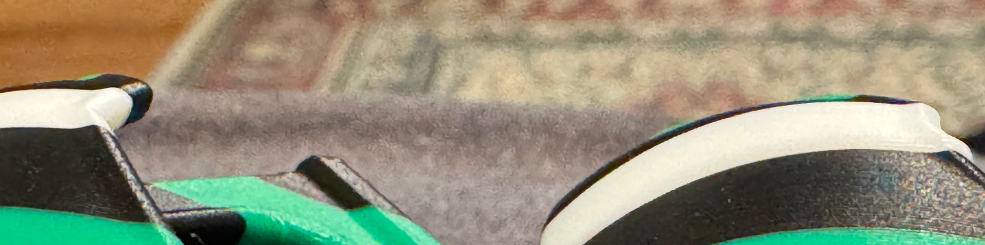

the full recalibration and reseating of nozzle did the trick. The change from left (white) to right (black green) nozzle is now smooth and even (left print) vs the first try yesterday (right print) . If anything the black green changes via the ams are the ones one can feel most. This is to be expected.
