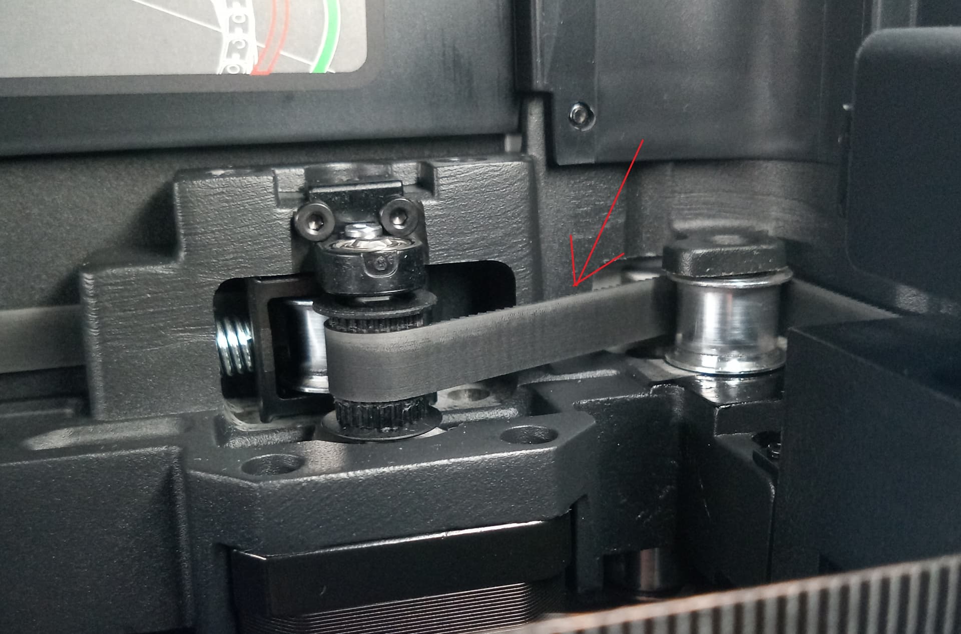

While doing it i saw some Problems like this:
The Beld is rubbing on the Ideler at the Back of the Printer!
How long will it last this way?!
Is this an longterm Problem???
I think the reason for this is the Connection off that Belts to the Printhead!
May be iff the Belds were down and up 0.5mm to 1mm on the Printhaed they would not Rubb on the Ideler ?!
I am not sure about, could anyone else with an H2D say something ebout???
Have they see the Same Problem?
The belt rub phenomenon is a long running unsolved issue ever since the X1 kickstarter release. It seems companies have focused on new tech and features over improvements on previous designs.
If they’ve developed the “autonomous belt tensioning” feature i’d love to see some method of implementing a semi-autonomous pulley tensioner. The problem is the pulley is static, the belt will follow the low point every time simply due to the belts tension. The only way to combat that is to have the pulley itself re-align itself with the belt. So how do we go about having that component be movable along the (Z axis) ? Maybe a calibration method that adjusts the pulley automatically then locks in place prior to prints and simply becomes a calibration every so often.
This perspective is not from H2, but from P1:
The belts did wear, a lot, quickly at first. Concerning amount of black rubber crumbles in the back! No quality problems, but the rub was there.
It took a few days of printing, but it stopped. The belts wore down visibly, but in the next 3000+ hours printing on it, no more wear visibly occurred, and it never had any issue relating to the belt.
Keep an eye on it, but dont be worried unless it continues for a long time. I had a similar experience in the Elegoo Centauri Carbons – lots of wear initially - then stops. But I havent had enough print hours to say that elegoo’s ones are good :wink:
The Belt connection to the Printhead is screwed with 3 Screws, so i could rework The Connection Parts and move the Beld more in tne Midle of the Pulley left and right may be it helps?
I guess all Pulleys are Axial in 90° Position in the Aluminium Frame , i guess they Reworked The Aluminium Frame with an CNC Maschine.
So it became Precise.
Yeah that what i will do, till i have Garantie on this Machine i wont rework it!
Only Using it like sugested but after this i will go in some rework may be.

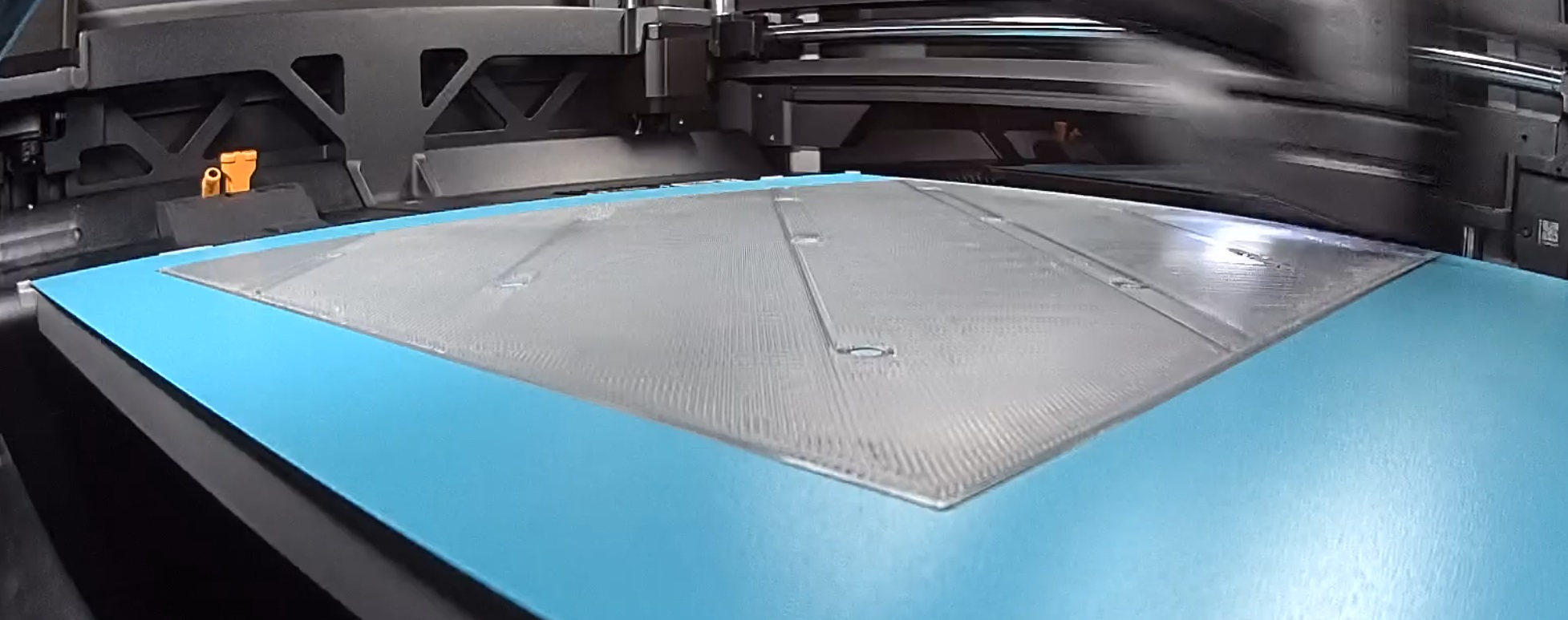

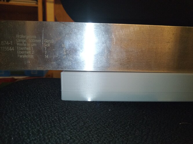

My next Problem i found is the Wobly Print Bed, the Frame is fron Plastic and has only 3 Point Connection in Z

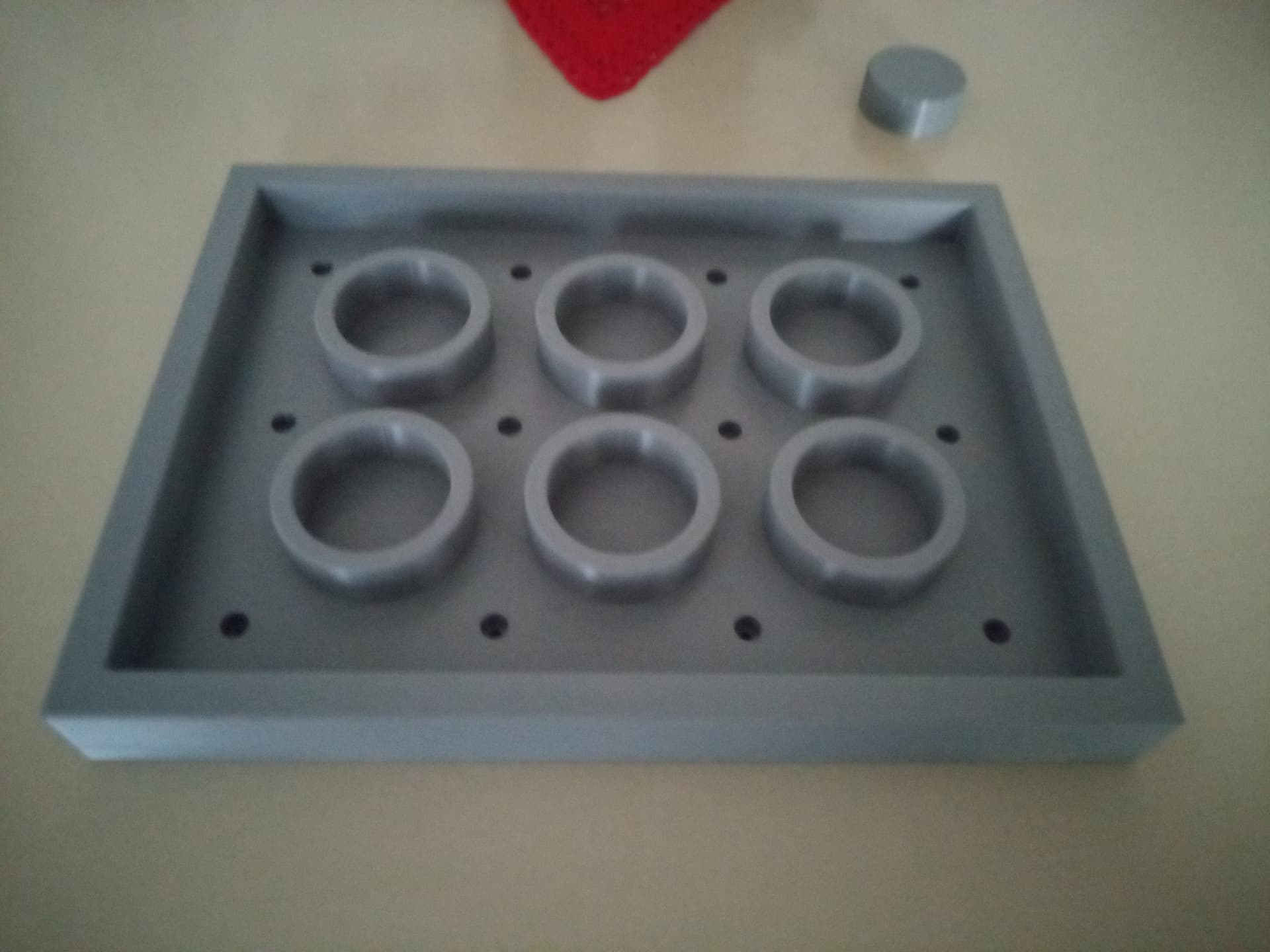

I Printed a large LEGO Plate:

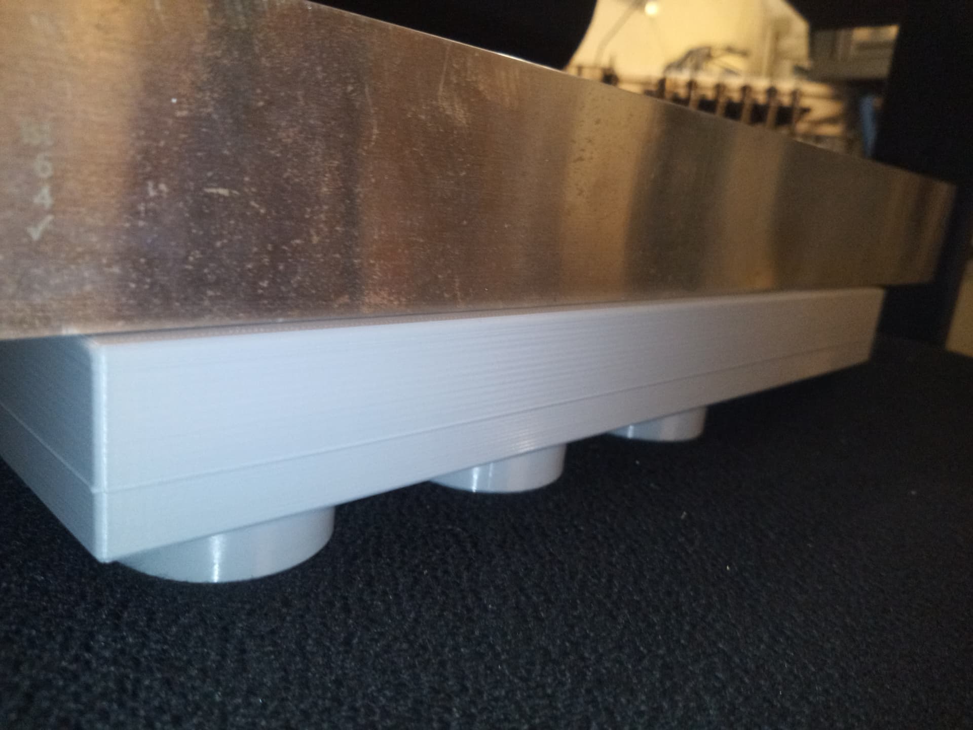

But the Long Side in the Front is Plane and the Back Side is like an Bananna!!!
I Printed it from PETG with Bigtreetech Glacier Plate @70°C Bedtemperture!
It stiks like Hell and wasn’t Worping @ all till the End!
I made an Video off the Printing till the End you can’t see any Warping!
But after i removed it 2 hours later after total cooldown and put it on an Plane Tabel i saw the Problem, one Side wasn’t plane like Sugested!!!
If You put an Finger on the Printbed back Left and Right you see it moves down and up! On the Front Side it won’t!!! (Doorside)
Thats realy anyoing me more than the Belts!

One Side
Other Side
But i can’t realy say what side was on the Door side while Printing, because i found the Problem after removing it from Printer and putting it on a plane Table.
If you printing smaller Stuff in the Midle of the Printbed with the same Material and Settings it looks like this fine! Like Perfect!!!

SO iam not realy sure what the real Problem is on large Parts but it seems to me it is the Printbed thats not stiff enough???
PETG is not known for much shrinking so i am not the Printer POPE to know why…
I can’t say that’s all factual since I’ve not heard anything about how they positioned the pulleys. But I do know you can see the results right in front of you when you retension the belts and move the toolhead carriage around via XY axis.
The tension will put (xx) amount of force onto the pulley and overtime 1 being the belt/ or pulley will end up shifting/settling first. Over the course of using every version of bambu printer I’ve found that you can seat the belt some what perfectly to ride along the pulley and not rub the top or bottom flanges. BUT the moment tension is lost the belts will resume to the lowest point along the toothed pulley no matter what and you just need to re-tension again.
As with ALL electronics, heat & speed kills overtime and these are both factors within these machines day in day out.
Try re-tensioning the belts (then recalibrate), add mouse ears to the large prints, and turn off the aux cooling fan. Belts are notoriously hard to get centered and even if it is perfect, they can ride from one side of a pulley to another based on the movement direction.
Don’t need Mous ears it wasn’t warping i have the whole Print on an Video the Part has a Phase on the Borders so it looks like it isn’t sticky but it was!

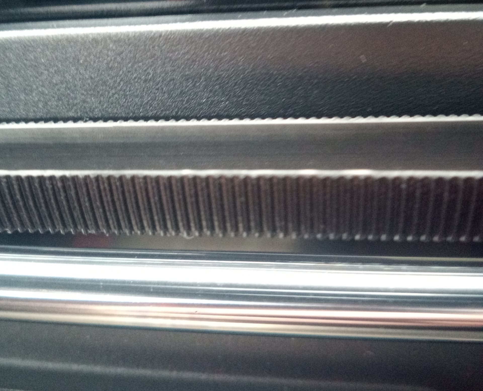

That layer line you are seeing on the outer wall(s) can be from several things, not necessarily belt tensioning or printer head calibration issues. the fact that the rest of the print looks just fine, and even pre and post layers are ok as well shows this.
Often this is caused by having the outer wall speed and outer wall acceleration up to high. Slow these down if you are seeing offset layers like this in your prints (large or small). Next, if you still have this issue, will be to look at extrusion rate for the outer walls. You can try reducing it and see if you get a more consistent (flat) outer surface.
Considering you say your printer is new, I highly doubt its a belt issue. Run the test bench prints for overhang, surface, etc., and dial in your speed, extrusion, and other settings first. All printers are different (even if they are the same model) and the optimal settings for your printer will have to be found via trial and error.

Not a problem. Totally normal especially at first. Lasts very long.
It’s not an issue regardless of what people think. The belts have been proven to have very long lifespan even on old printers.

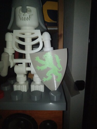

Next Problem:
Bambu PLA GLOW Green didn’t work well on AMS HT, it get Stuck in it after Print!!!
I got an new spool on this Saturday!
It wasn’t able to remove the Filament from right Nozzel on H2D!!!
I must Help and remove it with my Fingers!
The Filament feels realy rough.
But on Description it says AMS Compatible …LOL
But i wont test it on a AMS Pro didn’t think they are much Different.
Will Try it on the Back opening on a ANS HT like with TPU
The Motor don’t get it automaticaly out, so anyway
At the End i was able to use the Print :wink:
BTW i did first an Manual Flow Kalibration (K=0,025) thats works well but after the first Print it fails!!!
