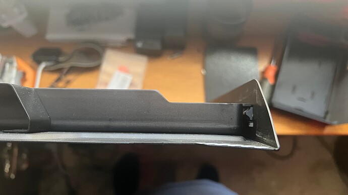

The only issue I had was with the laser bed. I was getting constant alignment issues during calibration because the back left corner of the laser bed was bent slightly thus causing it to not properly push up against the tab on the printer bed. I bent it back into shape and now it pushes up against the tab properly. I’ve not had an issue since.
As it came out of the box:

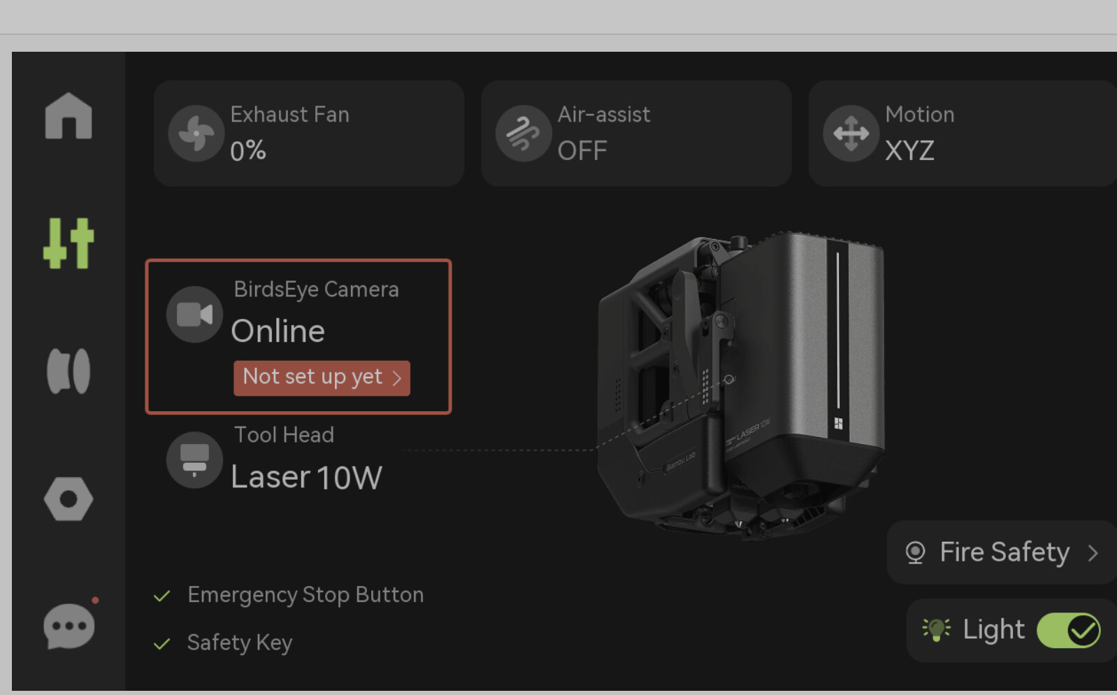

When you have the laser module installed, on the touch panel, see if you can recalibrate the birds eye camera. I’m not in front of my H2S, but I believe you can touch the BirdsEye camera on the touchscreen and recalibrate it.

Ok I watched the video as I had just skimmed the manual. The display screen had the birds eye camera as online without the red text under it. Under laser it had in red Not calibrated yet.
I left the printer unplugged 5 mins before I started all this and cleaned all the cameras again. The side mount cam, birds eye cam, removed the buildplate cleaning the bed(all 4 markers clearly seen), and the sensors on the side of the tool head with a microfiber cloth. After powering on I did a birds eye calibration.
