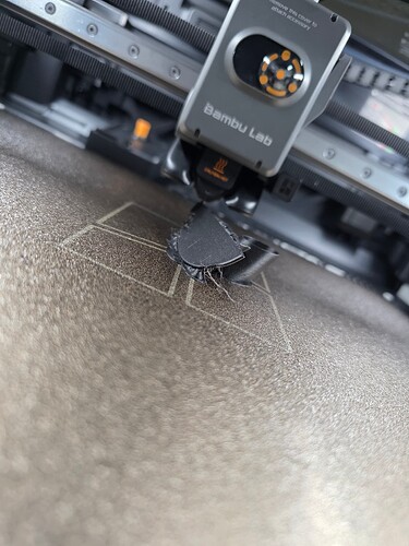

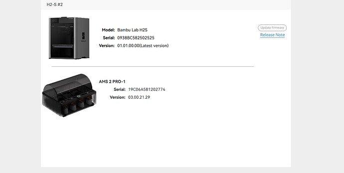

Just installed TWO new H2S printers. Having serious issues with stringing (cob webs) & shiny texture while printing Bambulab PLA Matte Black

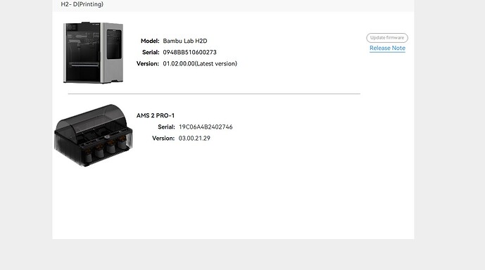

This is not a filament drying issue. I’m printing the exact same files on my H2D with all the same setting. the matte finish is always perfect with no stringing
Any advice would be appreciated. It seem the print profiles for the H2S with PLA Matte have still not been calibrated properly
Same filament roll? Or different? New filament doesn’t mean dry.
Doesn’t matter what roll I use. All have the same result. The H2D has no issues
There’s definitely something going on with the H2S. Some items that printed flawlessly on my X1C look terrible on my H2S. Anything with an overhang seems to be really problematic. I think the printer/filament profiles must not be optimized for the H2S
