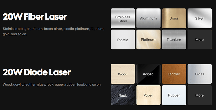

The LaserPecker 5 has both a 20 W fiber laser and a 20 W blue diode laser. That combo allows it to work on virtually any metal, which is a huge advantage. Here’s the image from LP’s site that explains it:
Now, even with that, I still think Bambu has the superior system. The H2D’s head moves over the workpiece, unlike the LaserPecker which moves the laser itself. That means the H2D’s cuts are perfectly vertical, while the LP’s cuts tend to flare wider at the bottom than the top.

In your topic there is a pictures with an info what 20w H2D laser can engrave. Who can explain what does More means?)))) More is a bit wide mention… isnt it?
I would appreciate if someone will share what exactly 20/40W H2D can engrave and cut by its laser.
Bambu has a 10w and a 40w, both diode lasers. Here’s some details about the materials and what not:
https://wiki.bambulab.com/en/laser/material/types-and-examples-intro
If I understand your question correctly I think in this case “More” means “More than what is listed here”
