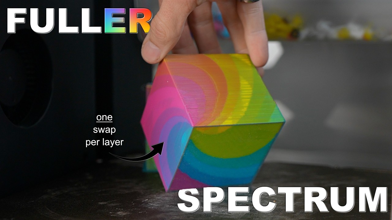

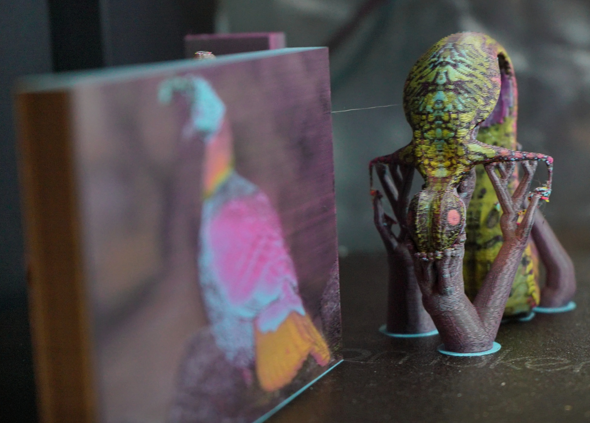

New method cuts the time for colour 3D printing in half - OrcaSlicer ImageMap
Print with only one tool change per layer
  • When printing image textures with this technique, only a single filament color is used per layer (not dependent on texture color). You can print many different models at once without increasing the number of tool changes or prime tower size. This can print faster than other multicolor techniques at the same layer height.

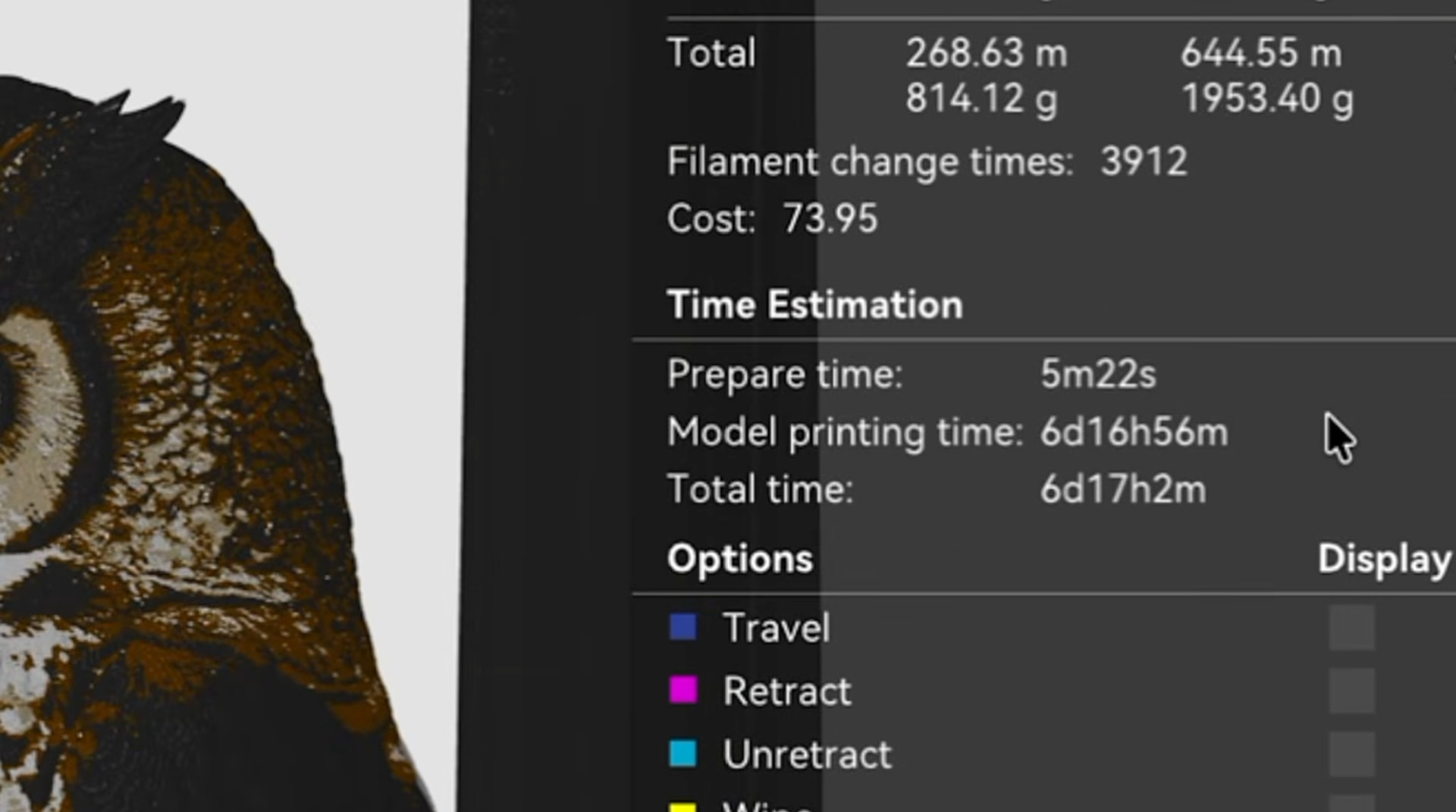

Previously: Six days

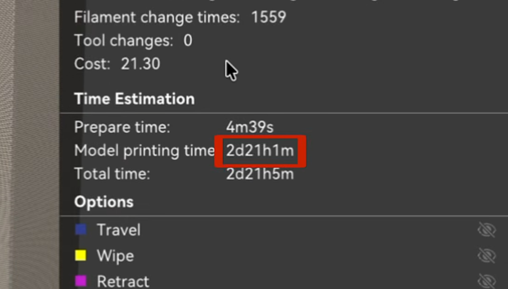

After: Three days
