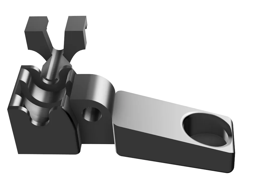

Check that the tension arm on the ams motor is not broken, you can print a replacement
and
