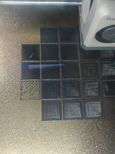

I need some help. I’m getting constant print failures on my new P2S, with the AMS pro 2. Using Bambu Lab PETG HF, my machine struggles to set the first layer without it constantly failing to attach to the default supplied Textured PEI Plate. Have tried cleaning the plate as recommened with alcohol, and dish soap and it continues to be an issue. The first week it was fine, then it started becoming a problem. Switched to the High Quality setting and it seems to work but when using the default Bambu Lab “Standard” setting I’m getting a very high amount of failures. I even tried increasing the bed temp, from 70 to 75, however that didn’t help.
I’ve run all the calibration tests, and it still continues to fail. I had a Prusa mini 2 prior to this, and this was meant to be an upgrade, yet it’s failure rate to adhere the filament to the plate compared to that older machine, is becoming very frustrating. To the point where I’m actually considering returning it, and let’s not even begin to bring up the VFA issues I’m facing on the X axis either, as that seems bad also.

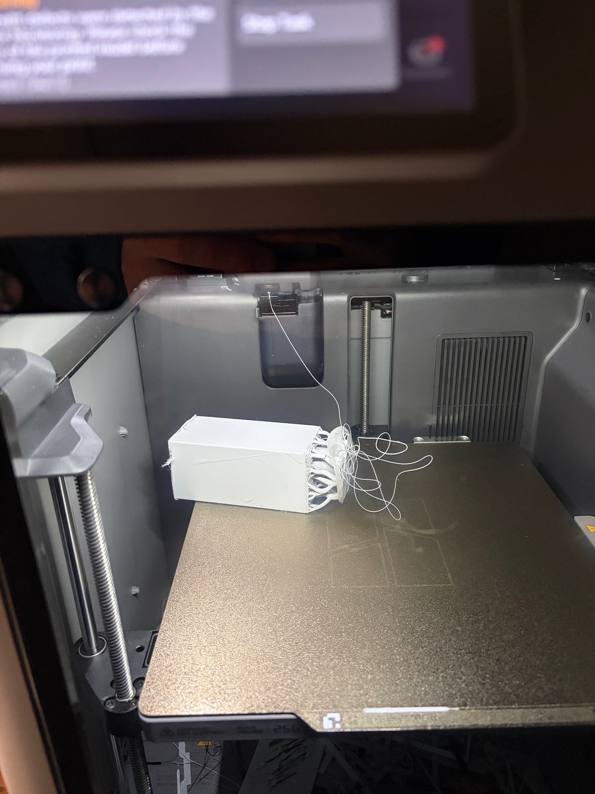

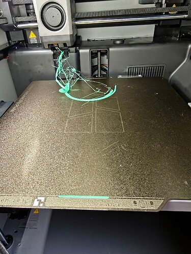

Case in point, of what’s currently printing…

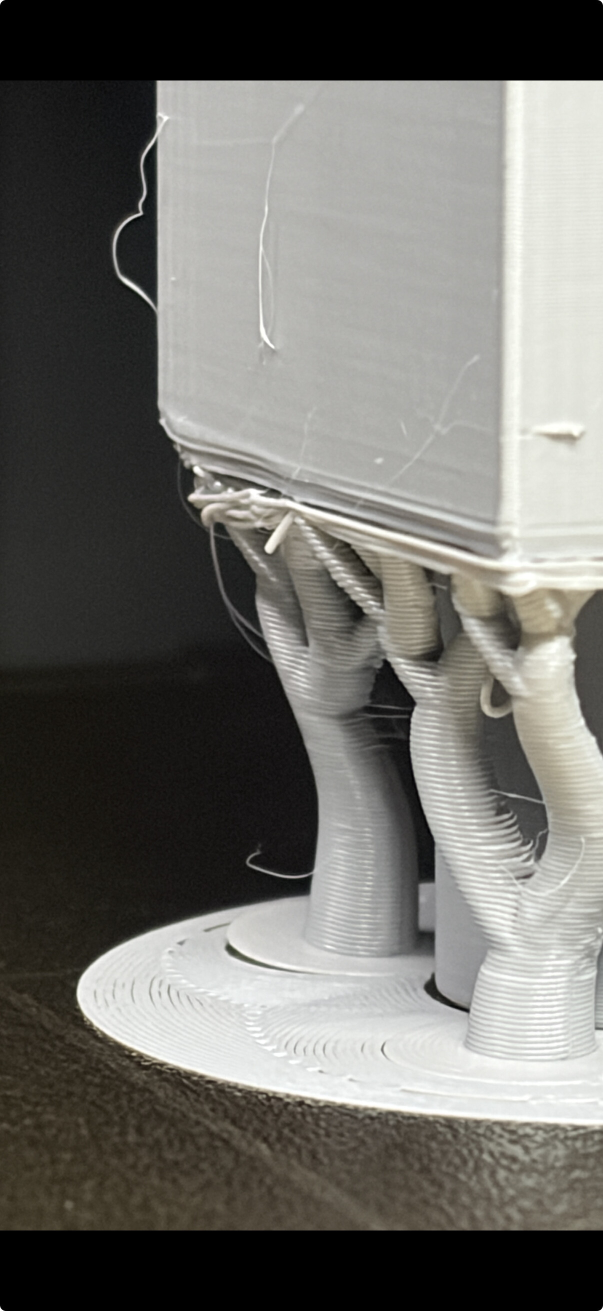

Update: An now I’m greeted with this…
Welcome to PETG printing on a Bambu Lab P2S printer… due to a support snapping, from the first layer unable to attach itself to the plate …using default settings.
I hope someone from Bambu Lab sees this and explains why this is happening on their default settings, using their very own filament. Because this is becoming really unacceptable from a brand new printer only 3 weeks old.
And I hope that update to the app, wasn’t what cause this and it’s a defect with the printer itself because if this is the level of Bambu Lab software releases to their own closed system, this is not giving me any hope, esp. in supporting this brand.

This just happened to one of my prints,
A common occurrence with Bambu and petg I’m finding out,
It’s odd, as I’m not getting the same results on the High Quality setting, it’s only when I use the Standard setting it fails. The HQ seems to be fine, however waiting almost twice the time to print something just to get the objects to print without failure is not ideal. I’m still waiting on a response from Support.
What were the settings that resolved the issue? As it may explain what’s happening, and why it’s not happening on the High Quality setting. :man_shrugging:

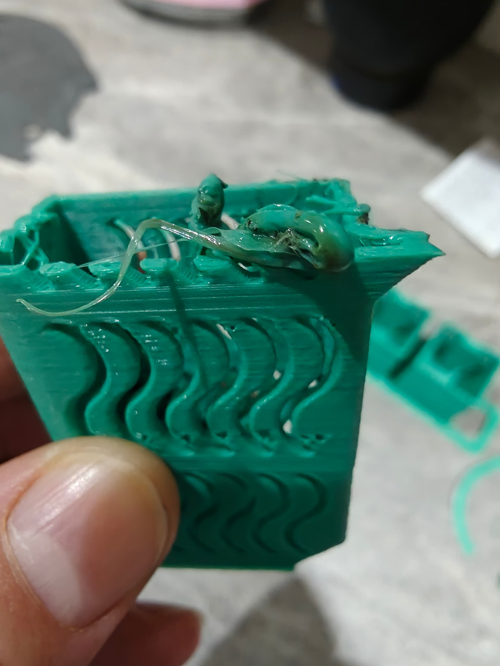

My texture bed is washed and cleaned well, I actually have the issue of prints sticking too well, not the issue of low adhesion. The clumping takes a few hours in to the print to build up after a really good clean, it then wrecks a print mid way through for me.
My PETG is dried well, the green in the photos has been dried for over 20 hours in total, and stored in a dry AMS pro 2. With plenty of silica.
The layer height doesn’t seem to effect the issue for me, a new nozzle helped a lot, so guessing the 250 hours printing finished the 0.4mm nozzle off. I expected a bit longer than it. But the issue is still there, just appeared in my next print, green blob in my black print.

The issue with heating/cooling is that bambu changed the filament setting only for the P2S for PETG, turning it from cooling to heating mode, the issue is that in heating mode you have 0 control over the fans, so the part fan is always at 0% and the right recirculating fan is at 50%, no setting in bambu can change this. You can’t change PETG back to cooling, and you can’t even try tricking the printer in to printing PLA at higher temp to use PETG. The lack of fan control causes issues with PETG printing,
By doing this they have basically made PETG printing on the P2S very difficult, the bambu PETG is not too bad, but any other vendors PETG is a no go, practically impossible to use.

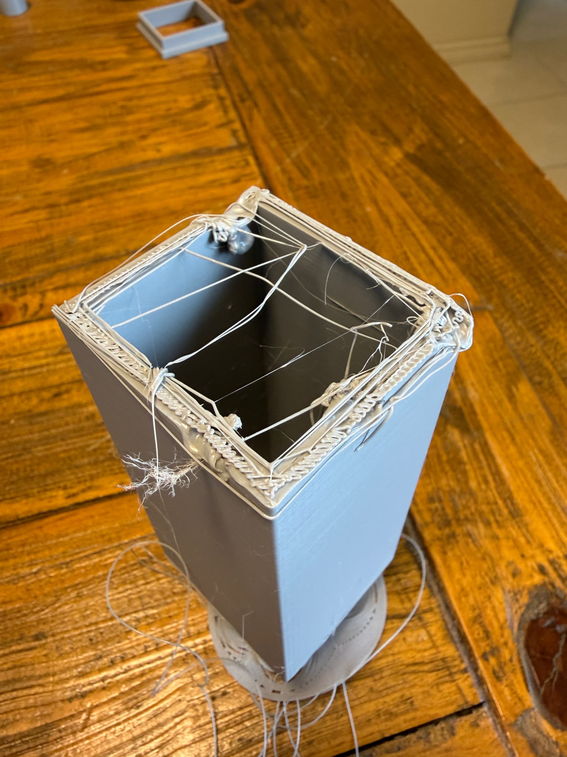

I already have a custom filament profile, you still can not override the heat setting, so fan control is fully disabled in custom profiles for PETG. The update was P2S specific only, no idea why they did it.
Even if you go to the printer and change the fan speed they have set it back at every layer.
You can still control bed and nozzle temp etc, but the fan settings are locked out.
Bambu nozzle temp works at 230, but other vendors need 250 or more, so I have a cusom printer, custom nozzle and custom filament profiles, I have friends who have dozens of bambu printers they use, even they are baffled as to why bambu support have crippled the P2S.
I have no Z hop set, wipe on retraction, retract on every layer, 0.5mm retraction, 5mm wipe, all the recommended settings for esun, or sunlu filament. Yet constant nozzle clumping. I have the right density set, right flow rate for esun etc, all fail now. If I go to the printer whilst it starts its print, change the fan settings a few times, it takes it for the first layer, gives the first layer a chance to stick,
This is now, Bambu petg filament, Bambu profile, you can see the failures on later 1
