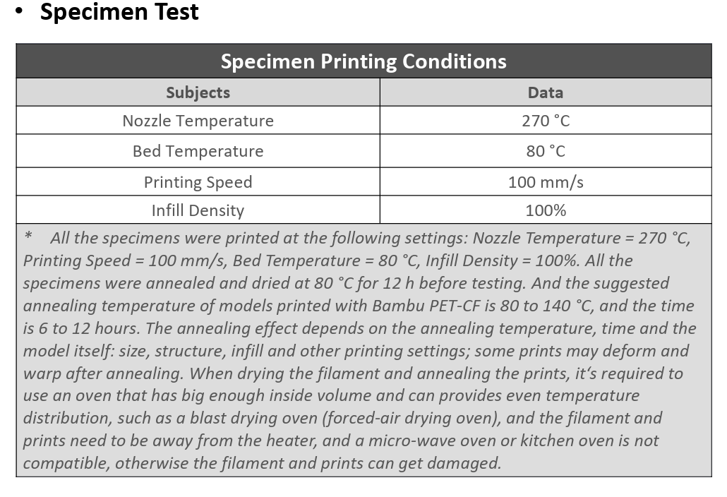

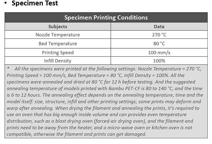

Don’t get too excited. We bought PET-CF, and they state that heat deflection is 205°C, and we needed to withstand 130°C. We placed it in the oven, and it deformed. Sadly, the default answer from Bambu is to run more tests, etc.
When you compare Bambu filament to other brands they have too good results I was wondering If it is real and yeah probably not.
Something to note, most of Bambu’s TDS data is taken from specimens that are annealed. See the TDS section at the end to confirm the method of the testing.
