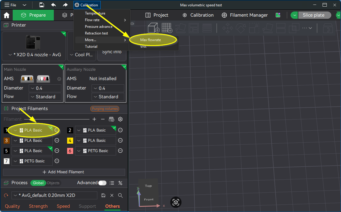

That’s really a horrible experience. I looked through the things you already tried. I think you haven’t tested yet for my last idea:
So in other words, maybe the extrusion temperature is lower than the machine thinks, causing occasional underextrusion.
To test, I would suggest a max flow rate test as I posted here:
Just one more idea, but it might be suitable to explain your and the OP’s problems.
Wish you both best luck to solve those issues!
Hey Alex,
Thank you so much for your help. I am willing to try anything new or even twice! I am going to factory reset and completely wipe Bambu studio from my system, then once I get back up and running, I will follow this recommendation.
Couple questions for you,
P2S doesn’t have a “max flowrate” calibration (that I know of). There is only “Flow Dynamics”, which sets the pressure advance (K Factors) and a “Flow Rate”. This might be a verbiage technicality, but do you know if the ‘flow rate’ test is the same as your ‘max flowrate’?
The P2S flowrate prints multiple rectangles/coupons and shows varying level of under-extrude to over-extrude, and then you pick the smoothest surface.
I noticed in your test there are 3 boxes, start volumetric Speed, End Volumetric Speed, and Steps. This isn’t present in the P2S Flow Rate Test.
Here is what the P2S flow rate test looks like Flow Rate Calibration | Bambu Lab Wiki
You will want to look at the Manual section because P2S does not have an auto calibration option for this test (they haven’t made one yet).
Ahh, my mistake! If you look closely at my screenshot, I have an extra calibration menu above the regular menu options. The regular calibration menu is further to the right.
I should have mentioned that I have developer mode enabled in the preferences. Probably that lets appear that extra menu. Sorry for missing that!
