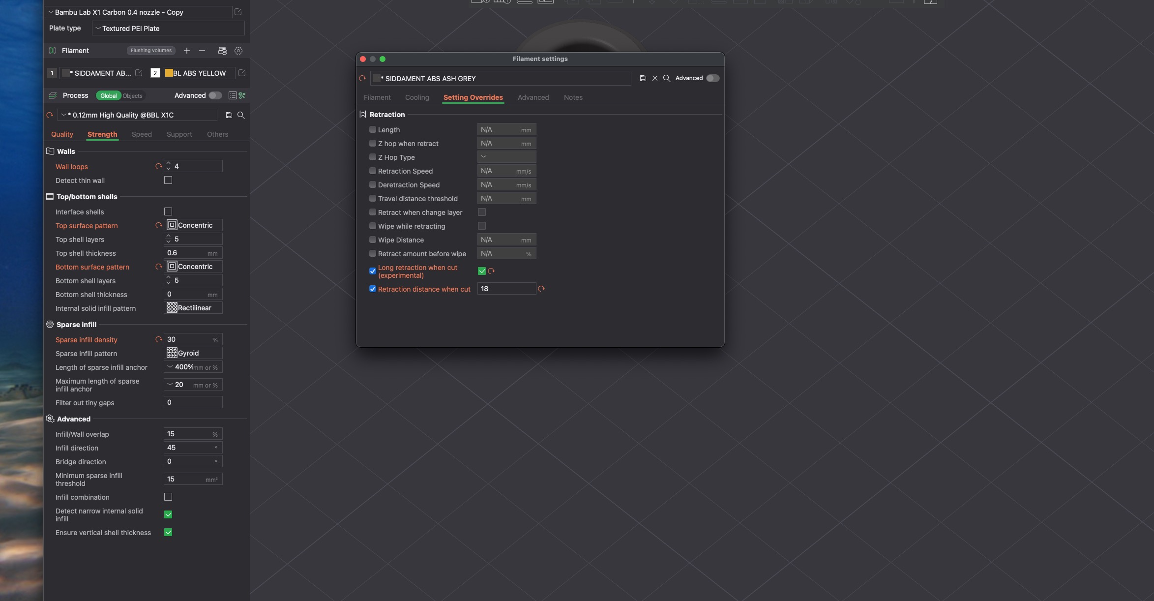

I just updated to the latest version of Bambu Studio and was hoping to use the new purge reduction. However, it doesn’t seem to be available on the MacOS version. At least I have been able to find it.
I dont have a Mac version sorry, but in Windows its under the Extruder section, in your Printer profile.
Under the Extruder section, at the very bottom, find the new “Retraction when switching material” section.
Its NOT on by default, so you turn it on - and save a new printer profile, I called mine Reduce Purge.
I don’t have that screen on the MacOS version. Bizarre!
Its in the Filament settings under the Settings Override tab.
