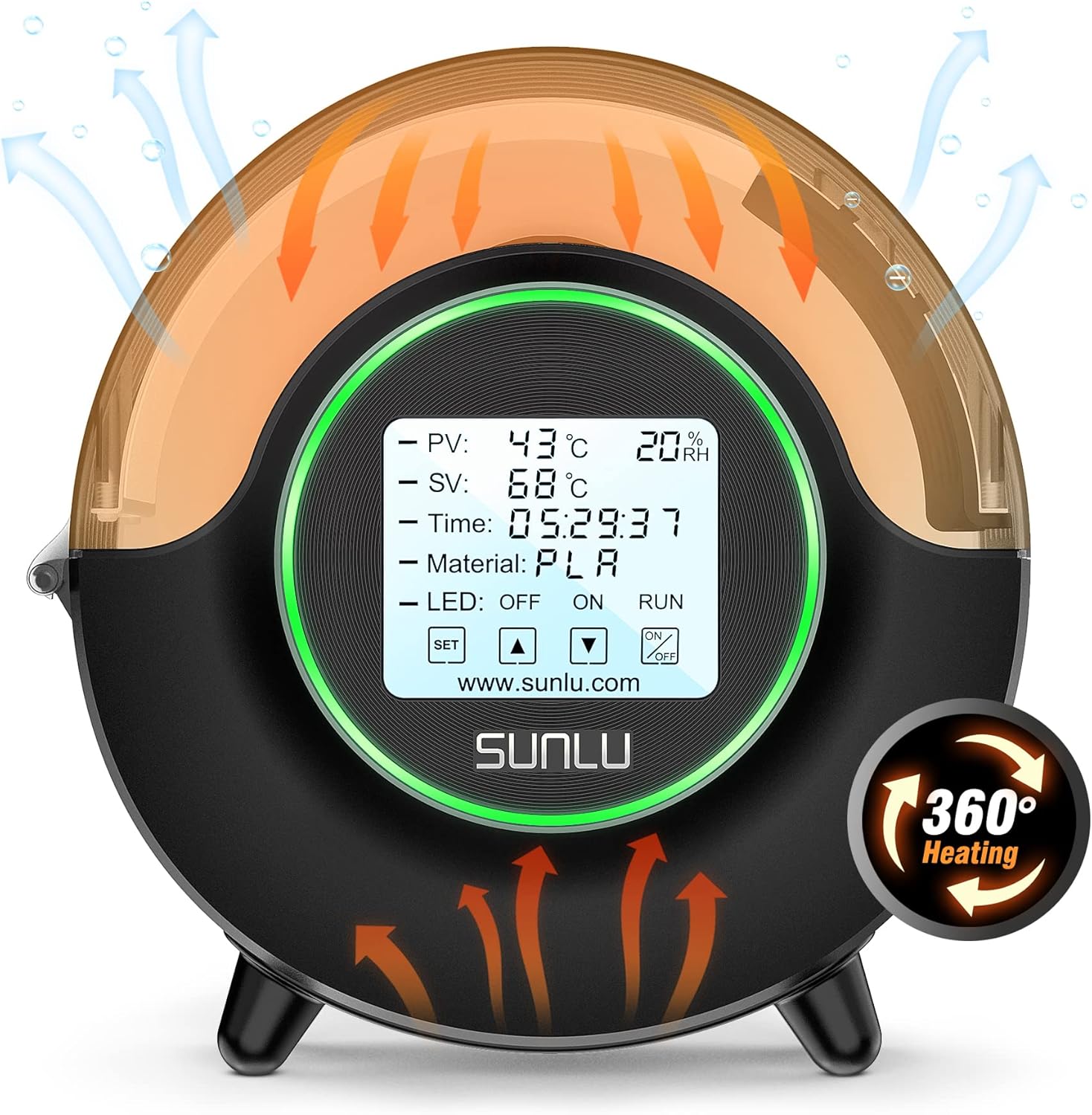

Something that would be good for you is to learn about the differences between the most common filaments, PLA and PETG, and how to treat them. For example PLA’s heat deflection temperature (where it starts to warp) is around 45-50C. For PETG it is more like 62C. Yes, PETG really needs to be dried before use in a humid environment like ours so I would point you towards the Sunlu S2 dryer which is currently £45 on Amazon. It gets up to 70C which dries PETG very effectively overnight.

And finally you recommended a filament dryer which I’ve just ordered so thank you for the recommendation :+1:

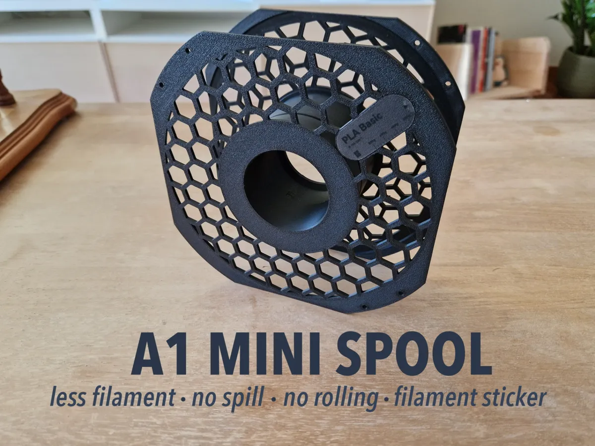

You can buy extra spools from BL or you can print them yourself. You need to decide if the cost in time and material is worth the saving in price. If you plan on using printed spools in your dryer then they will need to be PETG. If you don’t use it in a dryer then you can use PLA.
This is one spool design I’ve used that will fit on the bed of an A1 mini.
