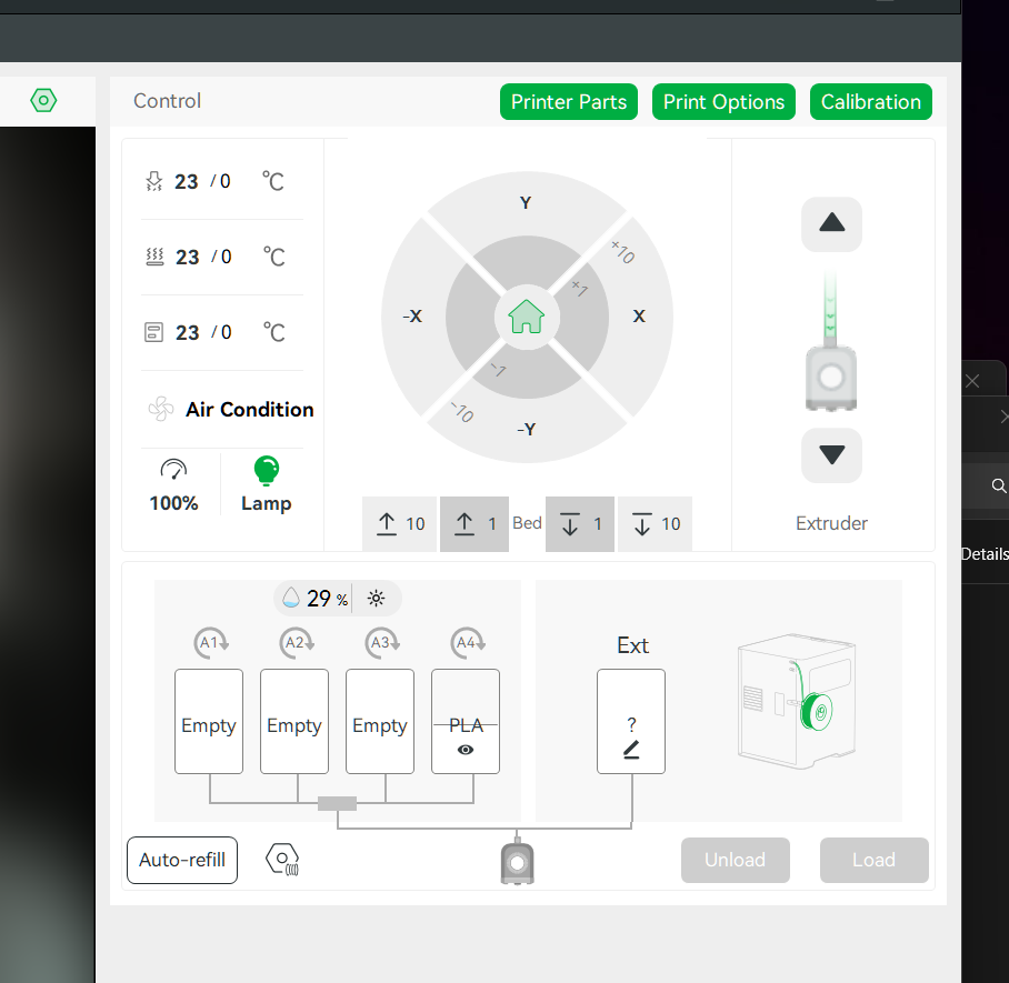

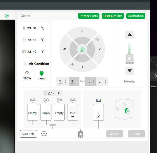

Yeah, its a bit strange, as it is not really obvious how to do it. There is one input that goes into the PTFE tube to the print head - mainly for using with the AMS 2 Pro and then there is another hole in the back for feeding in TPU and presumably the external spool.
This is what the diagram in Bambu Studio looks like, which is not really helping at all:
It makes it look like the AMS and External spool both go into the print head, but the print head only has one filament input.
