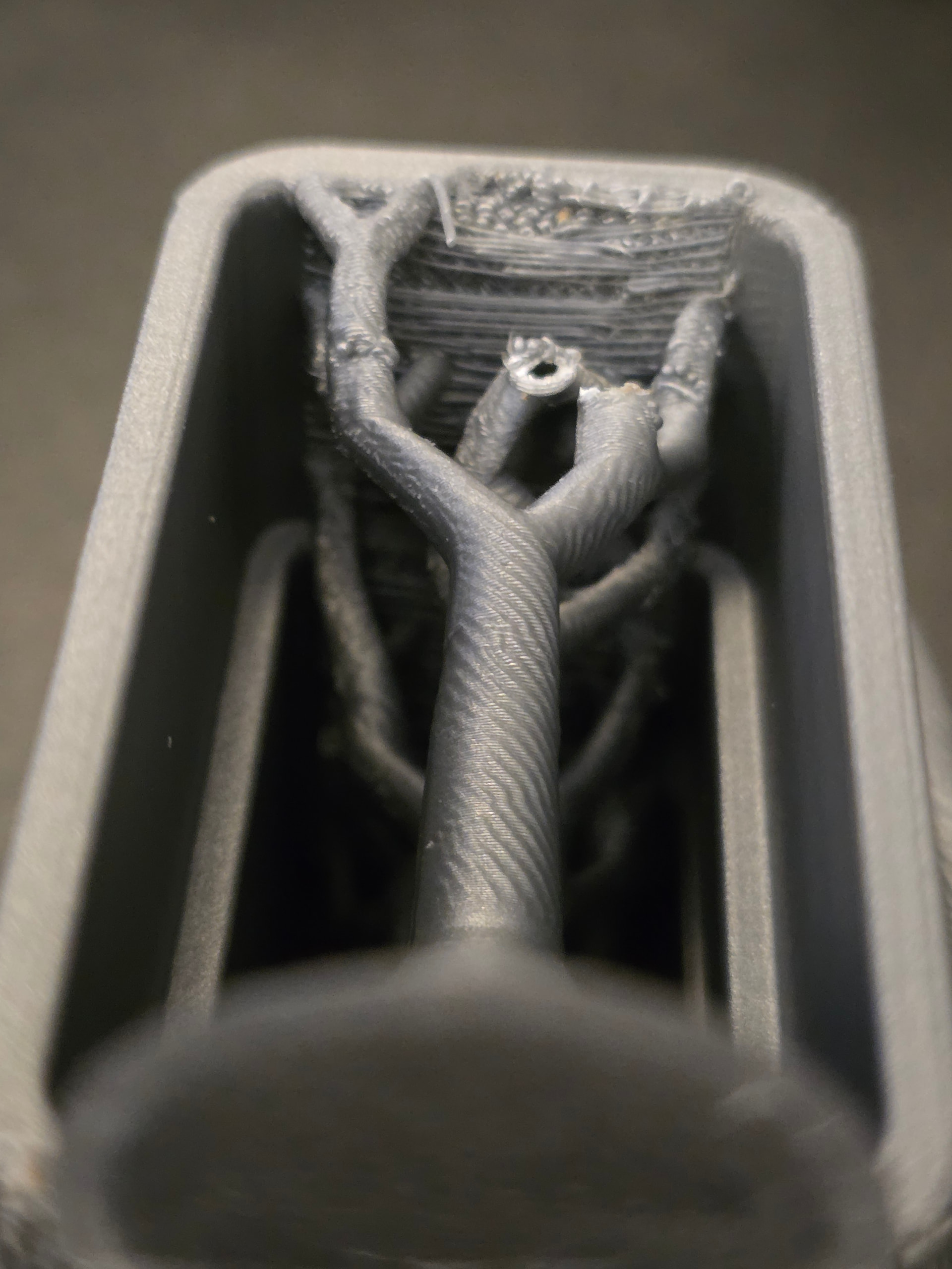

However, I then switched to BambuLabs ABS (silver). Ran a couple more test parts and the part fit to the pipe we plan to use was very good. I then attempted to print parts. Some issues:
  1. Prints completed, there was some random spaghetti issues.

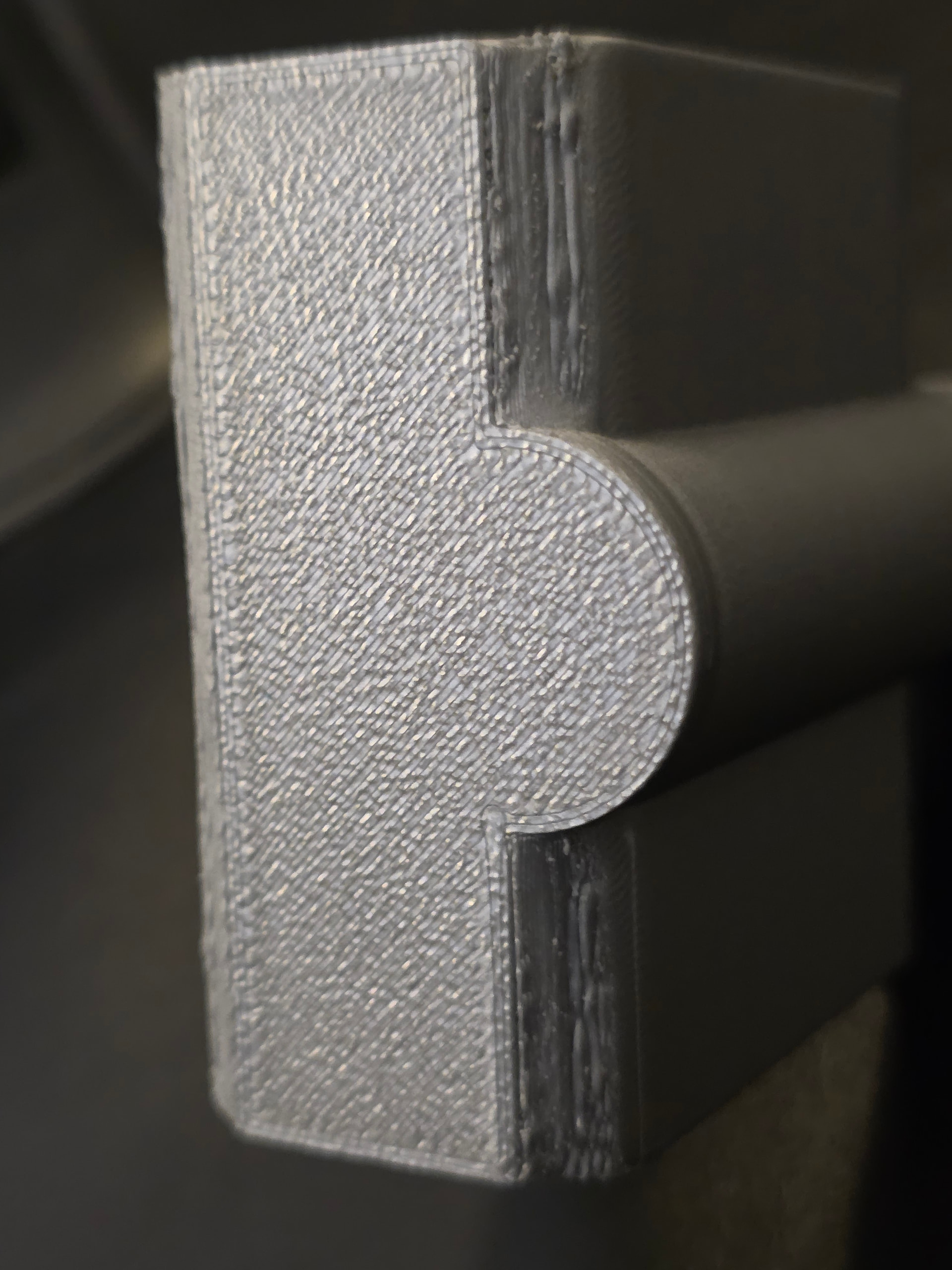

  2. Printed on bed, the filet radii had poor quality.
  3. Wall or parts need to be solid. I am sure this has to do with infill, but I am not versed in the Bambu Studio software yet. (2 weeks in)

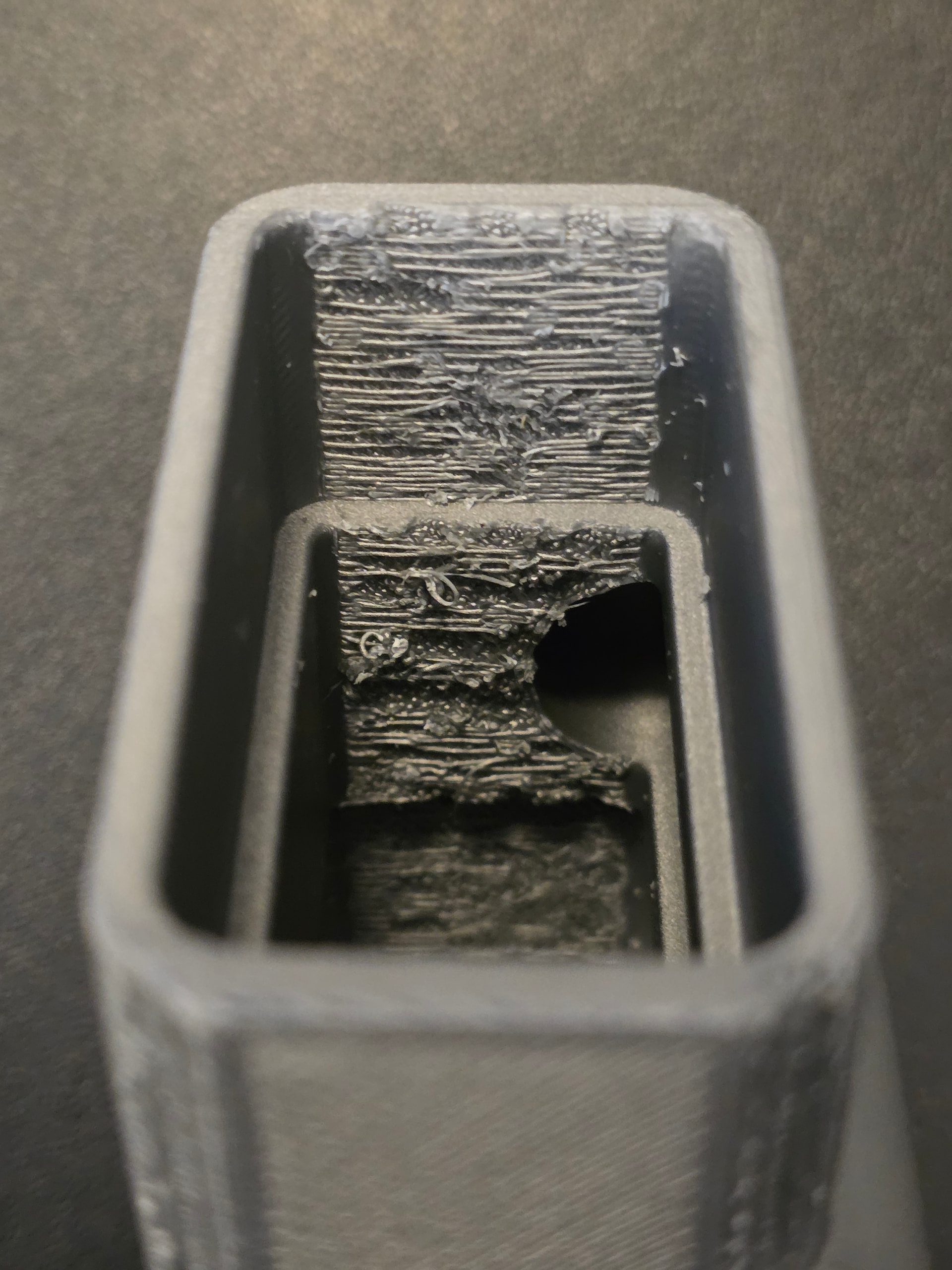

  4. Support trees are not assisting walls parallel to the plate to be built with quality/accuracy.

  1. Spaghetti can be caused by many things, you haven’t given us enough to comment on it one way or another
  2. That radius is an overhang, it isn’t possible to print those well without support. Look into “Support for ABS” and use it in your other nozzle.
  3. If you want thicker walls increase your number of wall loops, if you want solid parts increase your infill to 100%. Both are in the strength settings.
  4. Support for ABS will fix this, in the supports setting section you’ll select that as the interface materials only, it will prompt you to let it change some other settings, let it do that.

One last question… What are your thoughts of rotating the part 30*, 45*, 60*?
I’d certainly consider trying 30-45-60 angles, as printing with the hose barbs parallel to the build plate may not achieve a surface good for achieving a good seal with the hose, and printing with the barbs perpendicular to the plate creates a fitting very susceptible to snapping off.
