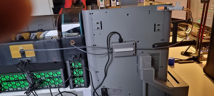

Hello, I Own a P2S with an AMS 2 PRO and an AMS HT. I want to buy the new TPU Feed Assist Module but it’s not clear how to properly connect the whole.
As you can see currently I have the buffer for the AMS pro and the HT and a Y splitter for the “manual” spool holder. My understanding: get rid of the manual spool holder, print and install all the hardware related to the TPU Feed Assist Module but then there will be enough space from the device output to the Y splitter, so how the hack should it be mounted?? The bamulab tutorial video shows how to mount it in the H2D which is a totally different story…Other than that is not clear at all where to mount the 4 pin cable…the buffer has only a 6 pin socket….any idea before buying it?
Thanks
Andrea

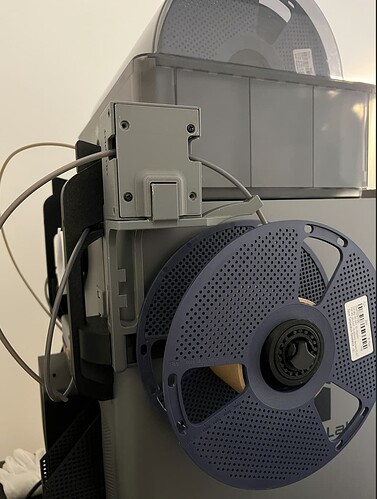

2- To answer your question, search Makerworld for the P2S TPU Feed Assist Module and you will find the printables for the P2S included in the package.
However, the thing is that BBL has not made that particular holder for the side mounted spool holder:(
I (and others) have made solutions that will accomodate the TFAM as well as a spool, and allow you to run the AMS2 as well.
Mine is based on the AMS2 pro Flipper/Riser (AMS Flipper - better access to your P1S/X1C/P2S - Free 3D Print Model - MakerWorld), where your AMS sits on top of the P2S and I have modified the Side Spool holder Side Spool Holder for AMS Flipper - Free 3D Print Model - MakerWorld, with this:
To get to this:
Please note: The mechanics for the unit are still on back order, hence the empty look.
The only issue I have with the new TFAM, is that it requires power from the same outlets as the AMS and Filter (there are only 2/two connectors available.
Just to be clear, my mod requires a remix of the original Spooler arm. But I found the original arm design so excellent I used it for the remix.
AMS2-SideSpoolHolder LH.3mf (1.2 MB) You need to download and print the spool and bearings from the original design (above).
PTFE Feeder holder for LH-Spool holder.3mf (512.0 KB)
