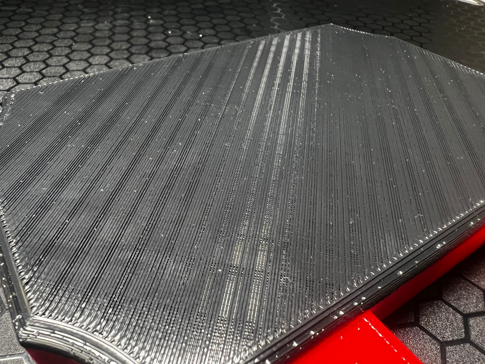

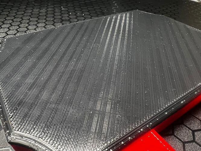

New TPU spool top layer issues
I just put in a new TPU spool and the top layer is doing this. I printed 10 of these over the last week with a different spool with no issues. Any advice? Not dry enough or….
Moisture is most likely.
You said you printed multiple copies, so you know what to expect.
If you were ruling things out, the new spool stands out if all other factors have remained the same.
