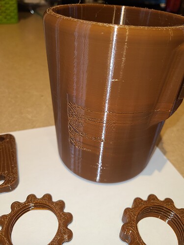

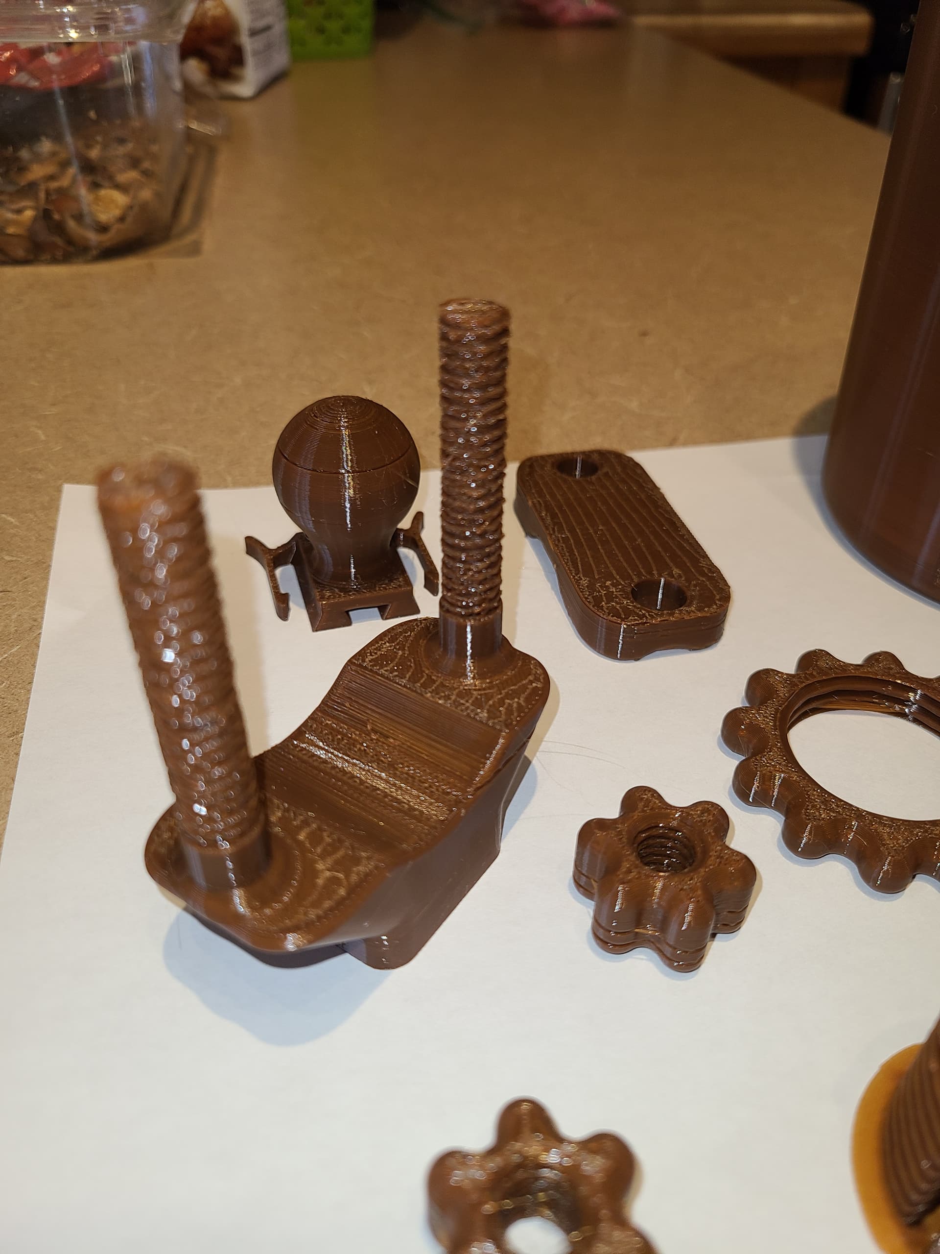

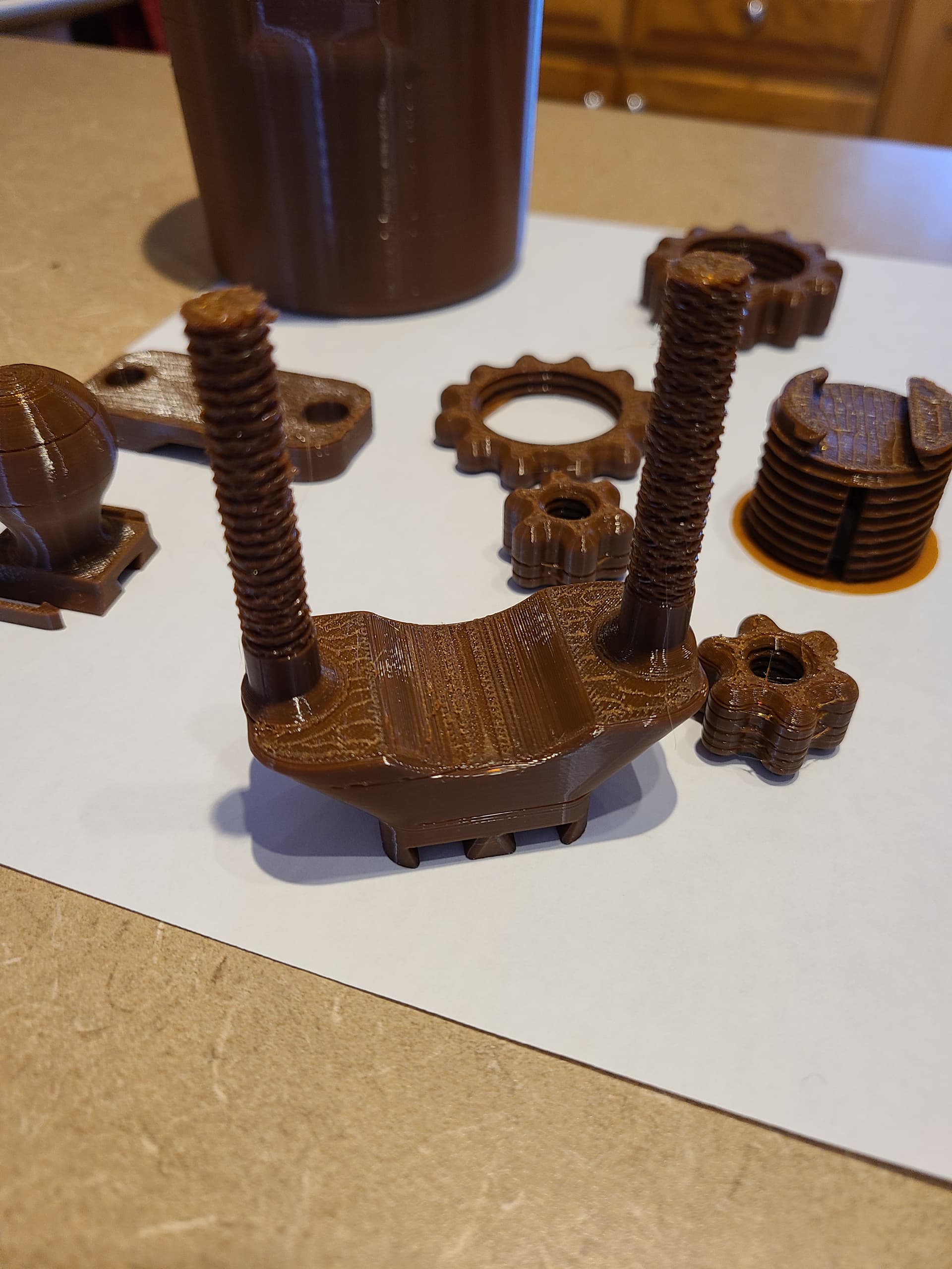

I just received a A1 printer 2 months ago. I purchased some Sunlu Petg for printing outdoor related items. I have tried to do research but there is a lot of setting in Bambu Studio and I cant seem to get it right.
Printing PLA is great but wont stand up to the outdoor elements so I am trying petg.
I am using the standard nozzle that came with the unit if that matters.
I tried using the Bambu Petg Basic, Generic Petg and Sunlu Petg filament profiles but always gets results like these for a clamp mounted mug holder.
Also I did buy a sunlu one spool dryer and use that for 6 hrs before trying to print, I did print a Ams lite enclosure and use desiccant beads to keep moisture to 10% humidity inside the enclosure with avg 70 degrees F. ambient temp in the room.
I am at a loss and if any more info or screen shots would help please let me know.
I have searched the internet but cant find anything that helps vs gets me more confused. Everyone has different parameters but just trying to get better than these pictures.
Any help would be great.
I’m a new user but I have similar issues if the PETG wasn’t dried first.
Looks like classic failure to completely dry your filament and/or over-extrusion from too high a flow setting.

I’ve been using just the BL HF profile with no issues. I agree it looks wet. I don’t see pressure advance as the issue.
