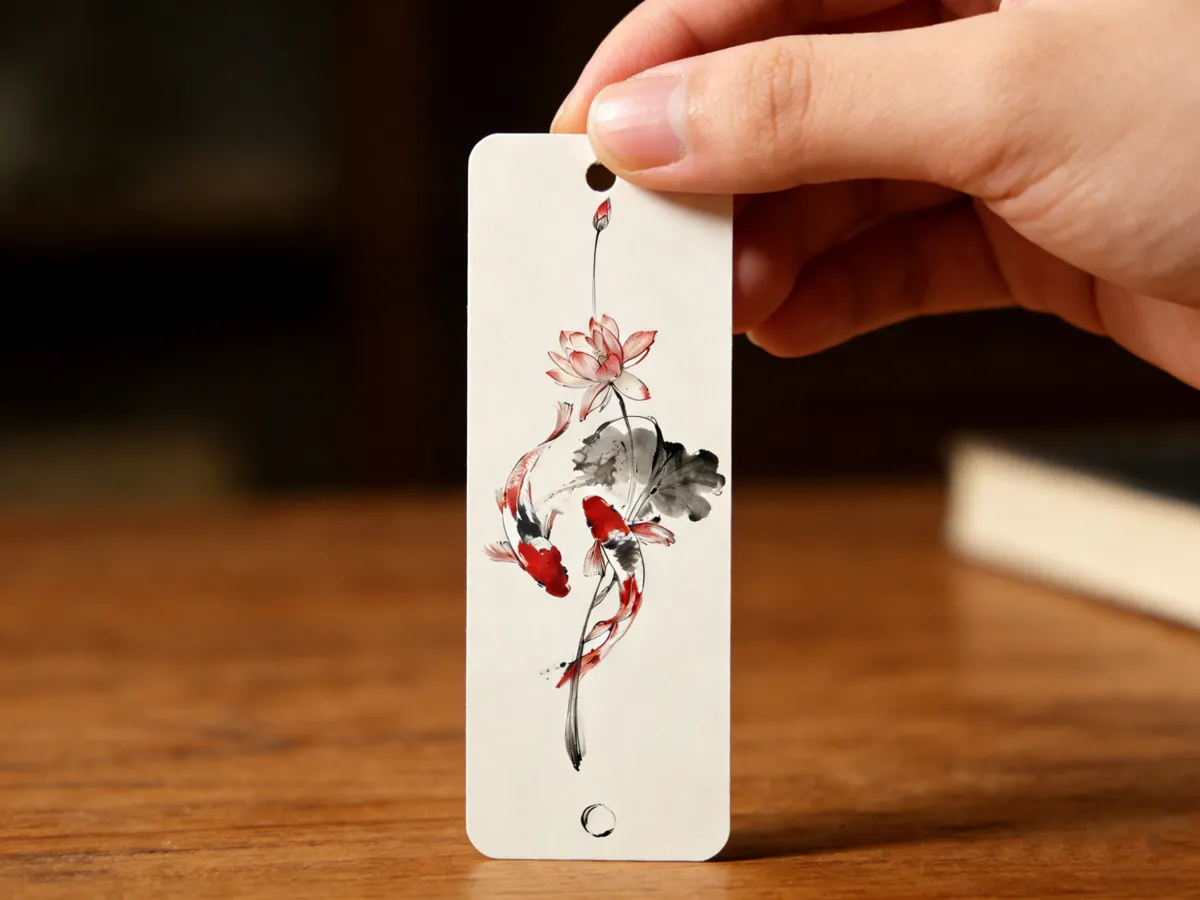

Recently, I decided to try something more advanced and found this three-color bookmark, which seemed like a good test:
I printed it using Bambu Lab white, red, and black PLA. I opened the file in Bambu Studio, confirmed the color assignments, and started the print. However, when it finished, the bookmark was almost entirely white. There were faint traces of red, but most of it flaked off. I also noticed several pieces of mostly white (with a little red) purge filament in the poop bin, so it appears the printer was attempting to change colors.
Does anyone have an idea what I might be doing wrong? I am using the standard 0.4 mm nozzle that came with the printer—could this model require a 0.2 mm nozzle instead?
Thanks in advance for any help. I really appreciate it as I’m still learning.
The profile states that it is for a 0.2 nozzle and that a layer height of 0.08 should be utilized.
I would look for a bookmark that is optimized for a 0.4 nozzle.
