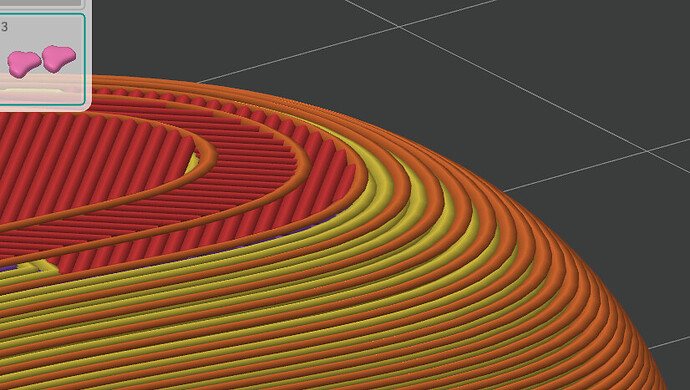

The teapot was hollowed at 2.5mm. I and split it in half in Bambu Studio. Each half section is about 211x119x50 (xyz, mm). Side A is placed off the plate. Side B sliced very well and using a 0.4mm hotend tip and will take over 10 hours without editing the default settings. I have three questions so please refer to my photos.
Here are the first two questions.
Note the areas in red.
I’m using two colors, Bambu PLA Basic black and Sunlu PLA + Smooth Silk, Light Gold.
  1. Why does the playback show white in those areas when white isn’t a used filament?
  2. The curvature causes a wider path. Someone on YouTube simply sanded these smooth. I assume this is unavoidable?
  3. The last one: I’m using “support trees”. I have heard they are okay to break off without damage?
That white line is the seam where the head starts and stops each layer, its for reference, not color. When you slice, you will only see the two colors, so you can just ignore that. As for the trees, I have not had issues with the supports not coming off, it does leave some rough edges, but other wise comes off cleanly, and the last, I would like to know myself as I have a couple prints that I would like that to be finer looking.
Aaaa, that make since! Thanks.
  1. the line of white dots is the “Seam” marker in the preview visualizer. You can toggle on/off.

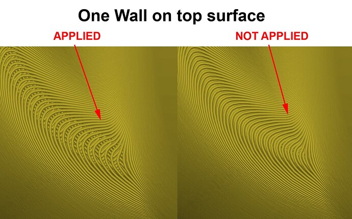

  2. That first picture topleft - The way those layers are stacking usually bugs me - Try toggling quality → walls → “only one wall on top surfaces”
    2b) You can use “Variable layer height” to also make that stairstepping less obvious, check the wiki for full docs as it has a lot of nuance
  3. I love trees! You can have an even better “snaps off easily” experience with a couple settings. This increases filament usage by a couple % but it is worth it (IMO)
Does it do anything to the actual print though? I usually see those same lines on the finished product.
It’s basically a difference between showing rectilinear fill in the stairstep vs another wall(s), which is basically concentric
I find that concentric lines on gradual slopes blend to the eye better than the somewhat obvious straight lines
Maybe GARoss can show the direct comparison, but here’s what it looks like on a model I have handy::
“Only one wall on top surfaces” Checked
“Only one wall on top surfaces” Unchecked
