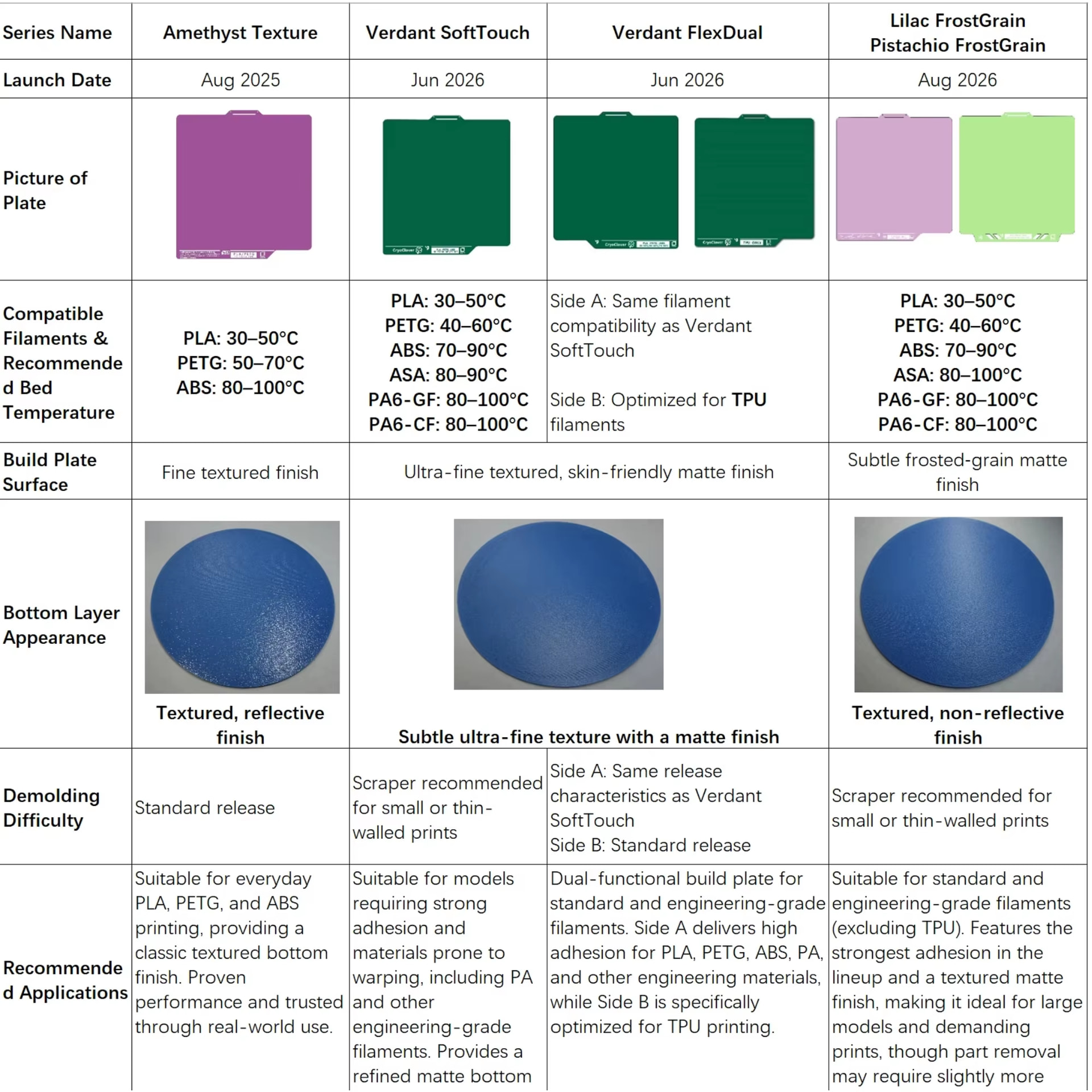

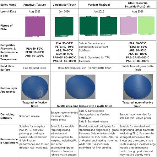

Newer Kdeavi Build plates
The purple Kdeavi build plates were known to be very similar to the BIQU frostbite plates, and a lot of people were very happy with them…
It seems they have developed newer formulations of their coating recently
https://www.aliexpress.com/item/1005012609582618.html according to Kdeavi they offer even more adhesion, and are compatible with a wider range of materials (notably PA-CF/GF)
anybody have any experience with these newer ones?
I have the green verdant softtouch version for H2C. It gives a very subtle texture, you can still see the extrusion lines but can feel small texture if you run your finger over it.
Adhesion is better than bambu supertack pro. way better than the old frostbite plates.
The correct QR code is printed, so it will detect as a cool plate.

FYI, had ordered one of the green plates for my H2D. Has arrived yesterday and so far I am quite impressed with it.
It has a nice matte texture similar to a Glacier build plate.
Note that the manufacturer lists PLA, PETG, ABS/ASA, and PA (with GF or CF) as compatible filaments.
