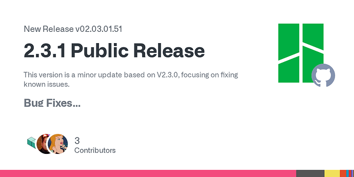

I don’t know if this will fix everyone’s crashes but the version that came out this morning lists some fixes that sound like it might help some of them.
Sorry posted in the wrong tread.
