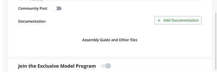

I’m looking to add NFC tags in the box of my Board Game models so that users can download a PDF file of the board game rules. I was thinking of putting a URL on the NFC tag, directly linking and opening a PDF file. Where would I store these PDF files so that they are permanently available? I’m not looking to host a site or use my own storage. I have upload the PDF files in the instructions area with my model but I don’t think this MakerWorld file download has an URL to link to. I could link to the model site, but then there is the extra step to find the PDF download. Looking for any simply solutions? Thanks
Do you mean files associated with each model being stored with each model for the users benefit?
If so, put them in the documentation section and mention them in the description.

I already have the PDF files of the rules in the download section. I’m looking to link the file directly either from MakerWorld or from another site. Ideally the PDF file would open and not have to go through additional steps to find it.
I understood the request.
  • You add the additional file to that section.
  • You click on the link from the model page
  • Copy the link from the url bar
That is your link to the PDF file.
I tried the link on one of the PDF downloads. The start of the link began with “blob:https:” and the message was “Your file couldn’t be accessed”. I tried removing the “blob” portion and got a 404 error. It appears that I can not use the MakerWorld URL. The example that I tried is on this model:
