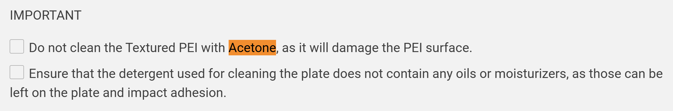

wipe with paper towel with acetone to “refresh” after washing (make sure plate is cool)
Acetone can clean the PEI surface, and to some extend re-juvenile the PEI surface.
However, on a Textured PEI plate, this is not recommended.
On a Smooth PEI Plate (which has a thick layer of PEI), you can use acetone, but also here I would advice to use with caution. To much will eventually degrade the top layer.

You might not know this since you’re new here, but there are countless posts on this forum from users who didn’t clean their printer plates with the right cleaning solution and ended up destroying them.
Just throwing out blanket “advice” without any context can be counterproductive, because it always depends on the manufacturer as well as the specific print plate. Just throwing “acetone” out there as a single sentence in the forum is simply irresponsible, because it also depends on how long you let it sit. Newcomers, in particular, tend to soak their print plate.
There’s a reason why Bambvu explicitly mentions this in their wiki - because enough users have ruined their print plates as a result.
My advice: Start by checking out the forum, learning about the chemical reaction behind it and understanding why you shouldn’t make a statement like that without providing any context. Otherwise, it’s bound to happen: a beginner will drown their printer plate in acetone because you didn’t explain how to use it properly.

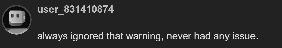

In the broader context, this also relates to your earlier advice that people should ignore warnings on the printer.
