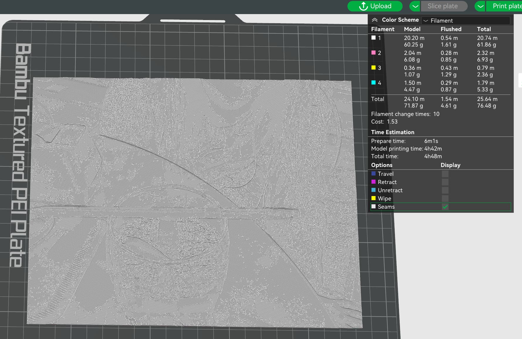

Let me put a use case for it: I am trying to add a frame for a color Lithophane. As you know, each layer has its own color and if I add a frame outside with different color, it will create too many filament change. Actually I don’t care about the color of the frame. So I want to set the color of the frame to be “random/don’t care/don’t change current filament”. Hope this help.

For example, I have a color Lithophane that need to change filament 10 times. If I add a frame to it, no matter what color I set for this frame, it will make more filament changes. If I can set this new object as “don’t care”, what I expect is that it still do 10 times filament changes, when it print the part for the new object, use whatever in the nuzzle WITHOUT changing filaments.
Maybe right click the frame → Flush options → Flush into this object.

Thanks for the suggestion. too bad it only works for objects not a part in the object.

This sounds a lot like “purge into object” as it will simply build the uncolored object out of purge and whatever is spooled up.
I need to purge to parts, not objects.
