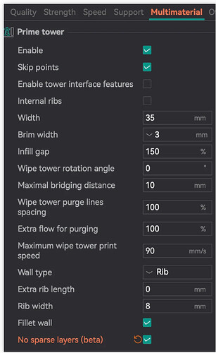

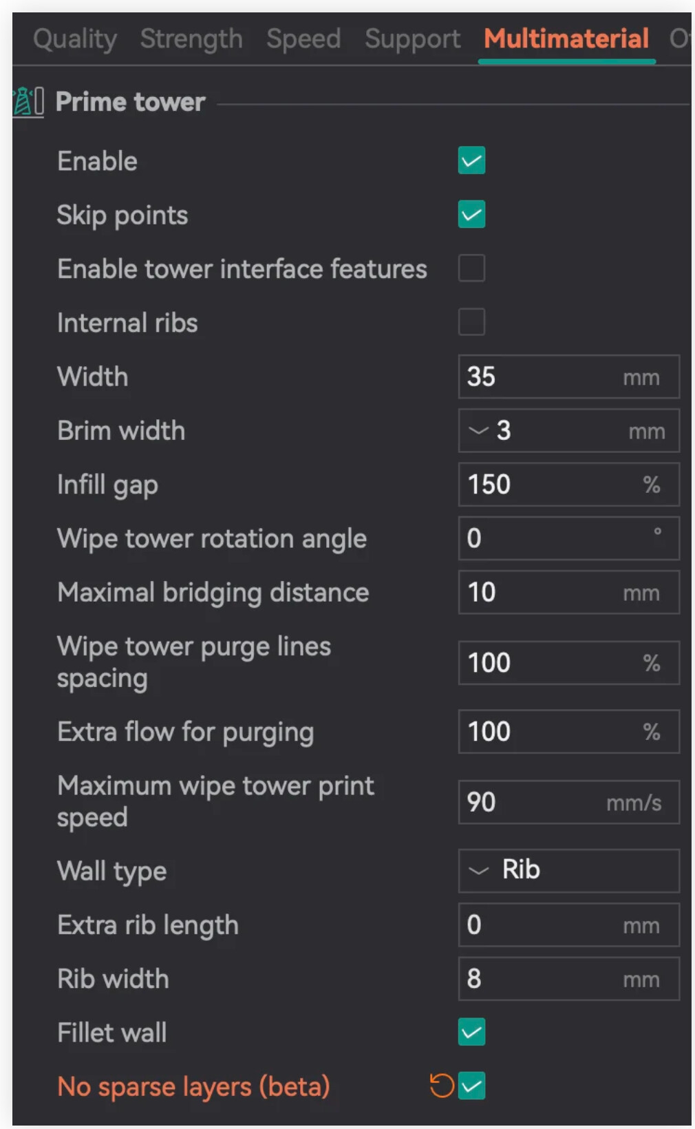

“No Sparse Layers” changes the logic of the tower. That doesn’t change the printout of the actual 3D model. Picture of OrcaSlicer; yours may look different:

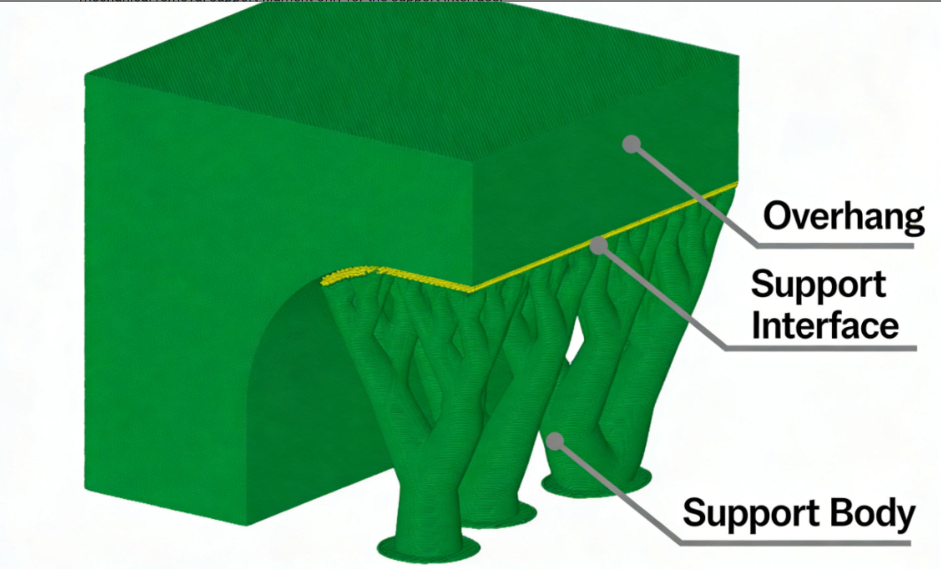

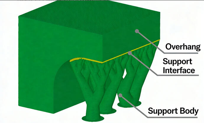

However, perhaps we should ask the fundamental question:
Why is this happening to you in the first place? Support material is actually only used as an intermediate layer (Support Interface), not to replace the entire support structure. How can that touch your print plate? That’s not even possible under normal circumstances. See photo:
But maybe there’s still some information missing. Please post a few pictures - or better yet, the 3MF file. :grin: :+1:
