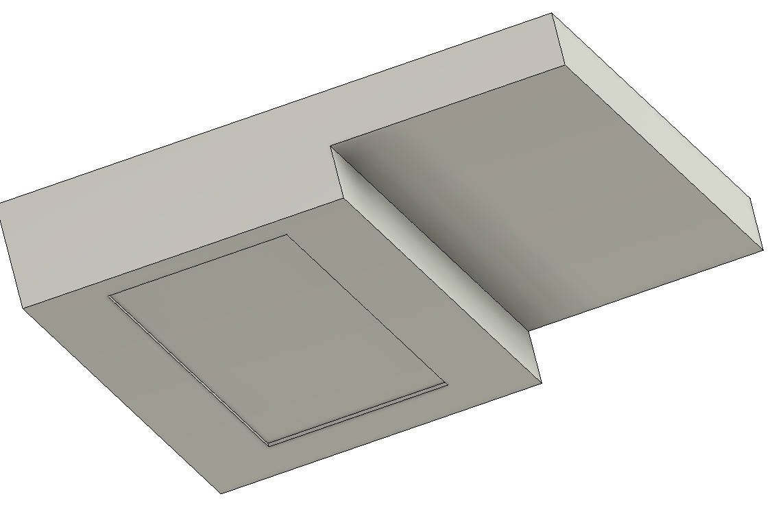

No supports generated under unsupported area
Trying to make a test print using support material. I basically have a small upside down box. I can’t get it to generate any support inside the box. Wants to bridge apparently. I do not have “don’t support bridges” checked. How can I force it?
On my real part (vs this test object) I need a small precise recess area in the face layer where I place high quality labels on a commercial product. I want a support layer of the support material (different material), so the surface finish of the bottom of that “box” is as smooth as it can be. If I let the slicer have it’s (automatic) way, it will bridge that area and it will not create a flat nor clean bottom of that box, and so my label surface will be poor and not recessed as needed. I’m just waiting to know if there are any settings I missed that would have it automatically place the support where it is needed, in my use case. Just because the slicer things it “can” make that bridge, does not mean it will result in the best quality span surface.
So far I gave up on automatic generation. If I set to manual and paint I can get them to generate. Would be good to know how to make it automatic. I will have more complex models that will be tedious to paint supports.

Edit: Very shallow recesses might not have room for support and interface layers. In that case, no supports will be generated. Try making the recess deeper by a layer height or two.
Thank you. I tried making it deeper by a lot and made no difference. Manually forcing them and it printed the FWIW. Re bridge length I have an H2D I don’t remember seeing that as an option in studio Checking, will report back ….

I see now that Max bridge length is only available with Tree support and even then is ignored if the recess is too shallow.
With Normal (default) supports , and 0.16mm Process settings (initial layer .20 mm, layer height 0.16 mm) I needed to make the recess 0.68mm deep before any support would be generated, so at least four layers deep.
With Tree supports, the Style also makes a difference in minimum recess size, so try slicing with different options before changing your model.

How deep this is changes how you can attack it, if it’s below the minimum height you’d need for the slicer to stick support structures in there [usually 3 layers], you will need to consider doing it manually with a literal Add part → cube and finetuning the sizing
I tried making it very deep. Way more than 3 layers. I’d guess 6-7mm when I tried. Still didn’t generate and support there (automatically).

I made an approximation of your model, and it performs as expected. On bambu studio (pre-auth overhaul) and orcaslicer (2.3.1-dev)
Nothing is generated in the cavity until it is 3 layers deep
And then it starts, doing what it can in the little space
[ex: 0.6mm]
[ex: 3mm]
In all cases, the first layer of the model over the supports gets a “Bridge” line type
Thanks. But not in current software the the H2D owners are forced to use.
I get the same results in Studio 2.2.0.85 with the H2D profiles. Supports are generated for recesses greater than Initial Layer Height + 2 Layer Heights, using all support types except Tree Organic.
