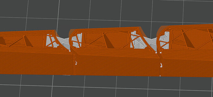

I am doing prints that combine flexible TPU and rigid PLA using the dual extruder of the H2D.
Expected behaviour: top and bottom walls for both materials on the internal interface
Observed behaviour: inconsistent top/bottom walls on the internal interface
The PLA (orange) has neither top nor bottom and the TPU (white) only has them sometimes

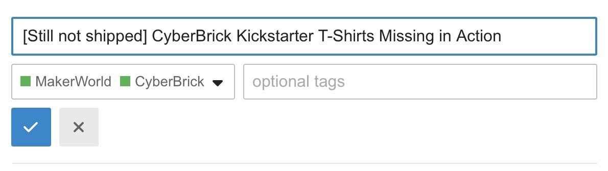

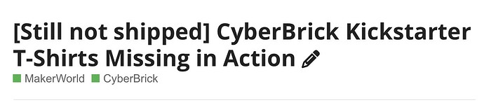

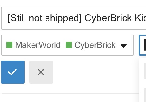

Edit your post categories (use the pencil near the title, change the second category to one with “request” in it.
The staff do not go through the forum for new feature ideas. Occasionally, they will look for feature request ones. Until you do the above, this is not one.

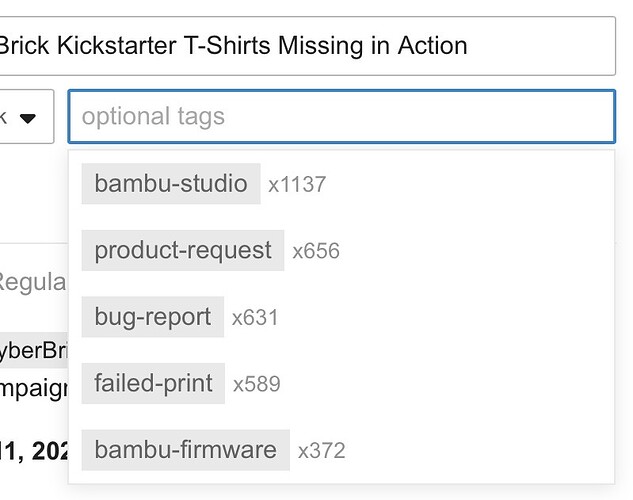

It says I have to add a feature request tag. How do I do that?
As I stated a moment ago.
Here it is with a step by step and pictures using one of my posts to illustrate the point.
I don’t have the field for optional tags and it doesn’t let me save in the request category without any tags

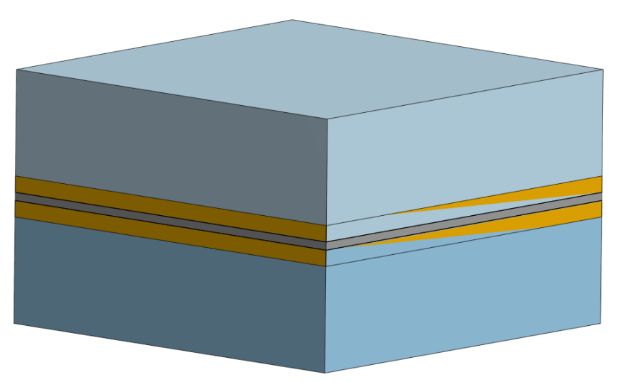

One workaround (see another solution under edit, further down) i’ve found is to add extra parts in the model to act as modifiers to force 100% infill. The 100% infill will then act as top/bottom shell layers.
Pretty sure there will be differences, and you now also have to set the top/bottom surface thickness in your cad model, rather than in bambu studio.

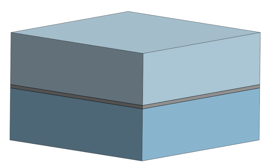

Cad file: Thin layer of PLA between the two PETG-bodies:

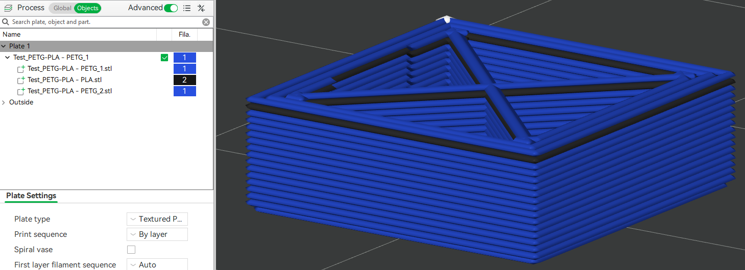

Will result in the bug (top and bottom shell is missing):
Add modifiers to cad model (yellow):
Set 100% infill for yellow modifiers. Set 100% infill for middle PLA part. I just realised one big modifier part would have been enough in this case. Anyway, result is that the 100% infill act as top/bottom surfaces:
I dont like this solution but what to do.

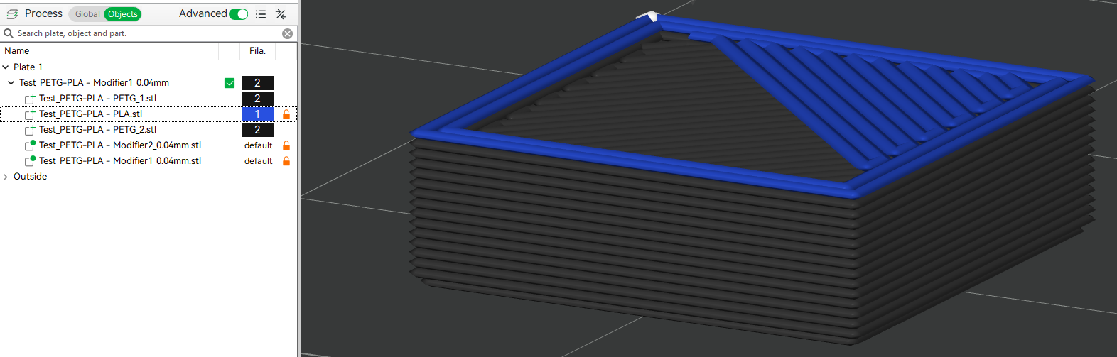

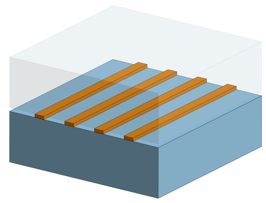

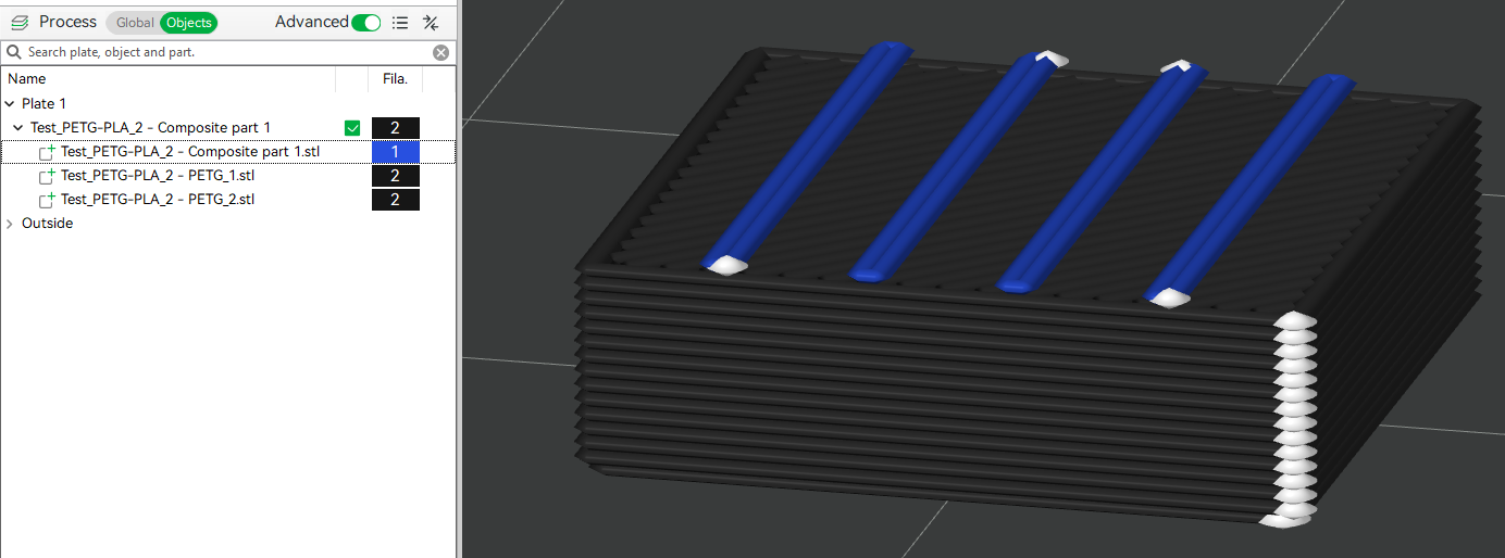

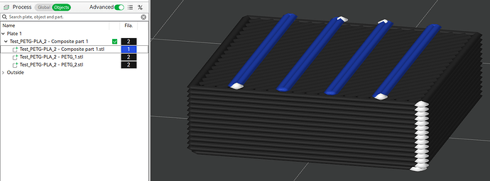

After some experimenting, I found that if the middle layer is divided into lines, it triggers the top/bottom shell surfaces to be generated again. Not sure why or how much of the middle part needs to removed, but thought it was interesting:
top and bottom surfaces now generates again, and correctly follows the top shell layers/top shell thickness settings:
I had the problem where the lines were to thin and bambu studio would ignore them. Smallest lines that worked (as in pictures above) were 0.02mm height (since that is my layer height setting in bambu studio), and 0.06mm wide (i dont know why, but 0.04mm wouldnt generate properly sometimes).
Maybe there are better ways to do this. Maybe just cutting away some holes in the middle parts also works? I might try it later, we’ll see.
