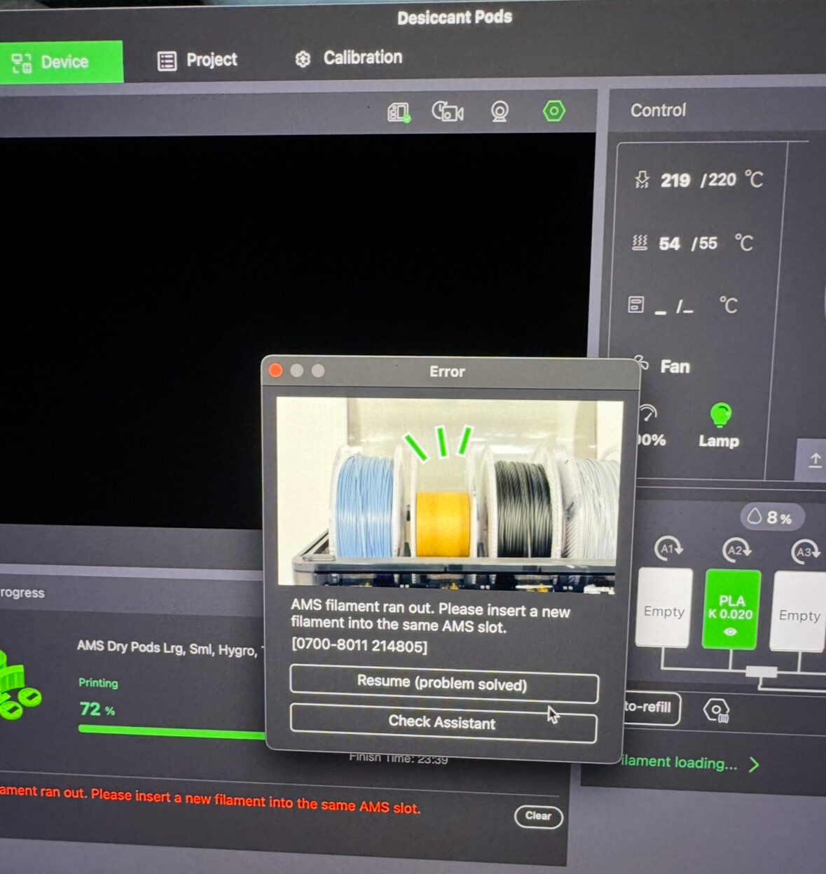

I obviously did something wrong, since at the end of spool 1 (orange) the print stopped with an error asking me to load same material type in same slot.
After moving the green spool to slot 1 to clear the error and resume the task, Bambu Studio gave me the second error about being unable to feed the filament.
Following instructions, the PTFE tube was clear and connected. I even tried unplugging the power to the AMS, but the green would not load in slot 1. Software was unresponsive.
I almost gave up.
Pressing the start button on the physical machine got things going and to my relief, the print resumed and completed!

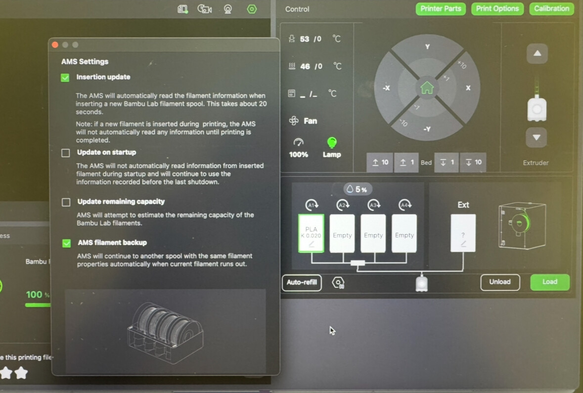

In the AMS options, did you enable the “AMS filament backup”? That is the key to automatically continue printing from a different slot
In the same place, you can choose when the AMS should read the RFID tags. I think you can turn them all off so that it completely ignores them. Maybe that would have helped? At least you don’t need to rip the tag before the spool is empty.

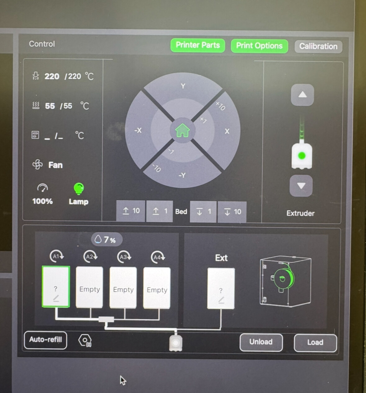

Here’s a screenshot of what i see.
Where are these options located?
Also, i have since turned everything on/off and restarted software and it is still confused about slot 1 calling it “unknown filament” even though it is loaded (and printing with) Bambu PLA basic with RFID intact on the spool.

I still have the the old BambuStudio and mainly use the controls on the X1C.
auto refill is the right setting. it is called filament backup on the machine.
For the other options: they should be behind the small screwnut button on the right of auto-refill.

Is that it?
So next time i have a spool with no RFID, I uncheck “insertion update”?
Leave “filament backup” checked
And how do I convince Bambu Studio that slots 1 and 2 have the same filament type and color, so that it performs the auto-refill?
I think this is where i went wrong the first time.
Ah, meant when you have a spool with a different filament that you want as backup, then you can disable the check and set the type manually.
As you had auto refill on, I don’t understand why it didn’t work the way you tried. To me it looks like a quirk of the software. Especially as it worked after you restarted with the button.
