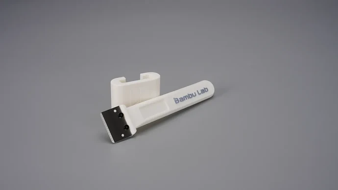

This is my first try at 3D printing. I have an A1-mini. To play around with Bambu Studio (2.7.1.62), I loaded the Bambu scraper .3mf file to play with. I saw that there were two filaments shown, white for the main scraper, and black for the logo. I only have one color, so I thought I would tweak the project to use one filament. I tried changing the 2nd filament setting and, to my surprise, it always resulted in the entire model disappearing. I tried:

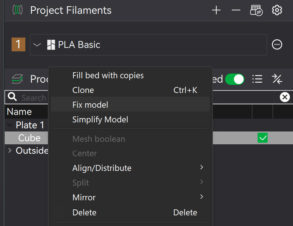

Take a close look to see if there’s a red ! next to your object, and if necessary, click “Fix Object.”

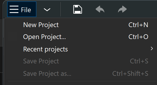

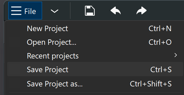

I don’t get a list of objects, just “Plate 1” and “Outside” with nothing inside them. I also can’t click anything in the preview window.
So the first thing I notice is that the file is copy-protected: You can’t save it. That’s why the object disappears as soon as you make a change.
Why? Because that’s probably just the G-code and not the complete 3MF file. That’s why the file is named .gcode.3mf and not just .3mf
The problem is basically this: You copied the finished g-code from the SD card, but you want to make changes to the project, so you need the complete project.
Download the complete project = problem solved. :+1:
