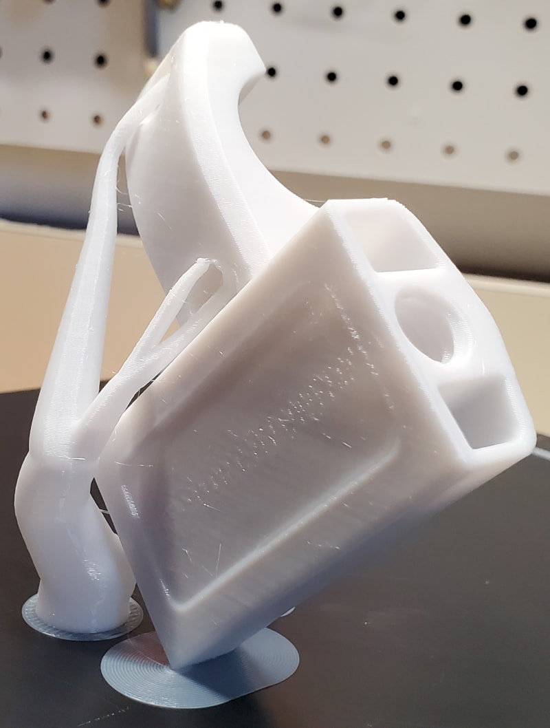

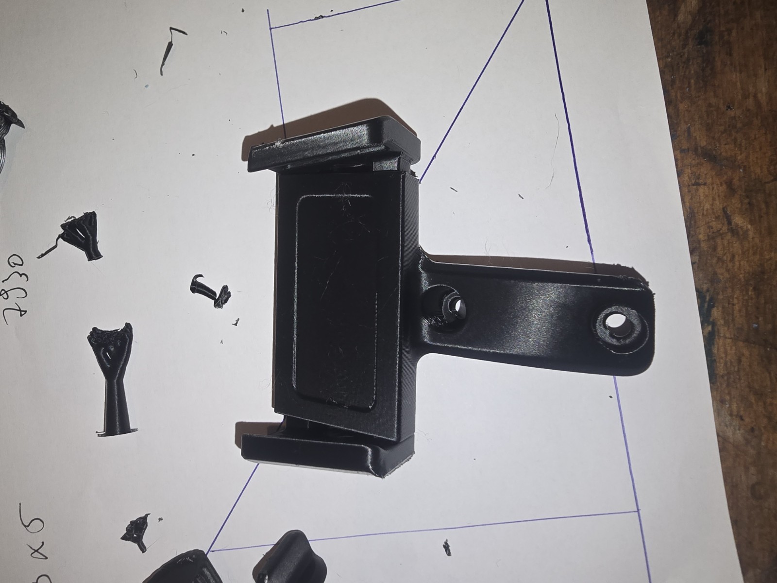

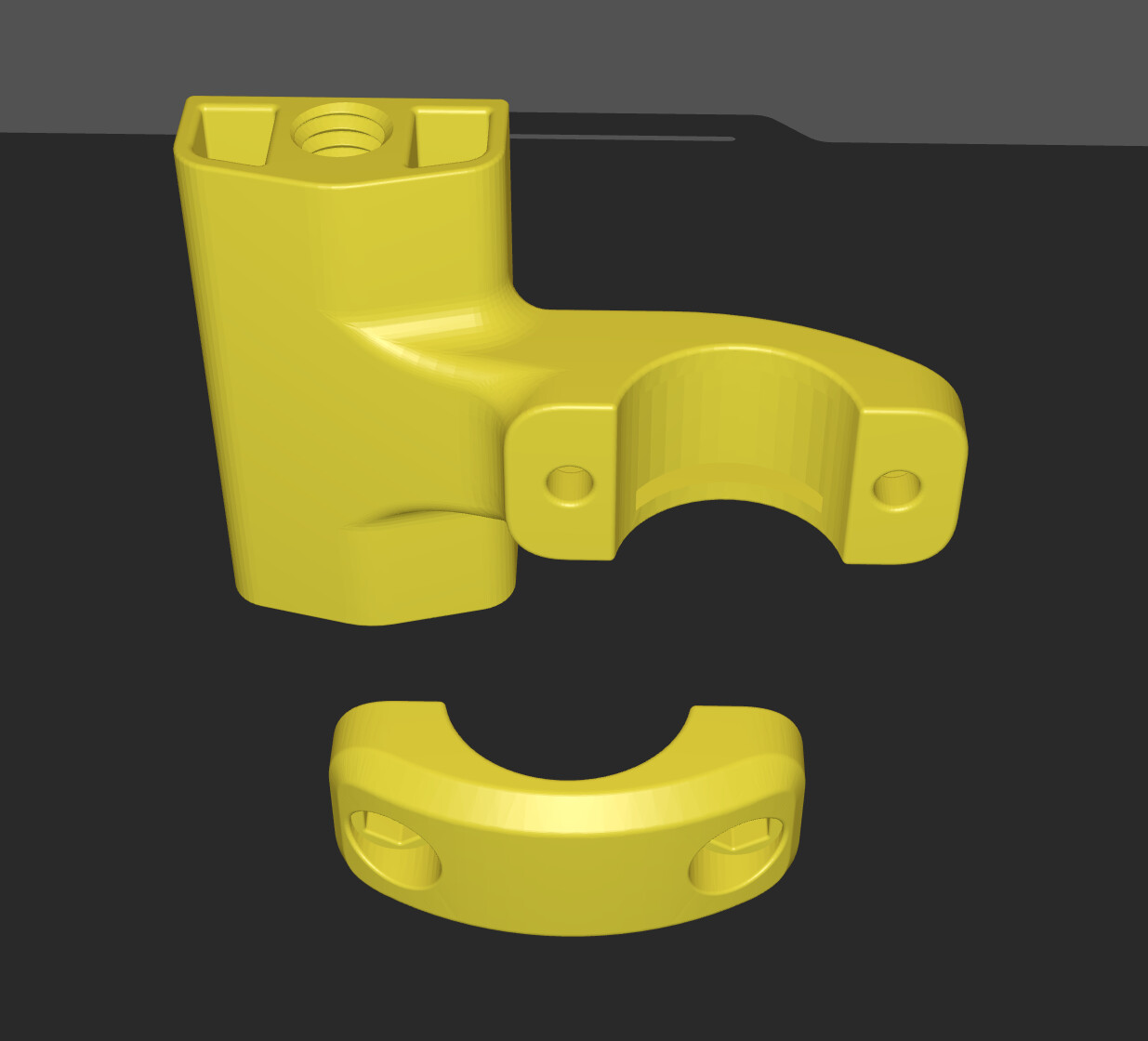

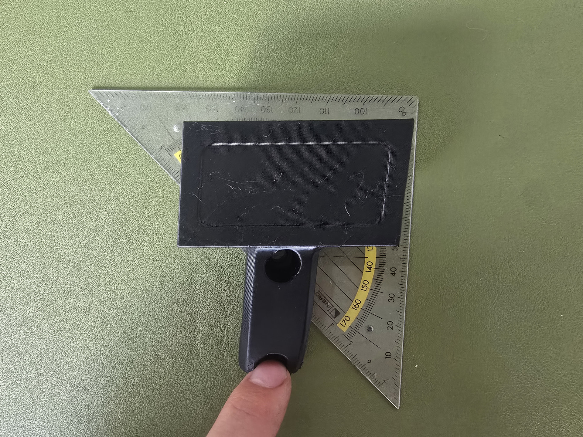

I am trying to print this phone mount for my bike. When the part is printed at an angle the corners are not 90deg anymore. the rectangular becomes a parallelogram. The other parts are at an angle as well and have the same issue. As seen in the pictures attached.
printed in petg hf with he default settings of bambu
Does anyone know how to solve this problem?

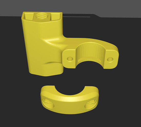

Is there a reason why you’re printing it at such orientation - which, of course, can make the problem even worse - instead of printing it the way the designer intended?
In the orientation intended by the designer, the problem shouldn’t actually occur at all, but your orientation is completely tilted, why? Why don’t you start the actual print not from the print plate?

The problem is that my printer is not printing this correctly, is it with this model or another one.
I would like to fix this deformation.
The model has not changed sizes in the slicer.
Because an FDM printer can only produce straight walls when they’re positioned upright. If you tilt the wall at an angle, the issue becomes much more pronounced.
Since a slicer works layer by layer, it simply can’t interpret slanted walls perfectly. That always leads to some degree of trouble - sometimes more, sometimes less. On top of that, you have the physical behavior of the filament, vibrations, and other factors. The designer definitely had a good reason for choosing that orientation.
I really don’t think so, because the designer must’ve had a good reason for putting the layer lines right along the line of force. It is positioned exactly so that the most critical point in the alignment - as intended by the designer - is maximally reinforced.

Printing on an angle doesn’t magically make the print “stronger”; it makes it weaker in one direction and stronger in another.
This original orientation is the strongest for the portion that clamps the handlebar; forces on that part are perpendicular to the long, continuous layer lines.
Rotating the part 45° creates shorter layer lines and weakens the bar clamp. It will break with less force, and split at an angle between layers. Layer adhesion in the phone clamp area is already reinforced by the screws clamping the phone.

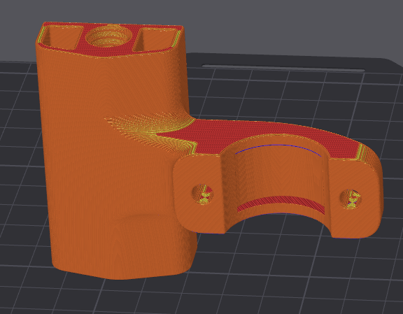

If you still want to rotate the part, leave one corner on the plate. The part will print with a brim and support only in the bolt holes, and I suspect that if slightly ragged holes were acceptable, it could be done with no support at all.
_____________________________________________________________

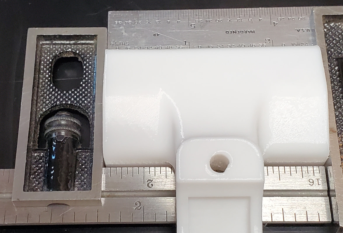

The out-of-square issue is very strange. I would have expected that much skew to also alter the height of the channels for the side clamps, but apparently they still fit.
