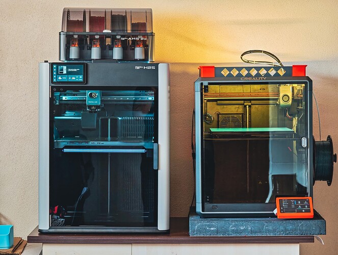

OK, don’t get me wrong. There’s no paid advertising (although some discount would have been really appreciated!), all bought on my money, and still within the 15 days return time-frame, but … There’s is something mystical about the easy-going of these Bambulab machines.
My background is… on the right side of the H2S machine! A full, old school of physics, mechanics, thermodynamics, flows, etc of a 3D printer. The squeaky toy, called K1 Moron, or more precisely just the shell of an old K1 Max, or to quote someone on Discord “polishing a turd until it becomes a diamond”.
What I am trying to say is that fiddling with and fine-tuning a 3D printer is a second nature to me and I ain’t afraid of getting dirty and OCD, but this H2S is a different animal. I will try to outline where I think it shines and where there is still work to do.
Initially I wanted a H2D but it never convinced me with its bi-extruder intricacies, despite the concept novelty. After scouting forums I was convinced to play safe and the next logical option was either K2 Plus or newly launched H2S. K2 Plus was always there, at the back of my head but so was the already extremely tiring fiddling with the previous generation K1 Max. Don’t get me wrong, the current K1 Moron (short for K1 Trident Voron Wannabe) STILL prints better than H2S but the amount of changes in its configuration and knowledge about 101% of what makes a print great is what keeps is still on my desk.
But I wanted “shoot and forget” and had zero more patience to put up with Creality’s repeated behavior of launching half baked products at the expense of paying users willing to sacrifice hair and precious time in “bettering” their turd. And I wanted to taste the apple of the 3D world. Prusa, btw. is no option for me, I love the concept but for what it delivers is both too slow and cumbersome and fiddling needy equipment.
What I like:
  • That god damn silence! This is surreal for me, since on K1 Moron I am running 0.9 steppers… Hell babe, I am still getting closer to the machine as it’s printing to hear the … silent operation.
  • The precision of its pre-print routines and how well they seemed to be tuned. Its like a Swiss watch: boringly perfect and predictable every time.
  • The rolls management in AMS2 Pro. Despite my very first print failing 5 times in a row because of a Prusament roll not playing nice with the AMS2 Pro, every other filament roll I threw in afterwards (Chinese cheap c*ap rolls, carton based, chopped, deformed, etc.) went without a hitch.
  • Consistency and ease of prints. Basically, being lazy and callous (vs a new Chinese brand!) I’ve always selected the material as ‘generic’ and hit print. Let’s see what comes and so far, I am flabbergasted by how well it behaved. Every material I threw at it (PLA, PETG, ASA, ABS and glass & carbon fiber derivatives) where printed as easy as poor man’s PLA.
  • Dynamics in full acceleration vs print quality. This is mental: that whole thing looks and behaves like a Musk’s rocket in full launch when implies maximum printing speed and acceleration without much (I will come back on “much”!) effects on the print quality, really.
  • Bed adhesion & first layer 100% right! I am still amazed of what kind of chemistry they’ve used on that Textured PEI plate that it hasn’t failed on print so far, no matter the material, speed or temperature. I am coming from the best hand made “3DLac on a textured PEI” and despite the messy nature of spraying it, it works like a champ every time on the K1 Moron. And the first layer: always right, always dependable! <3
  • The slicer. Yes, you’ve read it right. I am a full time Orca slicer boy for my K1 Moron, but it beats me why Bambu Studio got so much hate of not being able to do things that Orca does. My sincere feeling is that Bambu Studio is silently greatly benefiting form how good and predictable the printer behaves, thus some of the extreme parameters I have to use to get my other printer to print beautifully… Are simply not needed, or at least I haven’t been looking for them so far.
  • Frame sturdiness vs print quality. H2D seem to be quite plagued with Z wobbly artifacts + some loose movements in the dual extruder head and I had butterflies in my stomach until I got this thing to print a full 34cm high model to observe basically zero such artifacts. As a matter of fact, I plan on torturing it tomorrow with a full scale Eiffel Tower to see if it still copes so nicely on.
  • Speed of print. Well, before switching to a HF hotend I thought “this beast is fast and precise”, comparing with the K1 Moron. Being said that on the Creality I have reached decent to good quality at 1200mm/s print speed with 35k mm/s2 accelerations. But when equipped with the HF 0.4 hotend it turned into “fast and furious” and reminded me, yet again, that the biggest enemy of speedy printing, after the printer mechanics!, remains the very few really capable filaments up to the task (above 600mm/s) and available in the market and their fit vs the intended printed parts behavior and use case.
What I don’t like (almost!)
  • The somewhat limited possibilities to fine tune some parameters that would make the printer EVEN better. Let’s take it one at a time:
  1. Pressure Advance tuning: While the PA can and (people, please!) MUST be tuned for each filament, more so when using a HF hotend, I found it a bit finicky in respect to how it behaved. I have a feeling that Bambulab is using quite an aggressive “smoothing time” parameter together with the PA value, thus resulting in some not so SHARP edges and loss of overall crispness of details in prints where such details are abundant and needed to outline the print quality. This was and still is very obvious when I print a Voron test cube: perfect surface, stellar overhangs but quite mushy edges. My K1 Moron reigns supreme in this area and the prints speak out to themselves.
  2. Measuring and Managing Resonances. While the results are showing some good and subtle implementation, it is far from perfect. There is a total lack of transparency on the shaper parameters used to tame the vibrations. I know this is engineering trouble and contradicts Bambulab philosophy on being easy going on their user HOWEVER, VFAs are still there and there is enough opportunity to make them far less visible and prominent in prints, more so when they happen at speeds and acceleration where they shouldn’t be an issue. I guess that a future advanced menu that would allow users to see a shaper graph and be able to use one of the available vibration reducing functions / algorithms would be a God’s given and would make the printer a rocket!
  • I still hate and have zero trust to the Chinese cloud. Luckily I don’t print IP derivatives to worry to much for but I find it stupid and outrageous having to release a H2D Pro for a shameless price / extra margin just to be able to give some chosen / rich people the peace of mind of privacy and IP protection. Shame on you Bambulab!
That’s all folks! Happy printing everyone! :heart:
