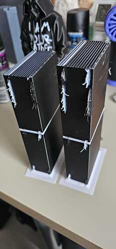

I dried the PLA for 10 hours today at 50 degrees Celsius and will now try printing again. I can report back tomorrow morning whether it was due to the humidity.
I was only able to complete the print today because I put magnets on the primer tower right at the beginning. It was wobbling a lot and had already come loose on one side. So it’s not a drying issue. It must be Bambu and the studio.
The right tower is the undried filament, the left is the dried PLA. It was 50 degrees Celsius for 10 hours. The humidity in the AMS was 17% and 13%.
I’m having the same issue, possibly related to the latest Studio update. Same dried filament is now suddenly oozing and creating spaghetti on the prime tower.
