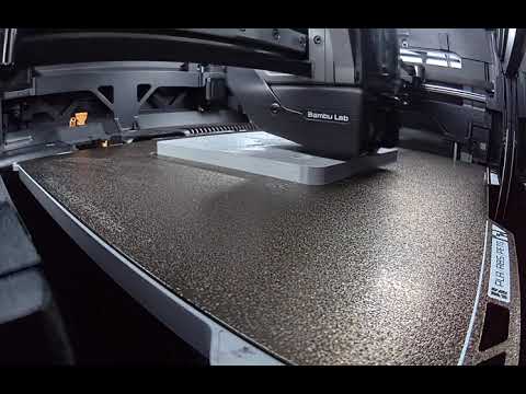

I noticed that, when printing ASA or ABS the nozzle cam just turns off while printing.
It turns on ever few minutes for a few seconds and then turns off again.
This only happens when printing with high chamber temperature.
Printing PLA or PETG does not cause it to shut down.
Does anyone else noticed this?

Yeah, the nozzle cam cant be viewed, its only used for ai detection. But the nozzle cam has a built in light that you can see under the printhead and that is shutting off in my case. So i assume it shuts off the whole nozzle cam

Here is a video of it happening.
You can see the light of the nozzle cam under the printhead reflecting on the part and buildplate.
At 0:23 you can see its turning off
At 0:56 it turns on again
At 1:17 off
At 1:45 on
At 2:05 off
At 2:25 on
And it happens a few times more i guess you get what i mean :smiley:
My fear comes from this only happening while doing high temp prints with 65° chamber temp. So maybe something is overheating?

I received and answer from support that this is normal behavior.
That’s the answer I got:
since the H2D nozzle camera will be closed if its temperature is over 85 degrees, and it will be re-turned on once the temperature is lower than 83 degrees.
Hence, it will open and close with the high-temperature printing.
So I guess there’s nothing to worry about :slight_smile:
So all the ai nozzle cam stuff is effectively disabled for high temp prints? Seems like an area that could use some optimization in the next hardware update. A camera that can handle higher temps reliably.
Yes and no. The constant on and off occurs mostly when the head ist still near the build plate, after around 6-7cm build height the cam didn’t shut off anymore.
But even when its overheating it still switches on for a minute every 2-3 Minutes, so that’s enough time to recognize problems.
