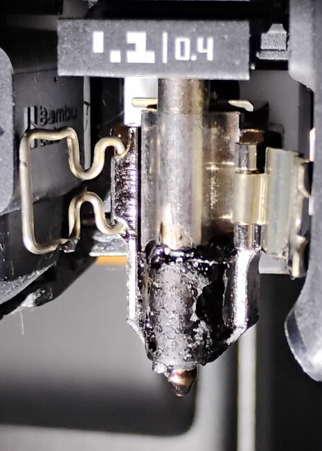

Nozzle covered in PETG
I’ve had lower qualities on my print lately so did some maintenant on the printer. The nozzle (Hardsteel .4mm) was covered in what I assume is melted PETG. So much so that it was stuck and I had to heat the nozzle to pull it out.
I couldn’t find any mention of that anywhere. Is this a result of a lack of maintenance ?
I’d appreciate any insight on what went wrong.
Happens on my A1 min as well, no sign of it (yet) on my relatively new H2C.
PETG clearly sticks quite well to steel; I wonder if it’s wicking upward via the small gap between the hotend and the silicone sock?
It seems to be the issue indeed, but I’m perplexed by the lack of result I find online about this issue.
How are you cleaning the nozzle on your A1 and how often ?
PETG loves to pick up water. When moisture content gets too high, uncontrolled extrusion driven by the steam and possibly filament rheology changes from the moisture cause it to curl somewhat as it exits the extruder. Bits can curl enough they reach back up and touch the extruder and stick.
Then other fun things can happen which it looks like you are on the edge of. Search for “encased extruder”. Here’s a post with a photo and not the worst example posted here.
Even more fun is the filament strand after it reattaches to the extruder can act much like a lava tube where the outside hardens some but inside it’s just a channel to pump molten filament up and around the extruder. There have been amazing examples of that posted here.
It happens a fair amount with PETG and really seems to happen with filament with too high of moisture content.

There was a “white residue” inside the silicone cover, but I attributed that to the cover reaction to heating. But I didn’t see any residue on the nozzle itself.
I keep my PETG in the AMS 2 Pro but I also have an AMS HT that show 30% humidity when it’s not running.
Do you suggest I should run the PETG from the HT running at lower humidity ? Or does it just mean that I should use newer desiccant (mine hasn’t changed colour yet)?
Thanks for the informations and the detailed explanation, it looks like you identified the issue correctly.
On a side note, I didn’t manage to clean the nozzle completely. I decided to use a new one to avoid the PETG sticking to itself again. I’ll see if I can salvage it somehow but this is not the primary issue.
I don’t know the details of the AMS HT but drying is a slowish process. If filament is spending much time at 30% humidity it will tend to move to whatever moisture content that corresponds to. My experience with PETG HF is that’s too high, though. Just putting the spool in a lower humidity environment to print won’t have enough time to make much difference in filament humidity. Standard AMS units don’t really dry filament though that can happen over time but it’s very inefficient. It takes heat and the new AMS units to do much drying. But I’m not familiar with the HT. Maybe it dries?
To be clear, the color change isn’t really a go/no go change. You’d need to check the specs for your desiccant to see where the color change occurs. If you’re lucky that will be where filament goes from printing well to not printing well but it may even be likely it’s not.
If your AMS is at 30% humidity, my advice would be to change that desiccant and re-dry the filament before it goes back in. In my experience 30% humidity is too high especially with PETG. Desiccant can also act as a water source if your filament is more dry than the desiccant. You don’t want that.
I thought the whole point of the HT was to dry filaments. The premade setting to dry the PETG-HF takes 12hours, but I don’t know how effective it actually is.
Anyway, I ordered new desiccants and I’ll be changing the bags with printed container to fill the AMS has much as possible. According to my research, this should lower the humidity quite a lot already. And going forward I’ll monitor the humidity instead of the beads, it does make more sense.
