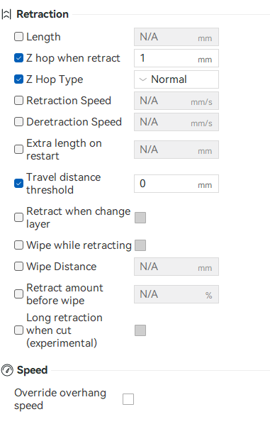

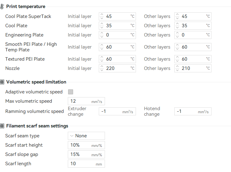

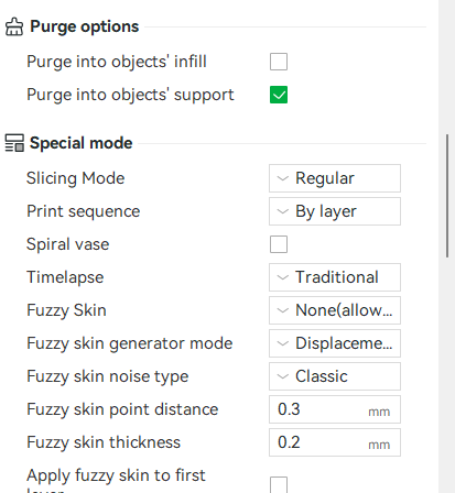

Here are my settings:

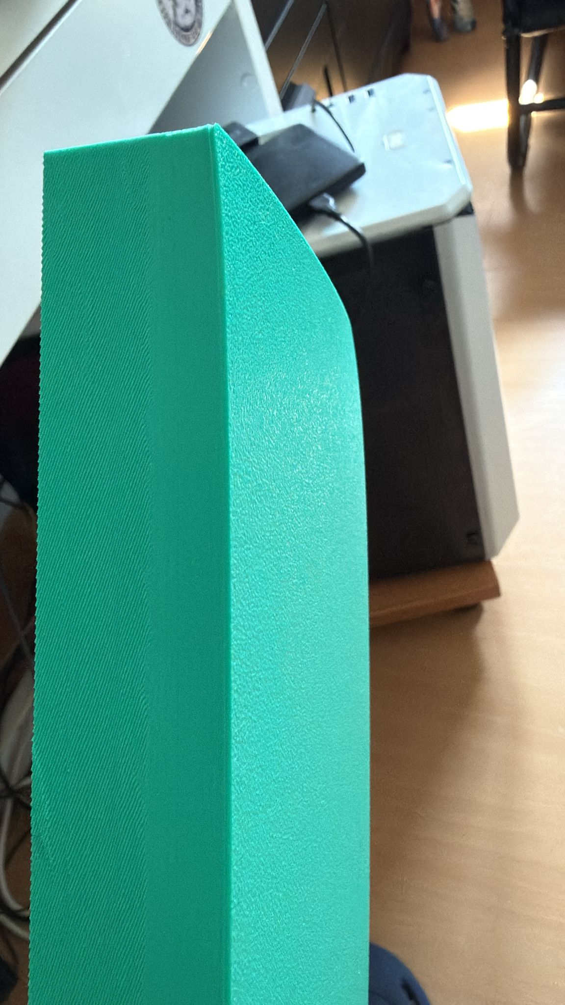

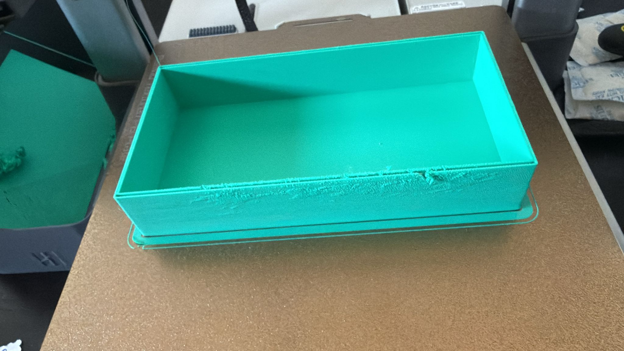

Let me show one piece that can demostrate my issue clear:
This is the piece I am printing, in that left vertical wall you can see the damage the nozzle is doing:
But the other side seems ok:
This happens with other printings, sometimes not that serious and pieces are usable (but not perfect) while other times, like in this example, are unusable and I have to stop the print.

Hi,
Hard to tell for sure from the photos, but could the print be warping, not staying flat on the plate while printing? That box shape in particular would typically be prone to warp. As the edges lift off the plate, they become taller than expected, and the nozzle starts rubbing on the previous layers. This would be more prevalent on outer walls since those solid sides would also tend to warp (lift up) more than the thinner/less dense center. And the taller an object, the more that becomes an issue (especially if the part keeps warping/lifting more as the print progresses).
If I’m right and this is a new thing (same part(s) used to print fine), perhaps the plate needs a wash (or roughing up or replacement)?
Cheers,
-Max

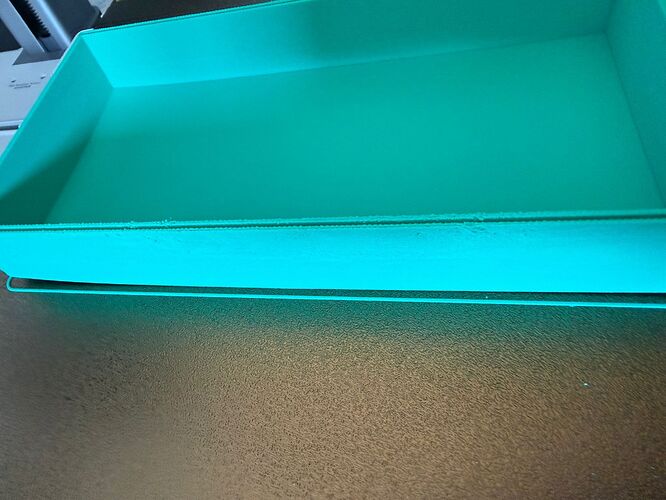

Hi! Thanks a lot Max for your answer.
For sure, at least in this piece, it is warped:
But it is weird that I’ve tried this model like 2-3 times to print and always de left part is the “damaged”.
Plate was previously washed and then applied a bit of hairspray to extra stickiness. But yeah, still warped.

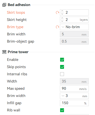

Actually, I tend with me pieces to use Brims and I haven’t used them in this model. Next try I’ll try with them. What else can I do to prevent warping?
That’s rather banana-like, indeed. :slight_smile:
A brim should make a significant difference. It’s not that unusual that it lifts from the same side every time, because… physics. :slight_smile: I’d maybe check that there isn’t a cold draft (or similar) on part of the plate (like from an A/C vent perhaps).
Avoiding warps in general is quite an extensive topic in itself. There’s a very comprehensive post about it on these forums, which is probably a good place to start: Large Prints: Say Goodbye to Warping! There are certainly other resources out there about it, and of course the issue isn’t unique to BL printers.
-Max

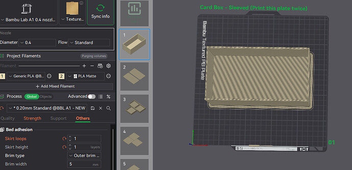

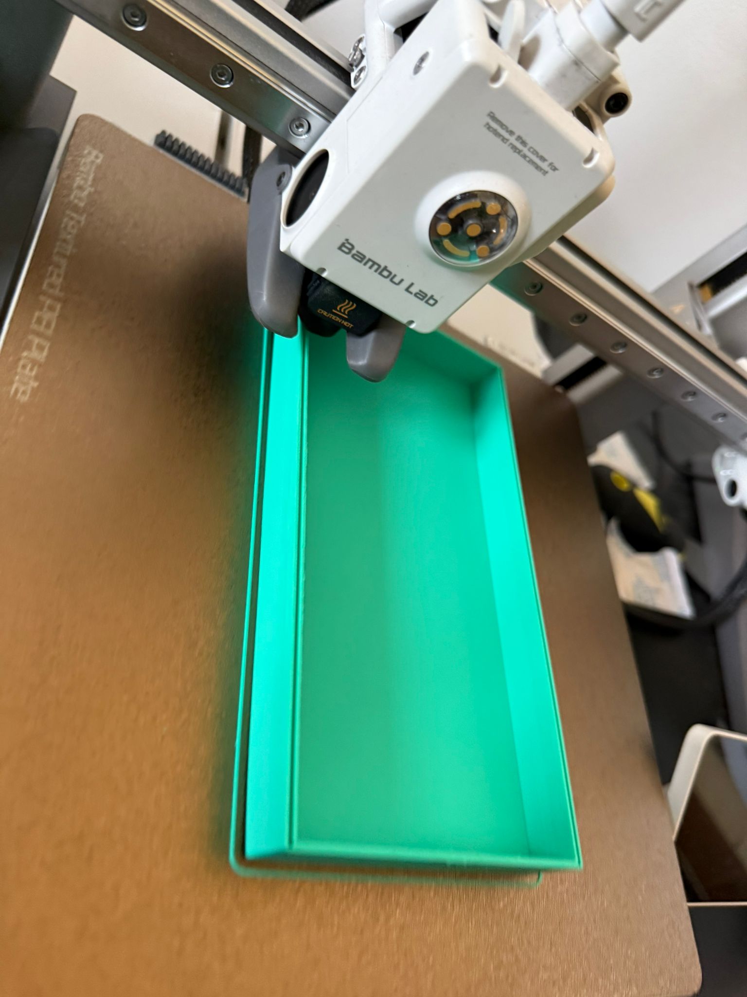

I’m going to try this:
Rotating the piece to see if the same wall is getting damaged.
Plate just washed.
And I’m going to use Brim:
I’m going to see what it does and then comment results.

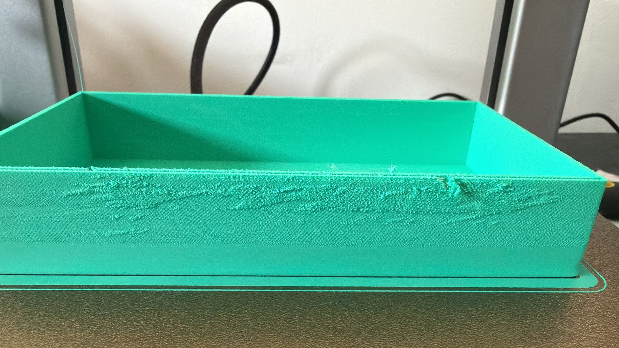

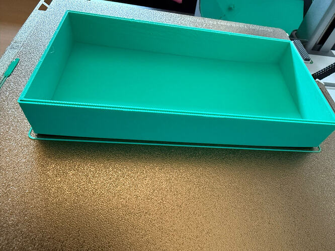

Oops, failed test! If you see the imgs, at certain layer heights it starts to rub the nozzle.
The other wall looks way better, and this time there is no warping, so warping is not the issue is causing this.
I feel super lost! I don’t know what could happen… something with the Z axis?
At every print I run the Auto Bed Leveling + Flow Dynamics Calibration…
Thanks a lot.
