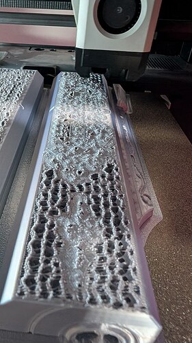

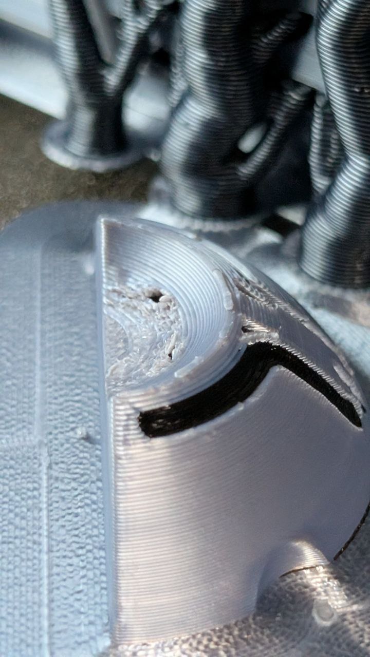

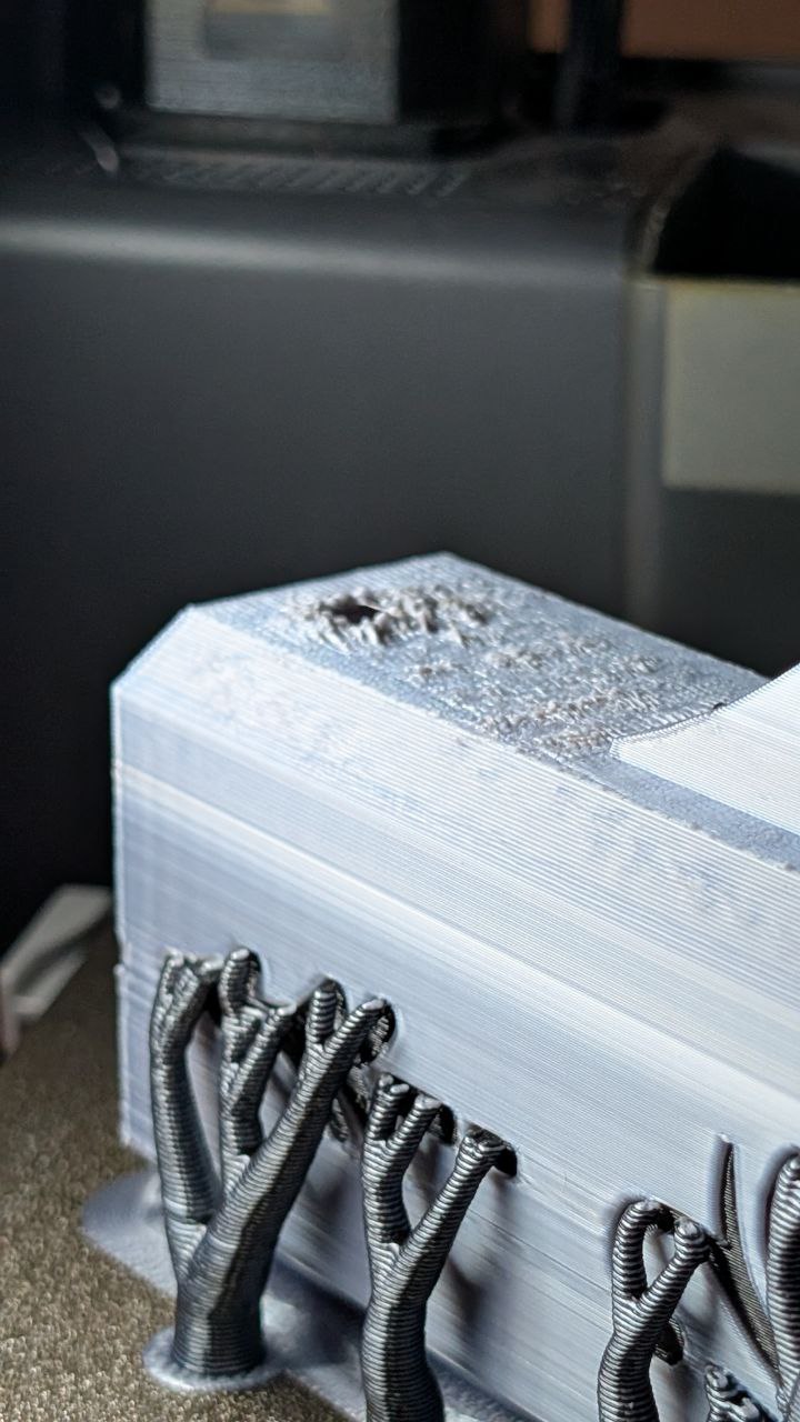

Hi Everyone,
Started having trouble with larger prints. The nozzle started scraping prints, especially infill, and I can’t understand why. This happens only at about 70%-80% of the prints, no issues with the first layer or during printing, but as soon as it hits’ 80% mark, it starts scraping.
Bambu P1P with AMS
0.4 nozzle
Sunlu Silver PLA filament
Things I’ve attempted that made things a bit better, but scraping persists:
  • Washed the textured PEI plate
  • Lowered speed
  • Raised nozzle temp
  • Recalibrated flow rate and dynamics
  • Enabled Z Hop and set it to Normal
  • Changed infill type to gyroid
Settings above helped prevent scraping at a much earlier stage, but now, no matter what I do, it starts scraping prints as soon as it hits 80% done.
Thanks in advance for any help/guidance!!
Try running a full bed leveling calibration and check that you aren’t accidentally using a different size nozzle than the one on the original profile
Thanks @Mprints really appreciate the help!
After multiple tests, calibrations, and settings tweaks, I found out the culprit is…..the filament lol. Sunlu Silver Silk PLA+ just refuses to work with me, no matter what I do. Can anyone recommend other brands of Silver PLA? :slight_smile:
I love any Esun filament, thanks to its price and quality
