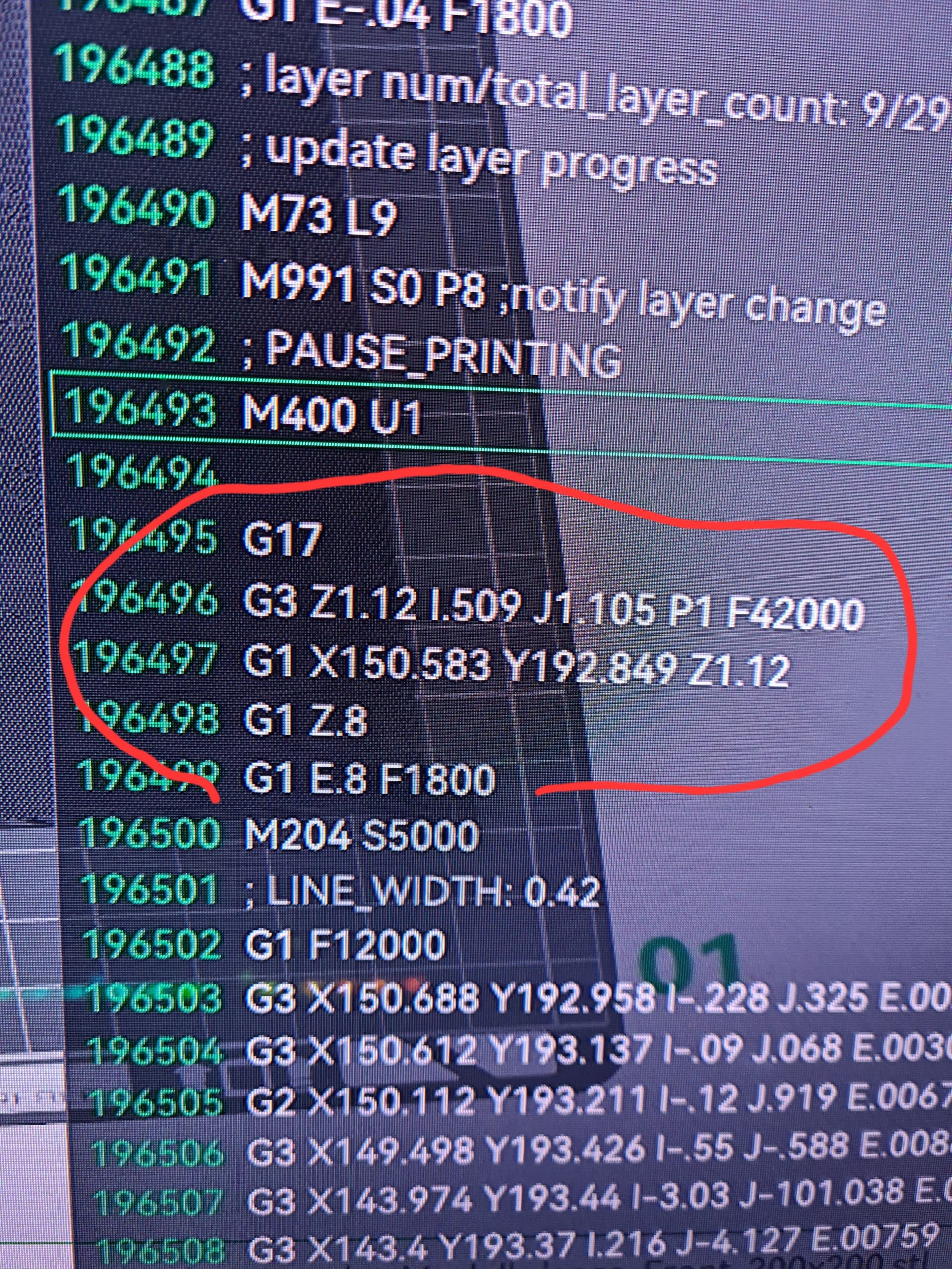

Hey Guys, im having an issue with my a1 i cant solve.
I use manual pause for color changes alot, and i noticed the nozzle always keeps touching the print somewhere randomly before the print resumes (but throughout a print its always the same spot)
I assume its for cleaning the nozzle but i dont want this as it leaves ugly wrong color spots in areas it doesnt belong. It has nothing to do with prime tower or w/e, its does this no matter if its on or off.
I found the part in the gcode, but neither does it render in the preview nor can it be selected. When prime tower is activated its between the pause command and the prime tower, but i dont know where this comes from or how to remove this.
Hopefully someone has an answer for this.
So for everyone interested in this issue, Bambulab now analyzed this case the last days, including doing testprints by me and sending them over etc, coming to the conclusion the printer is always resuming to the last printing position after a pause. Imo this is a bug, i was suggested to manually insert g1 commands before every pause. I hope they will fix this im not willing to manually edit every print…could aswell stayed with my sovol printers then o.O
