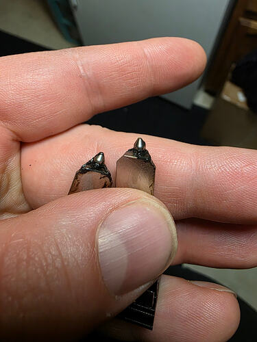

I think my two nozzles on my H2D might be leaking. I went to remove them today to swap on 0.6 and found them both stuck solid. I had to heat them up to get them out. Then I noticed ooze coming from what looks like where the tip meets the body. I’ve only printed PLA in the machine. It doesn’t look like typical ooze, especially because it was under the silicone boot and looked normal with the boots on. One looks worse because I started to clean it but then realized I should take some pics first.

Could it just be creeping inside the sock? Are you ironing any? I have seen pretty nasty nozzles after very long ABS prints. (I know you are doing PLA).
Once you clean them up can you look under magnification to see if there is a crack there or just a place where it settled during use?

I print a lot of abs and petg, I see that now and again under the sock. I just use a brass wire brush with the nozzle hot and gently scrub it clean. If it builds up it will affect prints at some point. Never noticed a crack or anything, just gets stuck there. If it sits to long it will almost turn into a glass looking consistency and its a pain to get off.

Remove sock, heat nozzle to 250° and clean with a brass brush. It’s just normal build-up

No ironing, also as you can see the tip itself is clean, the only residue is where the tip meets the body.
Unless maybe the nozzle wiper cleaned the tip but pushed it up into the sock?
That’s exactly what happens. The nozzle can’t “leak.”

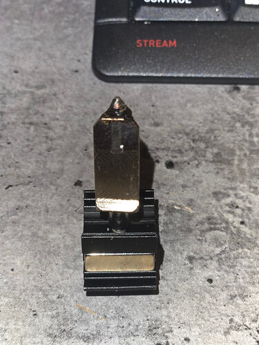

I began having issues with support for pla/petg not sticking to my prime tower or model (Support material is in the left nozzle of my H2C) so I watched the nozzle laying down the support interface and saw that it was dropping large blobs which, when cooled, were bumped into by the nozzle knocking off the support interface material. After replacing the left nozzle there were no issues. Here is what the problem nozzle looks like
I assume the tip is press fit into the hot end and started leaking at that juncture
That’s a possibility and I’ve had that happen before but I would only suspect this if, after cleaning the nozzle with a brush, it happens immediately afterwards. Otherwise, it’s just normal build-up.
Yeah, I just swapped another one in but will clean this one and see if it happens again
Looks like the nozzle wasn’t leaking, I cleaned it off and put it back on and it still didn’t work with the interface material but I did not see any leaks. I was hoping it was leaking because I’m struggling with my support for PLA/PETG clumping up and don’t know why it’s happening but evidently it’s not the nozzle
